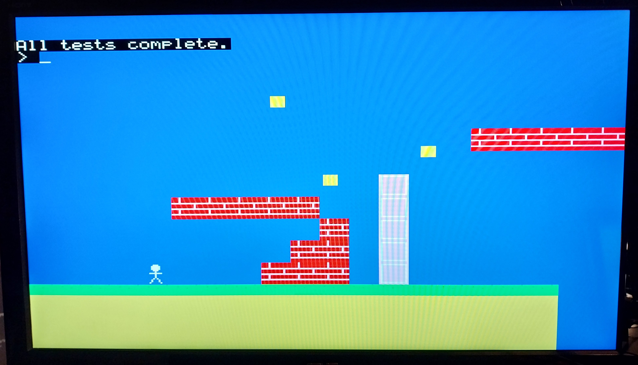

Posts: 12174
Posted: 07:41pm 09 Mar 2026
V6.02.01RC3
PicoMiteV6.02.01RC3.zip
All versions: Major rework of PLAY TONE and PLAY SOUND to reduce the overhead in the interrupt routine. Shouldn't make any difference to the user but.....
RP2350 only:
mm.info(psram size) - returns the amount of PSRAM in the system - static value
TILEMAP command and function implemented
TILEMAP_User_Manual.pdf
Test program - press any key between tests. In tests 17 and 18 move the man with the arrow keys. Should work on HDMI and VGA versions. Will need a framebuffer setting up and framebuffer copy to work on PicoMite (untested)
NB: the design test/goal for this code was "you could write a complete implementation of PacMan using this", not that I have done it though
' TILEMAP Test Program
' Tests all TILEMAP commands and functions.
' Generates a tileset procedurally and saves
' it as a BMP, then loads it into flash.
' Map data is defined in DATA statements.
' Requires: RGB121 framebuffer, SD card
OPTION EXPLICIT
OPTION BASE 0
MODE 2
CONST TILE_W = 16
CONST TILE_H = 16
CONST TILES_PER_ROW = 8
CONST MAP_COLS = 40         ' 40 x 20 = 640 x 320 pixel world
CONST MAP_ROWS = 20
CONST SCREEN_W = 320
CONST SCREEN_H = 240
' ---- Tile index constants ----
CONST T_EMPTY = 0
CONST T_GRASS = 1
CONST T_BRICK = 2
CONST T_STONE = 3
CONST T_COIN  = 4
CONST T_SKY   = 5
CONST T_DIRT  = 6
CONST T_FIGURE = 7
CONST T_ENEMY  = 8
' ---- Attribute bit constants ----
CONST A_SOLID   = &b0001
CONST A_COLLECT = &b0010
' ---- RGB121 colours ----
CONST C_BLACK   = RGB(0,0,0)
CONST C_GREEN   = RGB(0,255,0)
CONST C_BROWN   = RGB(255,255,0)
CONST C_RED     = RGB(255,0,0)
CONST C_YELLOW  = RGB(255,255,0)
CONST C_COBALT  = RGB(0,0,255)
CONST C_GREY    = RGB(128,128,128)
CONST C_WHITE   = RGB(255,255,255)
CONST C_MYRTLE  = RGB(0,128,0)
' TEST 1: Generate tileset BMP
PRINT "Test 1: Generating tileset BMP..."
GenerateTileset
PRINT "  PASS: tileset.bmp created"
' TEST 2: Load tileset into flash
PRINT "Test 2: Loading tileset into flash..."
FLASH LOAD IMAGE 1, "tileset.bmp",O
PRINT "  PASS: Flash slot 1 loaded"
' TEST 3: Create tilemap from DATA
PRINT "Test 3: Creating tilemap from DATA..."
TILEMAP CREATE mapdata, 1, 1, TILE_W, TILE_H, TILES_PER_ROW, MAP_COLS, MAP_ROWS
PRINT "  PASS: Tilemap 1 created"
' TEST 4: Query map dimensions
PRINT "Test 4: Querying dimensions..."
IF TILEMAP(COLS 1) <> MAP_COLS THEN
 PRINT "  FAIL: COLS = "; TILEMAP(COLS 1); " expected "; MAP_COLS
ELSE
 PRINT "  PASS: COLS = "; TILEMAP(COLS 1)
END IF
IF TILEMAP(ROWS 1) <> MAP_ROWS THEN
 PRINT "  FAIL: ROWS = "; TILEMAP(ROWS 1); " expected "; MAP_ROWS
ELSE
 PRINT "  PASS: ROWS = "; TILEMAP(ROWS 1)
END IF
' TEST 5: TILEMAP TILE query
PRINT "Test 5: TILE query..."
DIM t
t = TILEMAP(TILE 1, 8, 12 * TILE_H + 4)
IF t <> T_GRASS THEN
 PRINT "  FAIL: Expected T_GRASS("; T_GRASS; ") got "; t
ELSE
 PRINT "  PASS: TILE at ground = "; t
END IF
' Empty space
t = TILEMAP(TILE 1, 8, 2 * TILE_H + 4)
IF t <> T_EMPTY THEN
 PRINT "  FAIL: Expected T_EMPTY(0) got "; t
ELSE
 PRINT "  PASS: TILE at sky = "; t; " (empty)"
END IF
' TEST 6: TILEMAP SET
PRINT "Test 6: TILEMAP SET..."
TILEMAP SET 1, 5, 5, T_COIN
t = TILEMAP(TILE 1, 5 * TILE_W + 1, 5 * TILE_H + 1)
IF t <> T_COIN THEN
 PRINT "  FAIL: SET/TILE mismatch: got "; t
ELSE
 PRINT "  PASS: SET then TILE = "; t
END IF
' Clear it back
TILEMAP SET 1, 5, 5, T_EMPTY
' TEST 7: TILEMAP COLLISION (no mask)
PRINT "Test 7: COLLISION detection..."
DIM hit
hit = TILEMAP(COLLISION 1, 32, 12 * TILE_H - 4, 14, 8)
IF hit <> T_GRASS THEN
 PRINT "  FAIL: Expected T_GRASS collision, got "; hit
ELSE
 PRINT "  PASS: Ground collision = "; hit
END IF
' Test no collision in empty space
hit = TILEMAP(COLLISION 1, 32, 2 * TILE_H, 14, 8)
IF hit <> 0 THEN
 PRINT "  FAIL: Expected no collision, got "; hit
ELSE
 PRINT "  PASS: Empty space collision = 0"
END IF
' TEST 8: TILEMAP ATTR and attribute queries
PRINT "Test 8: TILEMAP ATTR..."
TILEMAP ATTR tileattrs, 1, 6
' Check attributes
DIM a
a = TILEMAP(ATTR 1, T_GRASS)
IF (a AND A_SOLID) = 0 THEN
 PRINT "  FAIL: Grass should be solid"
ELSE
 PRINT "  PASS: Grass attr = "; a; " (solid)"
END IF
a = TILEMAP(ATTR 1, T_COIN)
IF (a AND A_COLLECT) = 0 THEN
 PRINT "  FAIL: Coin should be collectible"
ELSE
 PRINT "  PASS: Coin attr = "; a; " (collectible)"
END IF
' TEST 9: COLLISION with attribute mask
PRINT "Test 9: COLLISION with mask..."
' Coin at (7,7) - test collision with COLLECT mask
hit = TILEMAP(COLLISION 1, 7 * TILE_W, 7 * TILE_H, 14, 14, A_COLLECT)
IF hit <> T_COIN THEN
 PRINT "  FAIL: Expected coin collision, got "; hit
ELSE
 PRINT "  PASS: Collectible collision = "; hit
END IF
' Same area with SOLID mask should miss the coin
hit = TILEMAP(COLLISION 1, 7 * TILE_W, 7 * TILE_H, 14, 14, A_SOLID)
IF hit <> 0 THEN
 PRINT "  FAIL: Expected no solid collision at coin, got "; hit
ELSE
 PRINT "  PASS: Solid collision at coin = 0 (correct)"
END IF
' TEST 10: TILEMAP VIEW and viewport queries
PRINT "Test 10: VIEW command..."
TILEMAP VIEW 1, 100, 50
IF TILEMAP(VIEWX 1) <> 100 OR TILEMAP(VIEWY 1) <> 50 THEN
 PRINT "  FAIL: VIEW position wrong"
ELSE
 PRINT "  PASS: VIEWX="; TILEMAP(VIEWX 1); " VIEWY="; TILEMAP(VIEWY 1)
END IF
' TEST 11: TILEMAP DRAW (visual)
PRINT "Test 11: Drawing tilemap at origin..."
FRAMEBUFFER CREATE
FRAMEBUFFER WRITE F
CLS C_COBALT
TILEMAP DRAW 1, F, 0, 0, 0, 0, SCREEN_W, SCREEN_H
FRAMEBUFFER COPY F, N
DO: LOOP UNTIL INKEY$<>""
PRINT "  PASS: Tilemap rendered (check display)"
' TEST 12: Smooth scrolling demo
PRINT "Test 12: Smooth scroll demo (5 seconds)..."
DIM camX, camY, startTime, maxX, maxY
camX = 0 : camY = 0
startTime = TIMER
maxX = MAP_COLS * TILE_W - SCREEN_W
maxY = MAP_ROWS * TILE_H - SCREEN_H
DO WHILE TIMER - startTime < 5000
 FRAMEBUFFER WRITE F
 CLS C_COBALT
 TILEMAP DRAW 1, F, camX, camY, 0, 0, SCREEN_W, SCREEN_H
 LINE SCREEN_W\2 - 4, SCREEN_H\2, SCREEN_W\2 + 4, SCREEN_H\2, 1, C_WHITE
 LINE SCREEN_W\2, SCREEN_H\2 - 4, SCREEN_W\2, SCREEN_H\2 + 4, 1, C_WHITE
 camX = camX + 1
 camY = camY + 1
 IF camX > maxX THEN camX = maxX
 IF camY > maxY THEN camY = maxY
LOOP
PRINT "  PASS: Scroll demo complete"
' TEST 13: TILEMAP SCROLL command
PRINT "Test 13: SCROLL command..."
TILEMAP VIEW 1, 0, 0
TILEMAP SCROLL 1, 50, 30
IF TILEMAP(VIEWX 1) <> 50 OR TILEMAP(VIEWY 1) <> 30 THEN
 PRINT "  FAIL: SCROLL position wrong"
ELSE
 PRINT "  PASS: After SCROLL: VIEWX="; TILEMAP(VIEWX 1); " VIEWY="; TILEMAP(VIEWY 1)
END IF
TILEMAP SCROLL 1, -100, -100
IF TILEMAP(VIEWX 1) <> 0 OR TILEMAP(VIEWY 1) <> 0 THEN
 PRINT "  FAIL: SCROLL underflow clamp failed"
ELSE
 PRINT "  PASS: SCROLL clamps at 0,0"
END IF
' TEST 14: Transparency test
PRINT "Test 14: Transparency rendering..."
FRAMEBUFFER WRITE F
CLS C_RED
TILEMAP DRAW 1, F, 0, 0, 0, 0, SCREEN_W, SCREEN_H, 0
PRINT "  PASS: Transparency rendered (black pixels show red background)"
' TEST 15: Coin collection demo
PRINT "Test 15: Coin collection demo..."
FRAMEBUFFER WRITE F
CLS C_COBALT
PAUSE 500
DIM coin_col%(4) = (7, 17, 19, 27, 28)
DIM coin_row%(4) = (7,  4,  4,  6,  6)
DIM i
FOR i = 0 TO 4
 PAUSE 800
 TILEMAP SET 1, coin_col%(i), coin_row%(i), T_EMPTY
 FRAMEBUFFER WRITE F
 CLS C_COBALT
NEXT i
PRINT "  PASS: All 5 coins collected"
' TEST 16: Multiple tilemaps (second map from DATA)
PRINT "Test 16: Second tilemap from DATA..."
TILEMAP CREATE map2data, 2, 1, TILE_W, TILE_H, TILES_PER_ROW, 20, 10
IF TILEMAP(COLS 2) = 20 AND TILEMAP(ROWS 2) = 10 THEN
 PRINT "  PASS: Tilemap 2 created (20x10)"
ELSE
 PRINT "  FAIL: Tilemap 2 dimensions wrong"
END IF
TILEMAP DESTROY 2
PRINT "  PASS: Tilemap 2 destroyed"
' TEST 17: Figure overlay scrolling over base map
PRINT "Test 17: Figure overlay demo (arrow keys, Q=quit)..."
' Create a 1x1 overlay containing just the figure tile
TILEMAP CREATE figmap, 2, 1, TILE_W, TILE_H, TILES_PER_ROW, 1, 1
DIM fx, fy, k$
fx = SCREEN_W \ 2 - TILE_W \ 2  ' pixel position on screen
fy = SCREEN_H \ 2 - TILE_H \ 2
camX = 0
DO
 ' Draw base map scrolling, then figure on top with transparency
 FRAMEBUFFER WRITE F
 CLS C_COBALT
 TILEMAP DRAW 1, F, camX, 0, 0, 0, SCREEN_W, SCREEN_H
 TILEMAP DRAW 2, F, 0, 0, fx, fy, TILE_W, TILE_H, 0
 k$ = INKEY$
 IF k$ = CHR$(128) AND fy > 0 THEN fy = fy - 2
 IF k$ = CHR$(129) AND fy < SCREEN_H - TILE_H THEN fy = fy + 2
 IF k$ = CHR$(130) AND fx > 0 THEN fx = fx - 2
 IF k$ = CHR$(131) AND fx < SCREEN_W - TILE_W THEN fx = fx + 2
 ' Scroll the base map slowly
 camX = camX + 1
 IF camX > MAP_COLS * TILE_W - SCREEN_W THEN camX = 0
LOOP UNTIL UCASE$(k$) = "Q"
TILEMAP DESTROY 2
PRINT "  PASS: Figure overlay demo complete"
' TEST 18: Sprite system - hero + enemies
PRINT "Test 18: Sprite demo (arrows move, Q=quit)..."
' Hero = sprite 1 (figure tile 7), 3 enemies = sprites 2-4 (coin tile 4)
TILEMAP SPRITE CREATE 1, 1, T_FIGURE, SCREEN_W\2, SCREEN_H\2 - 32
TILEMAP SPRITE CREATE 2, 1, T_ENEMY, 40, 40
TILEMAP SPRITE CREATE 3, 1, T_ENEMY, 200, 60
TILEMAP SPRITE CREATE 4, 1, T_ENEMY, 120, 100
' Query functions
PRINT "  Sprite 1 X="; TILEMAP(SPRITE X 1); " Y="; TILEMAP(SPRITE Y 1)
PRINT "  Sprite 1 tile="; TILEMAP(SPRITE TILE 1)
PRINT "  Sprite 1 W="; TILEMAP(SPRITE W 1); " H="; TILEMAP(SPRITE H 1)
' Enemy movement directions
DIM dx(4), dy(4), anim_frame
dx(2) = 1 : dy(2) = 1
dx(3) = -1 : dy(3) = 1
dx(4) = 1 : dy(4) = -1
anim_frame = 0
DIM hx, hy, ex, ey
hx = TILEMAP(SPRITE X 1)
hy = TILEMAP(SPRITE Y 1)
DO
 FRAMEBUFFER WRITE F
 CLS C_COBALT
 ' Draw the base tilemap
 ' Draw all sprites on top with transparency (colour 0 = black)
 TILEMAP SPRITE DRAW F, 0
 k$ = INKEY$
 IF k$ = CHR$(128) AND hy > 0 THEN
   IF TILEMAP(COLLISION 1, hx, hy - 2, TILE_W, TILE_H, A_SOLID) = 0 THEN hy = hy - 2
 END IF
 IF k$ = CHR$(129) AND hy < SCREEN_H - TILE_H THEN
   IF TILEMAP(COLLISION 1, hx, hy + 2, TILE_W, TILE_H, A_SOLID) = 0 THEN hy = hy + 2
 END IF
 IF k$ = CHR$(130) AND hx > 0 THEN
   IF TILEMAP(COLLISION 1, hx - 2, hy, TILE_W, TILE_H, A_SOLID) = 0 THEN hx = hx - 2
 END IF
 IF k$ = CHR$(131) AND hx < SCREEN_W - TILE_W THEN
   IF TILEMAP(COLLISION 1, hx + 2, hy, TILE_W, TILE_H, A_SOLID) = 0 THEN hx = hx + 2
 END IF
 TILEMAP SPRITE MOVE 1, hx, hy
 ' Bounce enemies off screen edges
 FOR i = 2 TO 4
   ex = TILEMAP(SPRITE X i) + dx(i)
   ey = TILEMAP(SPRITE Y i) + dy(i)
   IF ex <= 0 OR ex >= SCREEN_W - TILE_W THEN dx(i) = -dx(i) : ex = ex + dx(i) * 2
   IF ey <= 0 OR ey >= SCREEN_H - TILE_H THEN dy(i) = -dy(i) : ey = ey + dy(i) * 2
   TILEMAP SPRITE MOVE i, ex, ey
   ' Check collision with hero
   IF TILEMAP(SPRITE HIT 1, i) THEN
     PRINT "  HIT: Sprite 1 collided with sprite "; i
   END IF
 NEXT i
 ' Animate enemies: toggle tile between coin(4) and brick(2) every 30 frames
 anim_frame = anim_frame + 1
 IF anim_frame MOD 30 = 0 THEN
   FOR i = 2 TO 4
     IF TILEMAP(SPRITE TILE i) = T_ENEMY THEN
       TILEMAP SPRITE SET i, T_COIN
     ELSE
       TILEMAP SPRITE SET i, T_ENEMY
     END IF
   NEXT i
 END IF
TILEMAP SPRITE DESTROY 1
TILEMAP SPRITE DESTROY 2
TILEMAP SPRITE DESTROY 3
TILEMAP SPRITE DESTROY 4
PRINT "  PASS: Sprite demo complete"

Posted: 03:12am 10 Mar 2026
Tested the TILEMAP Test Program:
> option list
PicoMiteHDMI MMBasic USB RP2350A Edition V6.02.01RC3
OPTION SYSTEM I2C GP10,GP11
OPTION FLASH SIZE 4194304
OPTION COLOURCODE ON
OPTION MOUSE SENSITIVITY     1.0000
OPTION KEYBOARD US
OPTION RESOLUTION 640x480 @ 252000KHz
OPTION SDCARD GP5, GP6, GP4, GP3
OPTION RTC AUTO ENABLE
/Peter63
