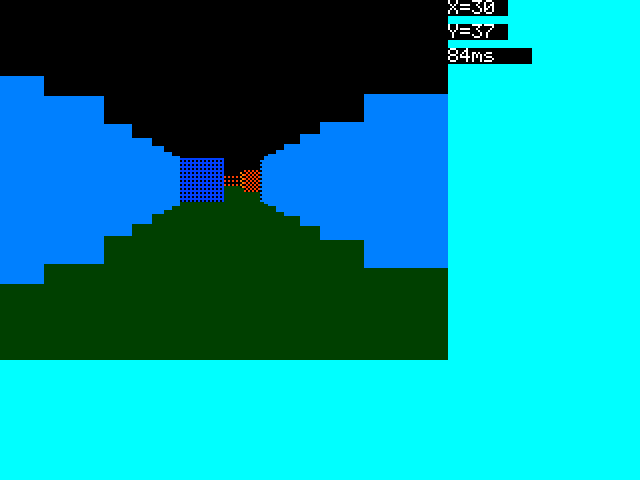

' Raycaster 2 in MMBasic, DDA method (Digital Differential Analyser)
'V0.87.. added Lookuptables,changed to Blit vs Box,compressed math
'added possible dithering,compressed math more, changed map to 1D Array
'By Martin H. for https://www.thebackshed.com
'The software is subject to the terms of the GNU General Public Licence (GPL)
'and may be freely used, copied and updated.
'Individuals are encouraged to freely use and modify the software.
'Start
Dim integer dither%=1,mmb4w
'add CMM2 here
If MM.DEVICE$ = "MMBasic for Windows" Then MMB4W = 1
CLS
If mmb4w Then
  MODE -7 :CLS RGB(cyan)
PAGE WRITE 1
Else
  MODE 2: CLS RGB(cyan)
  FRAMEBUFFER create:FRAMEBUFFER write f
End If
CLS
'Pre-calculate complex things where possible and create lookup tables.
Dim integer angleIndex = 0 ' direction of view
Dim integer rotStep = 6,lh,ys
Dim integer stepX,stepY,x
'sin / cos LookUpTable
Const LUTSIZE=360,MULT=128
Dim integer sinLUT(LUTSIZE), cosLUT(LUTSIZE)
For i = 0 To LUTSIZE - 1
  angle = i * (2 * Pi / LUTSIZE)
  sinLUT(i) = Int(Sin(angle)*MULT)
  cosLUT(i) = Int(Cos(angle)*MULT)
Next
' --- Color scheme Definition ---
Dim integer Col(3,2)
Col(1,0)=RGB(green):Col(1,1)=RGB(0,170,0)
Col(2,0)=RGB(0,170,255):Col(2,1)=RGB(0,85,255)
Col(3,0)=RGB(255,170,0):Col(3,1)=RGB(255,85,0)
Dim integer colSky = RGB(0,0,0),colFloor = RGB(0,85,0)
' --- Labyrinth Definition ---
mapS=64:mapy=24:mapx=24
Dim integer mapW = 64,mapH = 51
Dim integer m(mapW*mapH),mx,my
Restore MapData1
Dim k$ length 64
For y = 0 To mapH-1 :Read k$:Inc k$,"1"
 For x=0 To Len(k$):m(x + (y << 6))=Val(Mid$(k$,x+1,1)):Next
Next
' --- Player Setup ---
Dim px = 26.5,py = 45.5,dx = 1, dy = 0.5
Dim planeX = 0,planeY = 0.66
moveSpeed = 0.3
rotSpeed = 0.1
' --- Grafic Setup ---
Dim integer resStep = 2 'Resolution
Dim integer scrW = MM.HRES-96
Dim integer scrH = MM.VRES*.75
precalc_shading  'precalculate the Dithering
Dim integer needsRedraw = 1 ' Flag to force the first frame
Dim invScrW = 2 / scrW
Dim integer halfScrH = scrH / 2
Dim integer lw=Int((resStep+1)/2)
'main
' Only paint when something has changed
If needsRedraw Then
dx = cosLUT(angleIndex)/MULT
dy = sinLUT(angleIndex)/MULT
planeX = -dy * 0.66
planeY =  dx * 0.66
tt=Timer
  ' Ceiling and floor
  Box 0, 0, scrW, halfScrH, ,colSky, colSky
  Box 0, halfScrH, scrW, halfScrH, , colFloor, colFloor
'DDAA cast field of view
  For x = 0 To scrW -1 Step resStep
    cameraX = x * invScrW - 1
    rayDx =dx + planeX * cameraX
    rayDy = dy + planeY * cameraX
   mx = Int(px) : my = Int(py)
   dDx = Abs(1 / (rayDx+.001))
   dDy = Abs(1 / (rayDy+.001))
  If rayDx < 0 Then
    stepX=-1:sdX=(px - mx)*dDx
  Else
    stepX=1:sdX=(mx+1-px)*dDx
  End If
  If rayDy < 0 Then
      stepY=-1: sdY = (py - my) * dDy
  Else
      stepY=1 : sdY = (my + 1 - py) * dDy
  End If
   indx% = (my<<6) + mx
   yStepOffset% = stepY << 6
    'cast one Ray
   Do While Not m(indx%)
     If sdX < sdY Then
       Inc sdX, dDx: Inc indx%,stepX :side = 0
     Else
       Inc sdY, dDy: Inc indx%, yStepOffset% : side = 1
     End If
   Loop
    pDist=Max(0.1,(sdX - dDx)*Not side+(sdY-dDy)*side)
    lH = scrH / pDist
    shade = Min(Int(pDist>>3)*24,72)*dither%
Blit shade+scrw-8+8*m(indx%)+4*side,0,x,Max(0,halfScrH-(lH>>1)),resStep,Min(lH,scrH)
  Next x
  If mmb4w Then
    PAGE WRITE 0:Blit 0,0,0,0,scrW,scrH,1
    Text scrW,0,"X="+Str$(Int(px))+" "
   Text scrW,12,"Y="+Str$(Int(py))+" "
   Text scrW,24,Str$(Timer-tt)+"   ":tt=Timer
   PAGE WRITE 1
  Else
   FRAMEBUFFER write n
   FRAMEBUFFER write f
   Blit framebuffer F,N,0,0,0,0,scrW,scrH
  End If
  needsRedraw = 0 ' Reset Redraw Flag
End If

accelerated once again by ~5 ms.

Hello Martin,
with the ILI9341 standard driver I get timer values between 40 and 60.
With the buffered driver it seems to be even faster, but I can't see the numbers.
In both cases the "Mode 2" needs to be removed, but with the buffered driver
doesn't work.
I replaced it with
framebuffer copy f,n
what does not give a complete correct screen, but the maze is fine and super fast. Maybe one for @matherp

Thanks for the feedback. I'm now nearing the end of my development and optimisation process. As far as I remember, we managed to get F to N Blitting working on LCD with Petscii robots..
What I'd still like to insert, before the version jump to 1.0 is the rhythmic swaying (‘view bobbing’) when running, as seen in Doom.
But not today ;-)

Another data point for you, I have tried out your latest DDA program from above on 480x320 LCD ST7796S, 2350 running at 420MHz.
All I had to do was remove the Mode 2, everything then just worked, full screen.
At this resolution I'm getting around 60 to 76mS per frame, If I limit the screen size to 320x240 (using Poke Display Hres 320 & Poke Display Vres 240) I'm seeing an update rate of about 30 to 45mS per frame. Not Bad! :-)
If I limit the CPU to 252MHz I get around 90 to 130mS and 50 to 75mS respectivly.
Regards Kevin.
PS. I've never tried "converting IF queries into mathematical functions" before, but I've now done it in a couple of pieces of code and mostly it made them faster :-) Thanks for the tip.

If you go back to the original code, just removing the Mode 2, then modify the main Blit
Blit framebuffer f,n,0,0,0,0,scrW,scrH
to
Blit framebuffer f,n,0,200,0,0,scrW,scrH
You can see some detail in the single line, so it looks like the blit is only copying a single line, not the whole height of the frame, ie scrH.
Regards, Kevin.
Edited 2026-02-28 04:33 by Bleep
dddns
Joined: 20/09/2024
Posts: 925
Posted: 06:45pm 27 Feb 2026
If I replace with
the maze is correct
