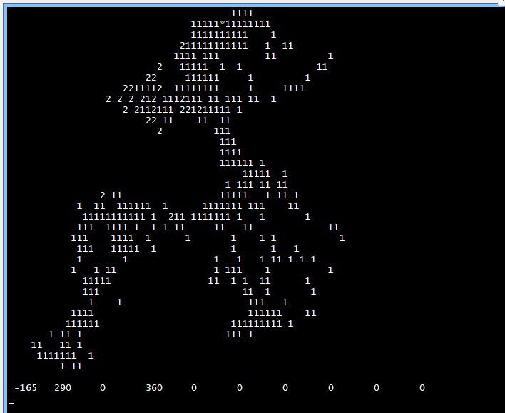

A sample readout after we wandered about the house this morning.
It looks like a Poodle!
The radar goes through walls better that I had expected but I will set it up in a better location and use a Webmite + Telnet.

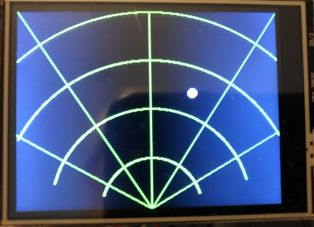

Hi Gerald! I've drawn a radar grid for it. Works perfectly.
Best wishes! Joachim

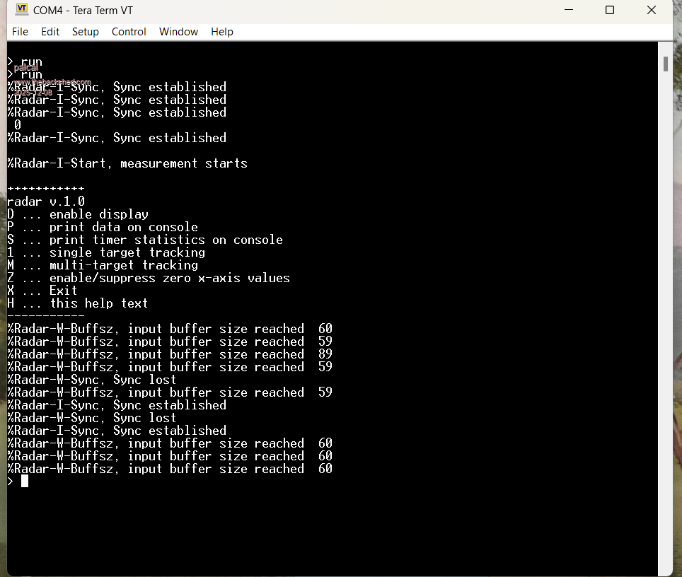

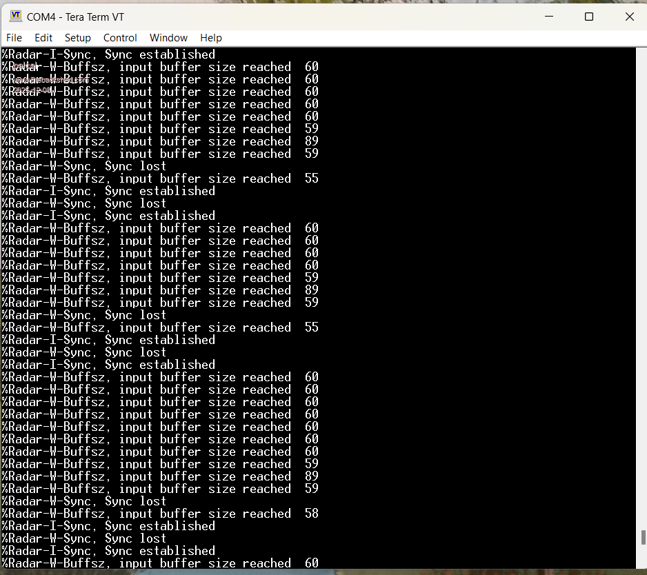

It is working, the dot moves but not like it should, it just wanders slightly around the zero position on the display.
Here are a couple of screen shots
When sitting infront of it the dot hovers around the zero mark, when I move to a position about 3 metres away the dot moves down about 2 lines on the grid, ie about half way, but only down the left hand side.
It keeps losing sync. I don't know what that means.
Edited 2025-12-08 16:05 by palcal

  Quote  It keeps losing sync. I don't know what that means.
My guess is its Tx baud rate is different to your RX baud rate. With a MicroMite connected to TeraTerm at the wrong baud rate you can get random characters on the screen and it looks like your program is getting that.
  Quote  If you connect the sensor to a serial-to-USB adapter and supply it with 5V you should see data coming with 256000 baud.
Use TeraTerm and experiment with different baud rates until the data looks sensible then adjust the program to use that baud rate.

sync lost means that the expected header chars are not received and the app waits for them to come by again. Seems like there are characters lost from the serial line. The serial line itself seems to be setup properly and the senor deliveres data, otherwise you would not get sync lost/sync established messages. If the range-sensitivity is too low, you can use a different scaling factor for calibration. I've set it up for 6 meters for full display, but it seems that the distance readout from the sensor is not very accurate as I measured 3 meters in y-axis distance as being about 1/4 of the display distance only. Didn't dig deeper as I think this can be calibrated out.
The lost chars may be because of too low cpu speed or too much time consumed for other code like display update. I've run that on a pico2 RP2450 with 300 Mhz and didn't lose chars except when switching from single to multi-target mode. Could be that the display thakes too much time for drawing the lines/ball. Had a SPI display with standard driver. so nothing really fast....
If I find some time theses days I can try to run that on a pico 1 with low cpu speed and see what the behavior is.
Edit: scaling factors are calculated in lines 103/104, the divisor is the maximum length in mm.

I'm getting these error messages too. I think it's actually related to the image rendering. I didn't pay much attention to it because the display still worked. I'll try it at 300 MHz today. And please note: I was using Gerald's version 2.1.

try to comment out line 315 (radar_net) just to see if this cures the sync issue. If so, there is too much cputime spent in drawing the grid. Maybe you then could try to use layers, one for the grid and one for the ball(s). This also applies to V2.1.
As I already wrote, V2.1 uses even more cpu, as all the definitions for the header/trailer and data items are dynamic and also trailers are checked. So, yes, it may be a bit overengineered for this purpose .... but Jims very slick approach could be a good basis for low cpu usage.

The distance between arcs is approximately 2 meters with these settings:
const v_fact = mm.vres/8000
const h_fact = mm.hres/6200
At least, that's what my tests showed.
Attempts with GUI SETUP and GUI PAGE didn't yield good results. While it works, the lines are deleted from the radar point. Now I need to look into the LAYERS issue.
