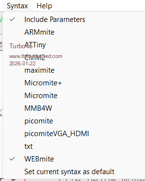

Another couple of problems:
DOS is not a choice anymore?

Posted: 03:30am 22 Jan 2026
DOS should definitely be in the list.
During the last update, some TKN files were scrapped (renamed to TKO)
I can't see how it would happen, but perhaps doing your changes caused MMEdit to reject the DOS.tkn file.
Did you have it open in a text editor when MMEdit started?
Either way, I have been redoing some of the files and have finished the DOS.tkn so here it is
DOS.zip
With MMEdit shut down, unzip it into your data folder.
MMEdit will scan the data folder next start and add any .tkn files it finds (including the new DOS.tkn file).
There were a lot of keywords that should not have been in the DOS list. I hope I haven't lost any in the process.

Turbo46
Joined: 24/12/2017
Posts: 1694
Posted: 04:02am 22 Jan 2026
Haha
I knew it must have been something stupid I had done. When I edited the DOS.tkn file in Notepad it saved it as DOS.tkn.txt and I didn't notice that then nor that the DOS option wasn't there.
I corrected the filename and Voila! it was back to normal
Having said that I'm not really sure how it happened because the changes did work after I made them. Maybe I did have the file open in Notepad and it automatically saved the .tkn as a .txt file when I closed it?
Anyway I have replaced it with your DOS.tkn file and all is good now.
