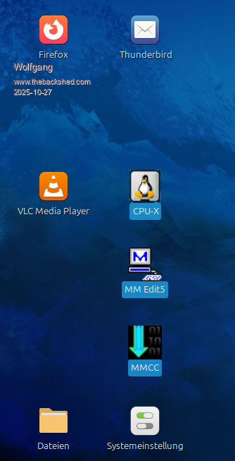

basically I wanted to say goodbye to Windows and have made MMedit accessible on Linux Mint with an icon from the desktop.

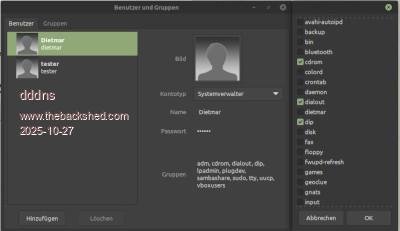

The Qt libraries are essential. The above command must execute without error.
And in order to be able to connect to a PicoMite your username must be in the group "Dialout".
Go to "users and groups" in your system management folder and add your username to Dialout:
Edited 2025-10-27 07:50 by dddns

Based on your excellent explanations concerning the MMedit background, I will now try MMedit with mmedit5_20.4.tar.gz, as I am having problems with the serial port using MMedit under Wine. The last was not my intention, and I didn't know that before.
