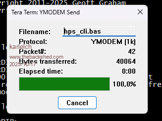

Hi Peter,
including YMODEM is a great idea!
I tested it today but discovered a bug. I nuked the Pico 2 (2350A) and installed the latest default firmware (RC3, no options set). Then I entered
ymodem receive
and in TeraTerm (v5.2; Windows 11) I started file/transfer/ymodem/send and selected a file on my PC. TeraTerm indicated a transfer but then it stopped at 100% and nothing happens.
After a while, the dialog closes, the Pico remains responsive, but the file is not on the Pico.
The coding in TeraTerm is English/ISO8859-1. I tried UFT-8 but this also did not work (less even, as there was no progress in the file transfer).
ymodem send
is also not working.
> option list
PicoMite MMBasic RP2350A V6.01.00RC3
OPTION FLASH SIZE 4194304
OPTION COLOURCODE ON
OPTION CPUSPEED (KHz) 150000
Any advice?

  matherp said  V6.01.00RC4
PicoMiteV6.01.00RC4.zip
Should fix the various issues raised above.
NB: YMODEM now requires a cpu speed of 200,000KHz or above
Thanks, Peter!
I have cannot test YMODEM thoroughly right now, but one observation: The following code transfers the file (using TeraTerm) but hangs in the dialog at 100% for a while until it closes. The Pico is responsive but the ">" appears only after the next command. Same result with higher CPU speeds.
> option list
PicoMite MMBasic RP2350A V6.01.00RC4
OPTION CPUSPEED (KHz) 200000
> ymodem receive "hps_cli.bas"
> files
A:/
  <DIR>  .
  <DIR>  ..
00:00 01-01-2024          4  bootcount
00:00 01-01-2024      40064  hps_cli.bas
2 directories, 2 files, 1929216 bytes free
YMODEM SEND "filename" works flawlessly.
A quick test of XMODEM suggests that it works.
Best
Thomas
Edited 2025-10-21 06:08 by karlelch
