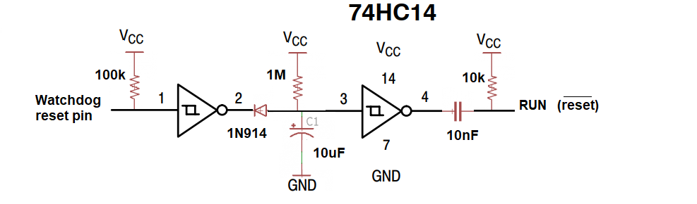

Re the external watchdog, if you need to save the current of 2 x NE555s (or 556) a pair of CMOS hex Schmidt inverter gates can do a similar job for less cost than the 7555 version.
Tomorrow I will have time to test it on a Pico if you are interested.

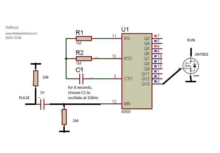

P.S. I actually like the ON ERROR GOTO more, since it also gives you the opportunity to repair the error in a less intrusive way, like RUN... without breaking the USB
connection.
P.P.S. 555 circuit need minimal 4.5V. Not sure they work at 3.3V. That is why the applications show Arduino (5V) solutions. This may (if you can get an old CD4060, although I think R1 needs to be 1k).

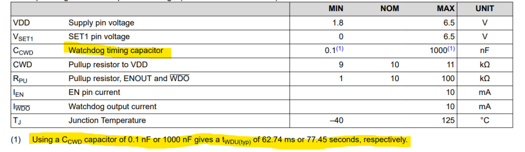

TPS3431: 10µA
tps3431.pdf

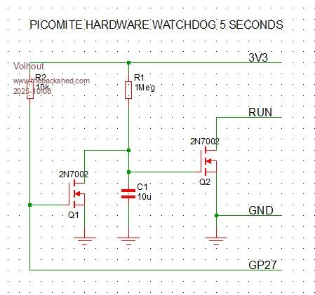

Analog design....
It won't get any simpler than this one.....
You enable the watchdog with
SETPIN GP27,DOUT
PIN(GP27)=0
You tickle the watchdog with
PULSE GP27,10 '10ms pulse
When the time is too short or long, change the 10uF capacitor.
The 10k resistor R2 is chosen so even with the bug in the RP2350 IO pins there is always a pullup on the GPxx pin (GP27 in this case). For the RP2040 (the zero) a 1 meg resistor R2 will be sufficient, lowering the current draw significant.

Posts: 9328
Posted: 01:02pm 08 Oct 2025
Oh, that's excellent! It could be tiny using SMD too.
Posts: 6253
Posted: 01:45pm 08 Oct 2025
Mick,
It could even fit on a small PCB withing the pins of a zero.
The good thing is that you need actively enable the watchdog by setting a GP pin to DOUT. So it won't accidentally kick in.
Posts: 9328
Posted: 01:55pm 08 Oct 2025
That's one of the things I really like about it. The Pico always has time to boot and the program set up before the watchdog is enabled.
Posts: 3429
Posted: 08:42pm 08 Oct 2025
If you replace the MOSFETs with 74HC14 Schmidt inverters Volhout's circuit is almost the same as the one that I was thinking of.
The only difference is an input capacitor (used in previous designs in this thread).
Without it if the Pico freezes during the pulse the DOUT will stay high preventing the RC from timing out.
With it the pulse duration is limited, allowing the RC to trigger a reset in all cases.
The catch is adding the capacitor means timing will start as soon as power is applied.

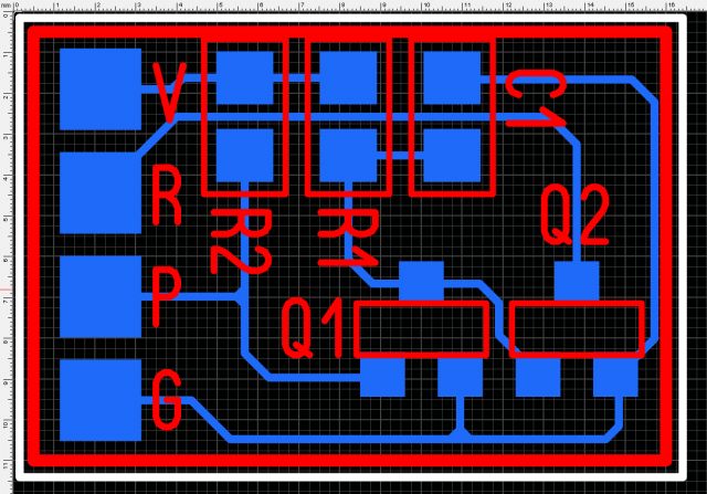

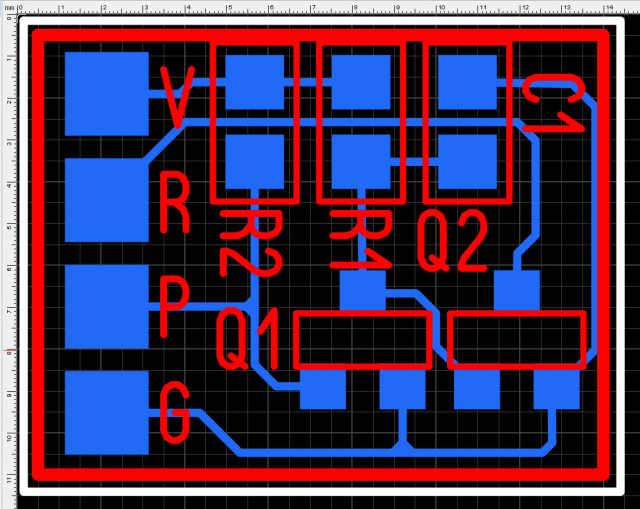

Posts: 10104
Posted: 06:13am 09 Oct 2025
Volhout's wee WD circuit - Single layer, 16.5mm x 11.5mm, designed with solder pads, so you can put a bit of double-sided sticky tape on the bottom of the PCB, and stick it anywhere, in pretty much any project.
Can probably shave another mm or so off the width.
EDIT: I can.  2mm narrower in width, only 14.5mm x 11.5mm now.
@ phil99: Do you want me to do a wee PCB for your circuit?  You can never have too many WD circuits or PCB modules.
Edited 2025-10-09 16:24 by Grogster
Posts: 3429
Posted: 06:39am 09 Oct 2025
Volhout's is more compact and works in a similar way so there probably is no need.
The only difference is at the output end I have added a capacitor and resistor to just pulse the RUN pin rather than hold it low. Holding it low prevents getting back to the console if you try to exit with Ctrl-C.
You may want to add a jumper to the PCB to disable the watchdog when testing the main program.
