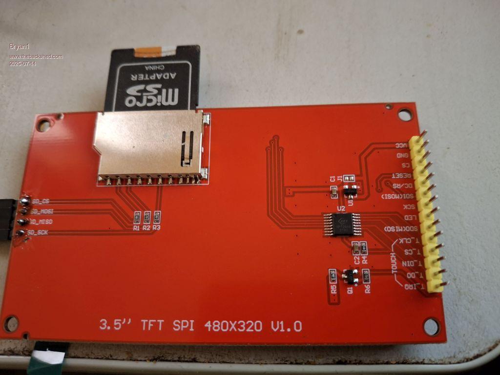

Morning Guy's well over a caffine decided to try a few options so I tried different drivers and to my surprise the backlight worked with EVERY driver but the gui test lcdpanel failed on every one
Here is a pic of the back of the lcd
So my next job with this is to rip out all the wiring and start again just to see if that is the problem.

Ok that looks like a standard ILI9488 and has U1 fitted so Vcc should be 5V.
If you can wire it up like this, which I have working, hopefully there will be a different outcome.

In your first test the SD card also didn't work suggesting the SPI wiring may be the culprit, provided the SD card was no more than 32GB as that is all the LittleFS in the Pico can handle.
If the panel still doesn't work the SPI bus can be checked with just the SD card.

Well rewired it all up did a clear flash and put 6.03 back on and just did the lcdpanel option and noticed it didn't light up like before so did a gui test lcdpanel and got the bubbles   Went and did the gui calibrate and got thru it first time.
