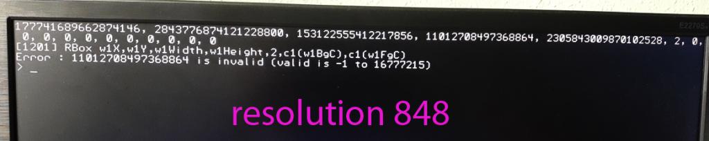

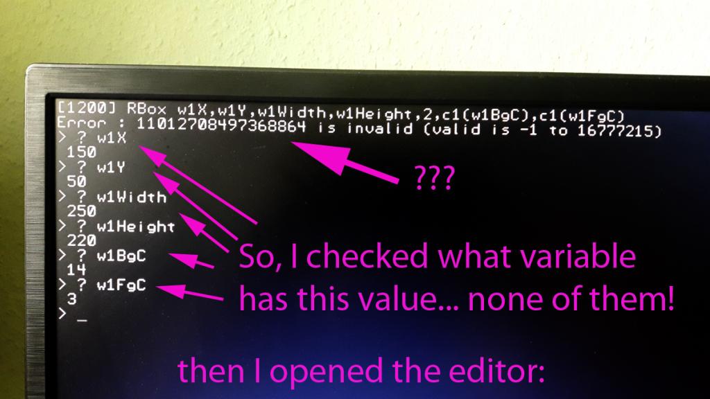

My observations: I am going in the chained program, all fine, I am going back to the main, all fine, there is no re-declaration of the variables and therefore no error, all fine,
BUT then (in the main program) suddenly:
Is this a CHAIN problem? I did all kind of variable checking with debugging PRINT statements. If I comment the whole line out, the problem occurs on the next line.. and so on.
It is always this kind of ERROR but  (if commented out) another huge number.
Have you any suggestions? I attached the exact two files:

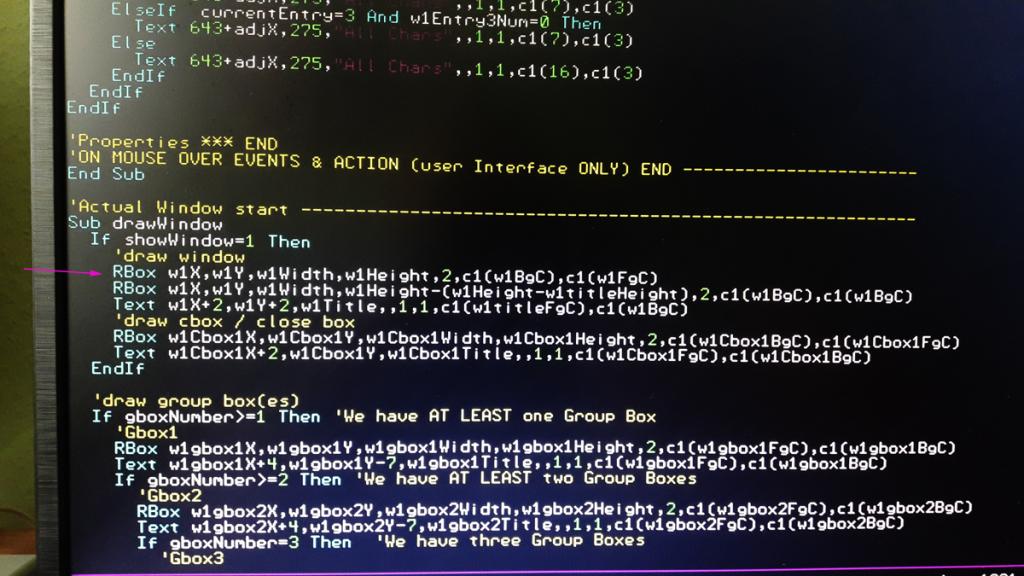

'MAIN LOOP START ###############################################################
 If saveClicked=1 Then       'save to file
   Chain "saveRoutine1"       'go to the saveRoutine.bas
   CLS
   userInterface()                            'go back to user interface
   drawWindow()                               'and draw the window again...
 EndIf
Chaining back isn't from an sub either... So I am clueless. This time I am using the  latest firmware Release Version 6.00.03

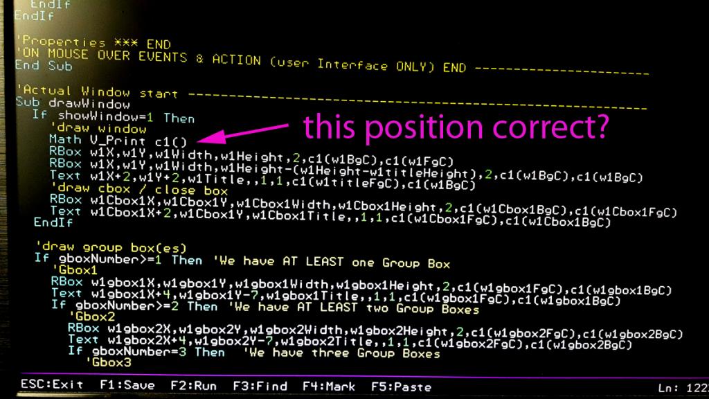

What do you get if you use MATH V_PRINT c1() before the RBOX?
Is c1 float or integer? does it make a difference?
OPTIONS: are you using 848 or 800? If you are please try replicating using 640, 1024, or 1280

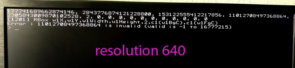

c1() is integer:
I tested it with Math V_Print @ this postition, is it correct?
This gives me in resolution 848:
And in resolution 640:
I really hope that you have a clue what the problem could be. As said, in general chaining works, but not with my program, even though I implemented it exactly like your (and my) working test example... Hm. Problem is, I don't have an idea what this Error even means.

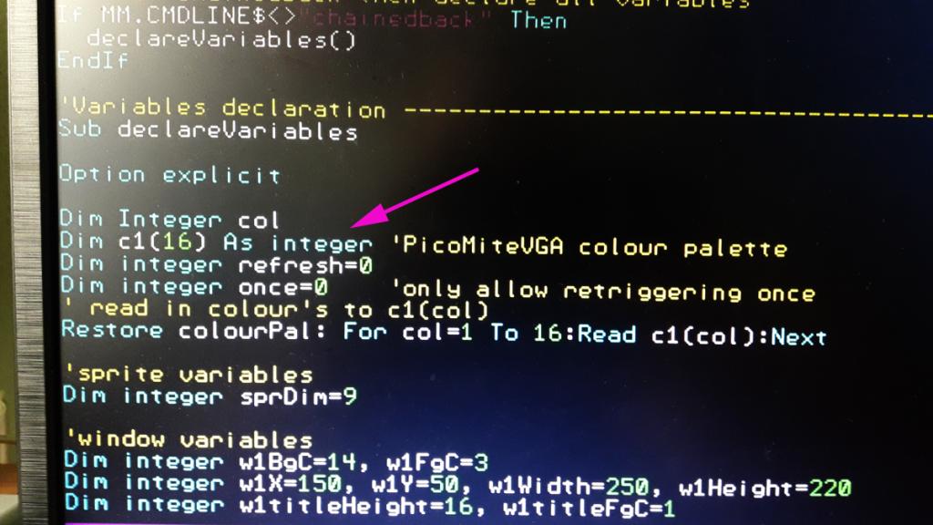

EDIT: By staring at it, I think I have an idea what all this means. You've made me printing the array before the error occurs and this is showing huge numbers. I don't understand why the last of the 16 numbers are "0"... They are representing the colour palette, which is :
' read in colour's to c1(col)
Restore colourPal: For col=1 To 16:Read c1(col):Next
and:
colourPal:
Data RGB(black),RGB(blue),RGB(myrtle),RGB(cobalt)
Data RGB(midgreen),RGB(cerulean),RGB(green),RGB(cyan)
Data RGB(red),RGB(magenta),RGB(rust),RGB(fuchsia)
Data RGB(brown),RGB(lilac),RGB(yellow),RGB(white)
EDIT Nr. 2: Ok, now I think I understand the problem myself: When going back from chaining to the main program, the variables from the "saveRoutine1.bas" are preserved this time and therefore the interpreter doesn't know how to deal with the colours in array c1(). Could this be? Or are the variables from the main program preserved at all times?
Greetings
Daniel
