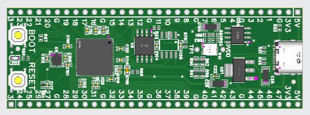

  matherp said
I hope you did choose for 1.6mm (or 2.0mm) thick FR4. Otherwise getting this out of a breadboard pops all the components off (bending the board due to pull-out force at each pin).
Posts: 12176
Posted: 01:28pm 10 Jun 2025
1.6mm is standard for JLC. I've had them in and out of breadboards with no issues. Spudger under each end

RP2350 DIL:
The TPS7A7002DDAR (regulator) is rated 3A. What's the recommended limit for external devices?

Posted: 03:34pm 10 Jun 2025
The TPS7A7002DDAR is only used for DVDD (c 1.3V) the AMS1117-3.3 is the main regulator for 3.3V which is rated at 1A
