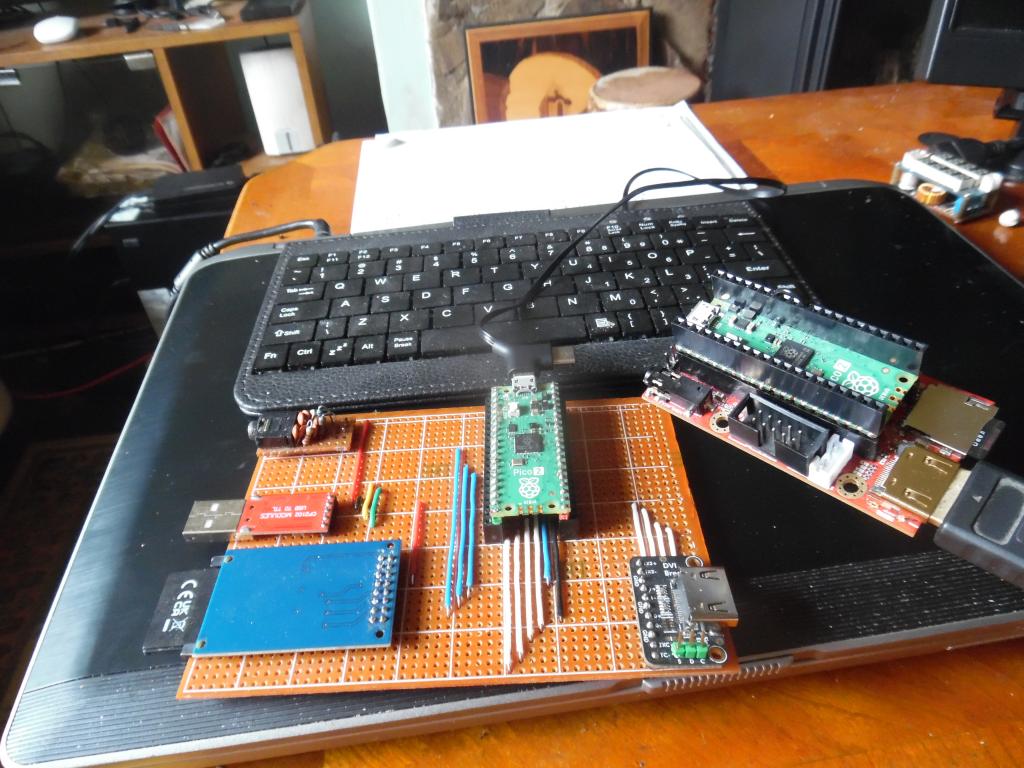

Posted: 05:41pm 27 May 2025
cheapest I found. ordered 2, same £3.40 postage they work
https://thepihut.com/products/adafruit-dvi-breakout-board-for-hdmi-source-devices
wire the pins, get 2350 pico 2 ready welded cos 40 pins is eye ache then solderless strip/bread board and your away... well a few wires but get the idea.
veecad for vero useful.
it could work with molex ribbon. just a quick way of trying mmbasic.
Edited 2025-05-28 04:11 by stanleyella

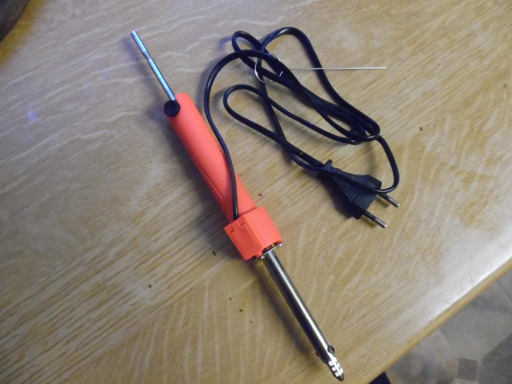

I bought a desolder pump which worked but then an email it was faulty. too cheap to bother, rewire to uk wiring?

With no earth you don't know what's going on inside. If the mains-metalwork insulation breaks down it could, in some circumstances, kill you. The Chinese don't bother too much about such things. They sometime run an earth wire but don't bother connecting it. Sometimes the earth "wire" is only a piece of plastic with no conductor. I can only suggest that, if you are going to use 2-wire Chinese stuff, that you feed it via a sensitive RCD that will trip if there's an electrical fault. You can get some that plug into your mains socket and have a Test button on them. Fuse the plug at something as low as you can get, probably 3A.
Probably 99 times out of a hundred things will be fine. It's that 100th time that's the problem. It can be a "once in a lifetime" event. :(
This stuff generally doesn't comply with UK regs. Here all exposed metalwork has to be earthed unless the item is classed as "double insulated" and carries the appropriate marking.
