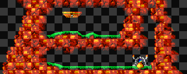

one of the problems to be solved is that the levels are larger than the screen. At the moment, I’m controlling the Lemmings’ behaviour by checking the PIXEL function. This won’t work if, in later levels, the Lemmings also move off-screen.
One possible approach would be to store the levels simultaneously as a 1-bit (black-and-white) array and carry out the query there. However, I’m not sure whether this is a fast enough or memory-efficient solution.
  Volhout said
I still have to check with a unit that has a mouse.
To support this, every lemming you click on currently (as a test) turns into a digger. If you do this on the lower level, it digs its way out of the screen, as there are no boundaries there yet.
Martin

If (just if !!) you could change the display engine to work on ONE framebuffer, AND the lemmings could move in multiples of 2 pixels, there is a possible solution.
1/ everything is written on layer L, and there is NO transparency. This is the display plane.
2/ The N layer is completely covered by the L layer (and thus invisible), and contains a 1:2 copy of the world map (can be in black and white, but consumes 38k anyway).
The PIXEL should be executed on N layer, with ((x+x_pan)/2, (y+y_pan)/2) as coordinate.
There has to be a sub that adapts the N layer for the digger/explosions parallel to updates in the L layer.
Advantage is that the N map can show clear walking paths that not necessarily are identical to the graphics on L layer (in example: the path to the exit). Lemmings could walk "in front" of objects, where they in current system they would stop and turn back.
This could work for maps that are up to 640x480 with a view of 320x240. But the lemmings have to move in 2 pixel movements (-or- move in one pixel movements, but pixel checks are only performed every 2 animation steps). That is also a speed advantage.

So, without getting too imprecise, we could halve the number of horizontal bits in the ‘mask’. That should work. If we assume a maximum size of 640x160 (as with the NES), that would take us from 12,800 to 6,400 bytes. If we do the same for the height, that saves another half. That leaves 3,200 bytes for the Mask
DIM MASK$(40)Length 40 Queries for objects outside the image could then be handled using PEEK and Bit-masking.
Let’s assume that bricks in the Builder are 4x2 pixels in size and the overlap is 2 pixels; in that case, even this can be reduced.
Just a thought, but one thing at a time
Regarding the number of sprites:
I’ve now played through loads of Lemmings levels using UAE and Dosbox, and there are rarely more than 30 Lemmings on screen at any one time. And even if there were more, only a few individual sprites would flicker, not all of them.
In Sub disp_lms
The background: As we are not using the framebuffer, we have to make all the changes before the image is rendered, so to speak.
Options: 1. sprt(f,SPDIR) could be set to 2 instead of 1 to mark the direction to left. This saves the left shift during image build-up.
2.There is an ‘IF’ statement which checks whether the animation value is greater than 15; if so, it shifts the sprite source’s Y-coordinates down by 16. and the X -256
Let’s see if I can speed this up even more.
Interactions between sprites and Layer N take place anyway. The digger is already removing sections from the ground in Layer N.The changes must, of course, then be applied to the form as well.
First of all, I need to write a small programme that can create tilemaps from images of the levels.
