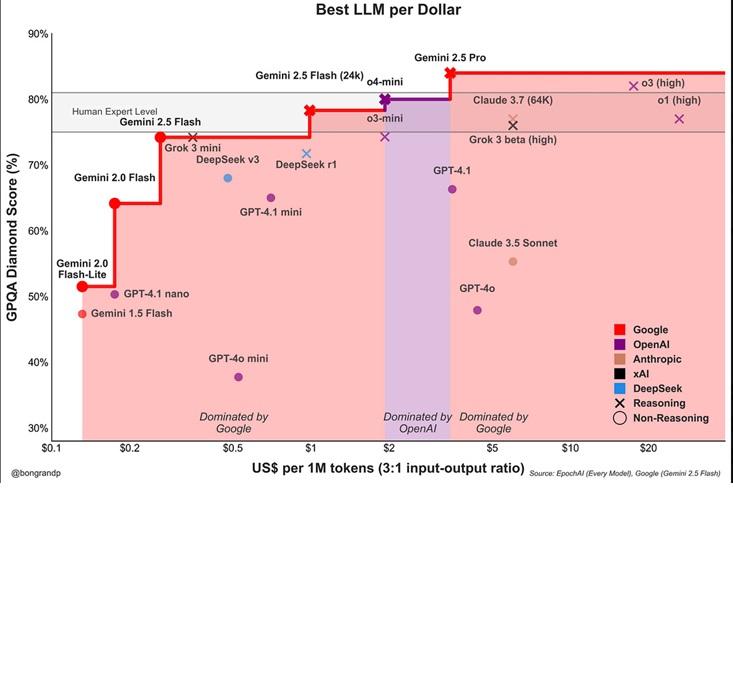

As note to self, and just to keep this thread alive, I see "Human Expert Level" asserted here (for unspecified tasks) for several AI models at a cost of between $1 and $20USD per million tokens:
From (may be paywalled): http://exponentialview.co/p/the-ai-acceleration-delirium-models
I had the motherboard I plan to use working running Ubuntu 24.4 LTS (without the K80--which needs mechanical support and fans but does plug in to the bare motherboard), but now have it packed up in anticipation of our trek from Florida to Nova Scotia. I expect it will be several weeks to a month before I get it set up.
"For tasks AI can handle, research suggests costs might drop to roughly one-thirtieth the hourly human wage."

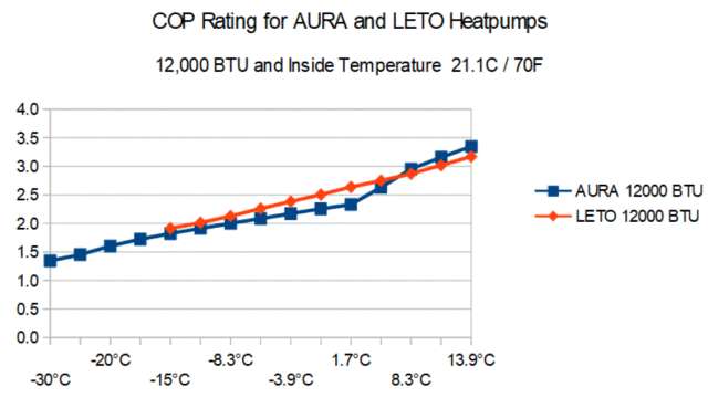

Reading about someone using ChatGPT to produce charts, I decided to have a go. I've had several heatpumps installed, and am very pleased with the results. Looks like they're going to save me a net of about $800 in heating oil this past winter (all final bills not in until June).
I'm looking at having another installed. The manufacturer has an ultra-low temperature version--good to -30C compared to the -15C for the ones I have. I asked the manufacturer for charts comparing the Coefficient of Performance (COP) of the two types across a range of temperatures. They sent me several excel tables which enabled a calculation. I produced a chart:
Hmmm. The costlier one ($1900CDN compared to $1200) is helpful (relative to resistance electric heat) to the lower temperature, but from -15C to about 8C, the lower-cost one is 3% to 10% better. The lowest temperature I recorded last winter was -15C, so it looks like I should go with the less expensive version.
Anyway, I asked ChatGPT if it could produce charts and it said sure. I gave it detailed instructions and uploaded the OpenOffice .ods files (which it said it could handle).  It said the compute tool it needed to satisfy the request was not available at the time, try again later. I tried again in another 2 hours, and then 2 hours later.
So this "tool" is still not available (but should be Real Soon Now it says).
