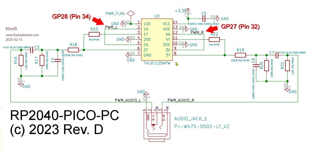

Note for audio to work properly you need to link GP28 to GP26. The pins they used for audio aren't on the same PWM slice.
ManiB
Joined: 12/10/2019
Posts: 193
Posted: 10:50pm 12 Feb 2025
  matherp said  Note for audio to work properly you need to link GP28 to GP26. The pins they used for audio aren't on the same PWM slice.
Hi matherp,
I checked the connections on my board with the Rev. D and couldn't find any interruptions in the connection of GP28 (PWM_L) and GP27 (PWM_R).
And GP26 (DVI_CEC) is connected to the HDMI1 connector.

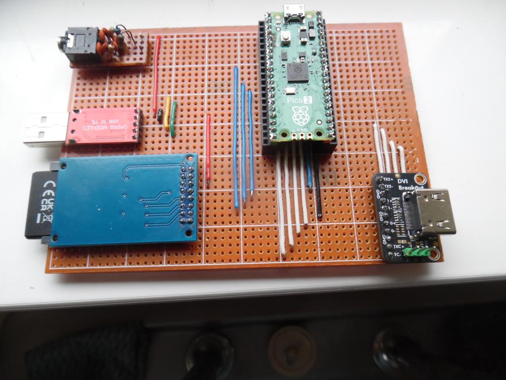

this is why I built a stripboard hdmi 2350 board.
Mick mentioned the audio first and link needed and adc not working same time.
pity, nice board otherwise.
the sound is sharp.. simple filter as shown in latest manual, simpler rc no inductor.
you got any ideas for the "sound prob" and using adc same time. I wanted to do real Lissajous from audio left/right to x/y display. oh well
Edited 2025-02-13 09:21 by stanleyella

The audio problem is that the Olimex board is sending audio using GP27 and GP28. Goodness knows why! They are PWM5B and PWM6A. MMBasic needs both channels on the same PWM channel so the easiest fix is to simply link GP26 to GP28. GP26 is PWM5A so everything is happy, but you lose the use of GP28 and you can't use GP26 for anything else.
GP26 goes to CEC on the HDMI socket but that isn't supported by MMBasic so HDMI ignores it. It won't prevent the HDMI from working.

You have to disconnect GP26 from the HDMI connector. CEC will suffer when there is a PWM signal on it.

It might if you are feeding a TV or video recorder that supports it. I don't think most computer monitors use it as it's only used for controlling multiple devices from one remote. It has nothing to do with the video data.

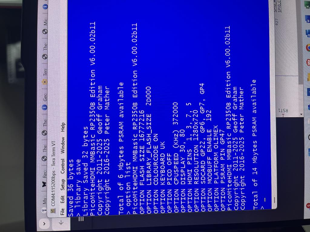

Posting on this thread as opposed to the ‘Beta’ one since I am currently using the OLIMEX RP-2040-Pico-PC carrier board (and a Pimoroni Plus 2 with b11 ; HDMI firmware).
The Plus 2 gives me a RP2350B so that I can test PS Ram stuff.
One observation - the number of ‘Mbytes PSRAM available’ varies between 6, 8 and 14 (with no changes being made; just re-booting). See photo below.
Is this as you’d expect?
FYI - I am trying to get a Pimoroni PGA breakout working so soldered up a USB to it and loaded HDMI b11. If resolution is 640 (and hence the default when firmware first loaded) then all seems ok (noting this is @ cpuspeed 315000).
However, changing to 1024 or 1280 causes very random behaviour -  sometimes resets things to default. Due to instability (and you ‘Eureka’ thread, I reverted to the Pimoroni Pico Plus 2 (as per the message above) and all seems stable.
HAVE YOU (or anyone out there) tried the Pimoroni PGA module with HDMI at the higher resolutions?
Ultimately I am after the extra pins…..

I don't like waving a soldering iron round but built this "hacked" strip board that works. lots of people want a convenient ready made board, some use bread board.
You've said strip board has capacitance problems but I've not noticed any.
sourcing the inductors for the sound filter, no prob but have to unless use simpler circuit in new manual.

  Quote  One observation - the number of ‘Mbytes PSRAM available’ varies between 6, 8 and 14 (with no changes being made; just re-booting). See photo below.
Should give 6Mb reliably - mine does (Pimoroni Plus 2). If you are getting anything else it means the PSRAM bus is not reliable. Check power supply noise etc.
No idea if anyone has got the PGA2350 running reliably at 372MHz. Everything is so marginal with these Pimoroni boards. When (if) chips become available I will be doing my own boards with the 80-pin chip.
