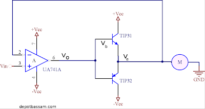

Revisited because I came across this:
From this site
Only problem I see from my attempt at using the circuit simulator applet is that the 741 opamp can only provide ~25mA which means that I won't be able to drive the transistors sufficiently.
What's the best way to boost this, an alternative opamp or a transistor?
Posts: 6253
Posted: 04:27pm 20 Mar 2025
Hi Phenix,
These are opamps (accurate, low offset, high open loop gain, etc..)
OPA541 (Texas Instruments), sells for 20 euro's. +/-40V max 10A output opamp.
OPA549 (Texas Instruments), around same price, +/-30V max 8A
These are audio amplifiers (maybe not that low offset, but much cheaper)
TDA7294 (ST Microelectronics), +/-40V 10A max. Around 4 euro.
LM4766 (TI), +/-30V 4A max
LM3876 (TI), +/-42V, 6A max, around 6 euro
LM3886 (TI), +/-42V, 11A max, around 4 euro
You can treat these as normal opamps in your motor drive application. One thing some audio amplifiers do not have is a large common mode voltage range. That means that you will have to give the amplifier some gain (i.e. 10x) In that case you drive the amplifier with +/-1V to output +/- 10V to the motor.

And so the original post comes round again.  Same circuit but with component values. :)
I really hate the idea of using linear control for motors.
The above circuit has two major problems:
The output transistors will get seriously *hot* with any load.
The torque will be poor.
The latter is because torque is proportional to the applied voltage and this sort of control changes the voltage across the motor so the torque is bad at low speeds and improves as you speed up.
To make things worse, it's inefficient as far as motor voltage goes because it's a half bridge. A full bridge puts the motor across both supply rails. This gives it maximum voltage but also balances the load on the supplies.
PWM uses a constant voltage so the torque at low speed is far better. I understand that you don't want to use it because of reaction time issues, but perhaps you are pushing this too far? PWM with a lighter motor that's geared down would be far more effective than a heavy armature.
If you insist on doing it this way then you could change the output transistors for darlington types, which have a far smaller base current. There is also a configuration called compound darlington which uses PNP/NPN as shown but followed by a NPN pair, which would be better for power handling as large PNP devices are harder to get and more expensive. You may need some serious heatsinks.  :)

  Mixtel90 said  And so the original post comes round again.  Same circuit but with component values. :)
Oh heck, I hadn't realised that
It's not for a real application, it's for a test rig.

"Test rig" might still have 2A motors. At half speed the dissipation is shared between one transistor and the motor so with a 12V supply (only one is being used) that's 12W of heat to be dissipated. It will probably be more as heatsinking is never 100% efficient. Obviously, if the motor needs more current the dissipation will be higher.

I didn't say that it wasn't possible, just that there are disadvantages. e.g. the reduction in torque at low output voltage can be compensated for by including current control in addition to voltage control. It may be using voltage control to adjust the speed and holding it constant by using constant current control. Everything becomes far more complex than the simple amplified op-amp circuit.
You can't get rid of the heat problem in a linear output stage. It's inherent in it being linear. The best you can do is to get the heatsinking as efficient as possible.

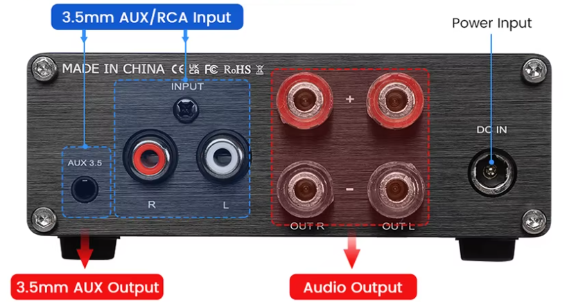

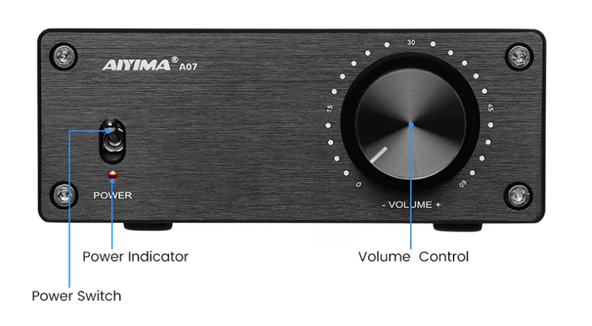

You don't need to build it if you use a Class D audio amplifier module. See AE or ebay, hundreds to choose from. Just remember to divide the claimed output power by 2 or 3.
PWM frequency is usually 150 to 300 kHz, efficiency 85% - 95%, 20kHz frequency response so there won't be much time lag between Vin and Vout.
Yes, I like this approach because it is similar to my industrial servo drives; analog in, PWM out.
Hmmm, I actually have a few of these, not even unboxed. Would they work?

A stand-alone amplifier probably has input coupling capacitors so may need some mods for DC input.
When the input is DC coupled its power supply may need to be isolated from the input ground. Eg a separate plug-pack.

  Mixtel90 said  "Test rig" might still have 2A motors. At half speed the dissipation is shared between one transistor and the motor so with a 12V supply (only one is being used) that's 12W of heat to be dissipated. It will probably be more as heatsinking is never 100% efficient. Obviously, if the motor needs more current the dissipation will be higher.
Sorry Mick,
PWM shines when it comes to efficiency. But it is worse than you description.
Assume the motor efficiency is 100% (it is not, but assume it is).
Assume a 12V motor, and a 15V supply, linear output driver.
If you want to supply 25 watt of mechanical power at it's maximum speed (12V), the current is 25/12=2.08A, and the linear driver dissipates (15-12)*2.08 = 6.25 watt.
In case you want to supply 25 watt of mechanical power at a lower speed (say 50%), the motor is suplied with 6V at 4.16A (=25 watt). The driver dissipates (15-6)*4.16 = 80 watt.
For much lower speeds (i.e. 25%) it gets exponentially worse. 25 watt at 3V motor voltage is 8.3A, and the driver dissipates 183 watt... for 25 watt output.
For a PWM drive the power dissipation in the driver in these same situation are far below 10 watt in all above cases (100%/50%/25% speed). I am sure you can get below 2 watt when carefully designing.
And this also refelects on the power supply. In the 25% speed linear driven motor, the power supply needs to supply 183+25 = 208 watt at 15V = 13.8 amps.
In case PWM the power supply is rated 25 watt + 10 watt = 35 watt (15V 2.2 amps), but should be able to supply peaks of 8.3A (extra buffer capacitors at the output).
P.S. class-D audio amplifiers have circuits that cancel DC build up in the output, and often have AC coupling at the input. Although the electronics are suitable, it may be difficult to remove these DC canceling circuits.
Edited 2025-03-21 17:37 by Volhout
