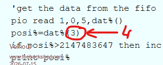

Posts: 6253
Posted: 04:56pm 09 Jul 2026
Top of the code contains a line that enables assembly, and a line that says use test signal. Set that line from 1 to 0.

Posted: 07:48pm 09 Jul 2026
I'd already tried that but no difference.
Not sure what happened but I chopped it down and used GP14 and GP15 to simulate and it works BEAUTIFULLY
You have no idea how excited I am about this   (big plans)
Many thanks, my friend

Posts: 6253
Posted: 06:32am 10 Jul 2026
Hi Phenix,
I am glad you have it working. In hindsight, looking at the code, it could have been better. You can clearly see that it is a derivative from the quadrature decoder, acked together rather fast. I feel a bit ashame I did not make it better.
But now we know it works...
