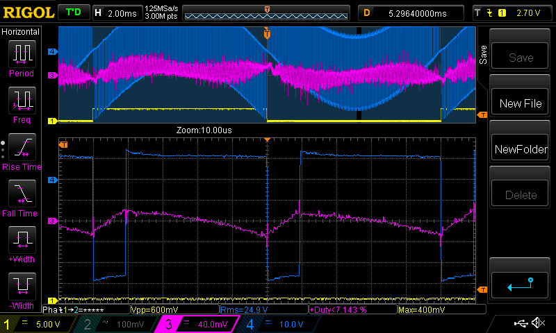

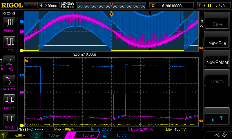

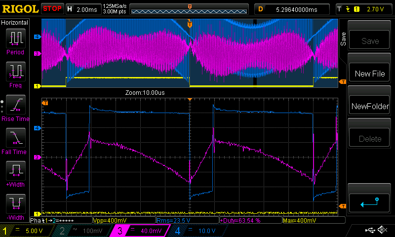

Two chokes. The above screens were from a 188uH choke, driven at 60V DC into
a small toroid. This choke is a small Aerosharp fine Iron lamination with
22 turns.
I also tried another choke, using the TDK E Core ferrite.
6 turns, and it is 65uH. So here are tests of both chokes.
The following DSO captures have
Yellow = 50 Hz square wave used for trigger
Dark Blue = Voltage across the choke. 10V/div
Purple is current through the choke.
It's sensor is 0.0208V/Amps
First we see the 188uH choke
a idle and then with 200W resistive load.
I changed the current sense vertical attenuation  when under load since it went
off the screen.
Next is the 65uH choke. Same test conditions.
what can we see from this?
the voltage across the choke does not change when the AC load changes,
in this case from zero load to 200W.
We can see the higher current, and faster rising current trace from the smaller inductance of the 65uH choke. This is to be expected.
What I like to point out is the balance of Volts x time for both of the chokes.
It must equal zero, or else it will rapidly approach saturation. (bang!)
We can see it in all the 4 DSO captures.
I will examine the first capture in this post.
Looking at the Dark Blue zero position (it's DC coupled) we can see
it goes -50 to -46V over 10 uS. Let's call it an average of -48V for 10 uS
which is -480 V.uS
This corresponds to the time the PWM is OFF
When it's ON, it's on for 40 uS and it's voltage is about +12V on average for that time. this is 12V x 40uS = 480 V.uS
It's the same as the first negative pulse. The running total
of V.uS product is not increasing nor decreasing. This is good.
I think this is really nice to observe.
But what is important to see is that the voltage across the choke does not change
with AC load. It stays the same. The Volt.time product remains equal to zero too.
The PWM width might change a small bit, due to the resistance of various parts of the
system. This change is not important. This change of PWM due to AC load is minimised
by the use of huge primary winding conductors, huge toroids, large FET banks etc. If some of us here did this test we probably would not see any change in PWM width due to the application of a 200W load. In the above captures you can just see it, an increase in PWM ON time of about 1uS with the 200W load.
I wonder if this might help us design the choke for our inverters. I hope so.

Nice pics Poida - thank you. Any chance of an efficiency measurement for both chokes at 200W.  My money is on the smaller 65uH choke as it seems to be doing more under load, storing and releasing energy,  hope its not the 188uH one.
The purple spikes in my opinion may be related to excess dead time - dont get me wrong too much is boring and safe, too little though can get quite exciting.
The expanded part of the waveform appears to be very near the zero crossing point.
If time permits could you please indulge me and also maybe look at the peak of the sine, And even at the 50% points it may be a little more revealing.
I would expect the textbook sawtooth you see in pic 3 upon more heavy loading should increase its p-p appearance, alas I am working for the next 2.5 days and will have no time to set up and see these answers.
