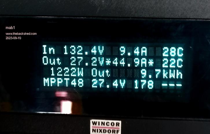

New power record   : didn't notice til after i took the pic that it's actually nudging I_max.
1245w in 1222w out makes 98% efficiency, though i suspect uncertainty in the calibrations are > 2%

Posted: 03:40am 10 Sep 2023
this is great to see.
I like the low choke temperature of 28C, this indicates very small losses
from it.
The star preceding the 44.9A means the output voltage
or battery voltage is within 0.2V of ABSORB voltage
The star after 44.9A means it's limiting output current
to 45A.
I would feel comfortable with increasing the output current limit
to 55A, based on the low temperatures. You could set up the over temp
throttle a bit aggressive to wind back output current quickly
should the heat sink get too warm. ("4 - H.S. throttle low" from the menu)
I agree the efficiency is a bit high and is likely a little less than that
but I would not complain about this at all!

Posted: 12:06am 11 Sep 2023
Alas the low choke temp was due to it being only just powered up after uploading 'new' software (due to an error in my software mod that made it stay in night mode - i still have a lot to learn about programming in C ). It would normally be up above 65C if sustaining that current.
