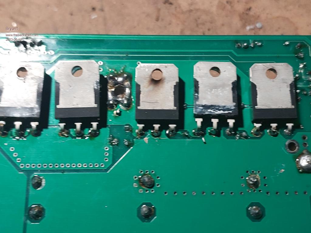

Bryan1
Joined: 22/02/2006
Posts: 2297
Posted: 04:34am 10 Jun 2023
G'Day Guy's,
            Well I reckon I finally got membership in the blown fet club
So fitted all new fets and carefully checked they were isolated and machined up plastic inserts for the fet holes so the screw couldn't touch the fet and short out.
Got all setup again and eh Roger lets make a time mate as one problem is solved another is standing out no current
Saw 80 volts coming but no current so changed it back all parallel and no change to the current. Probed the incoming side of R1 and no voltage present.
Cheers Bryan

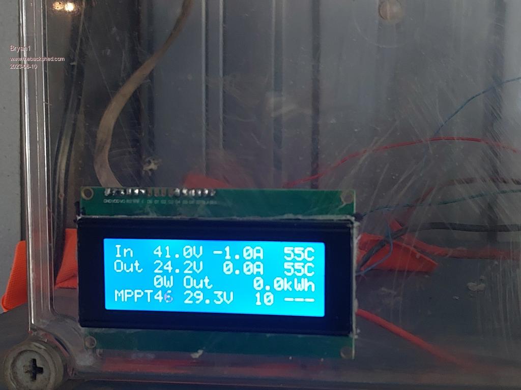

Bryan1
Joined: 22/02/2006
Posts: 2297
Posted: 06:30am 10 Jun 2023
Zizi everything was calibrated and this is the first time it did show the open circuit voltage.
I've now hooked it up to my 12volt array and I'm using my 30 volt 3amp power supply as the input.
It is showing 30 volts in and 12.35 volts out but it has gone into NITE mode, the power also has the current set to max but the board doesn't want to take the current as both the lcd on the power supply and LCD shows zero.
With the R13 12-12 chip the exposed holes on each side of the chip are showing VBat now the TLP250 is at ground on the left and Vbat on the right.
Ziki_the
Joined: 13/04/2023
Location: Yugoslavia
Posts: 39
Posted: 07:04am 10 Jun 2023
For current calibration you need to put current only to hall senzor, not the board input.
First zero current, then 3A from your power supply.
If you did that, then maybe you have some other problem.
Pozdrav iz Srbije
