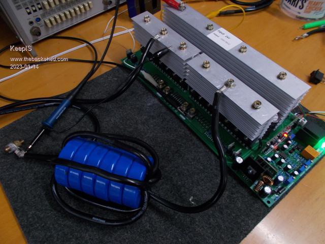

I unwound the other 3 blue toriods I had and placed 6 turns through the 6 toriod stack. I measured 45uH and very high saturation, fitted it to the inverter and it's silent, the Toriod itself is silent and when switching on the big Variac, everything is as quite as a church mouse.
6 stack choke.
3.3 ohm instead of choke in Jig.
Clip lead across the choke in the Jig.
200A per division, 6 stack choke.

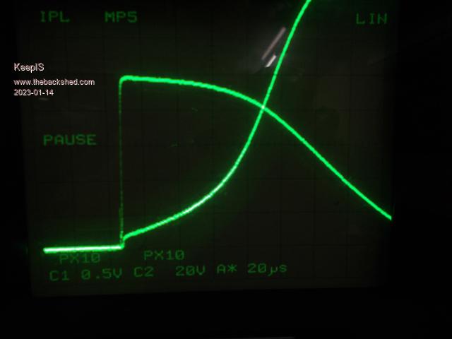

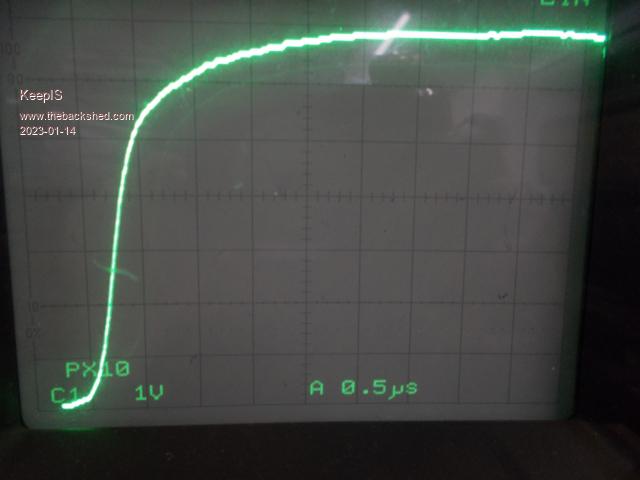

Posted: 10:29am 14 Jan 2023

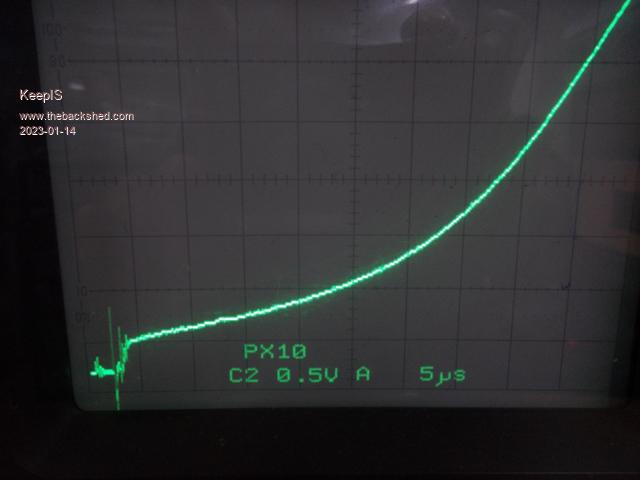

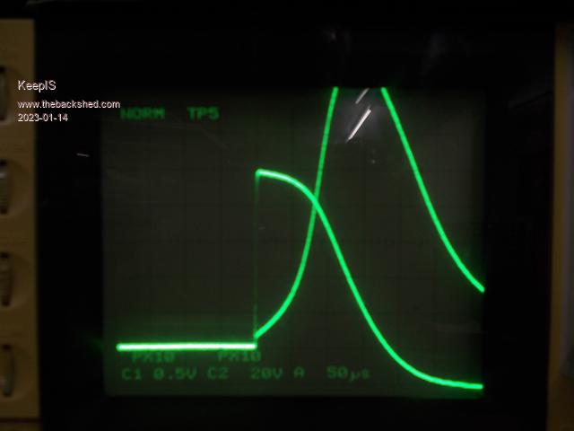

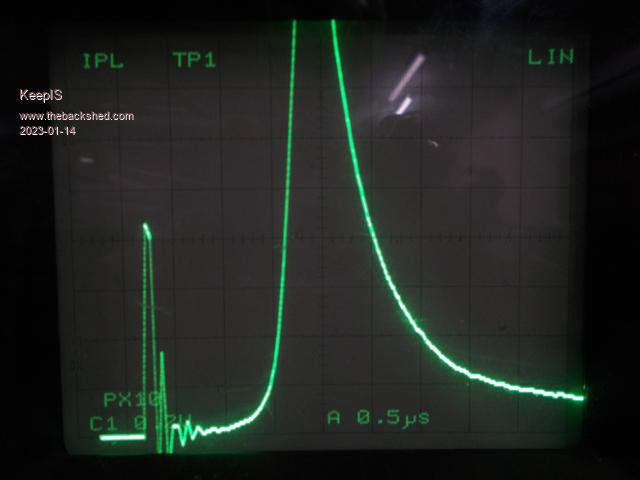

For anyone interested, these are photos of the Current through the Inductor and the voltage across the inductor, which shows the actual start point after the SCR fires.
It's very hard to see the graticule on the CRO as the Camera sees the CRO switching between the channels but it's not visible to the eye. I noticed the voltage goes negative from the collapsing magnetic field.
The Voltage is 100v, Current is 800A at the crossover point.
Zoomed in.

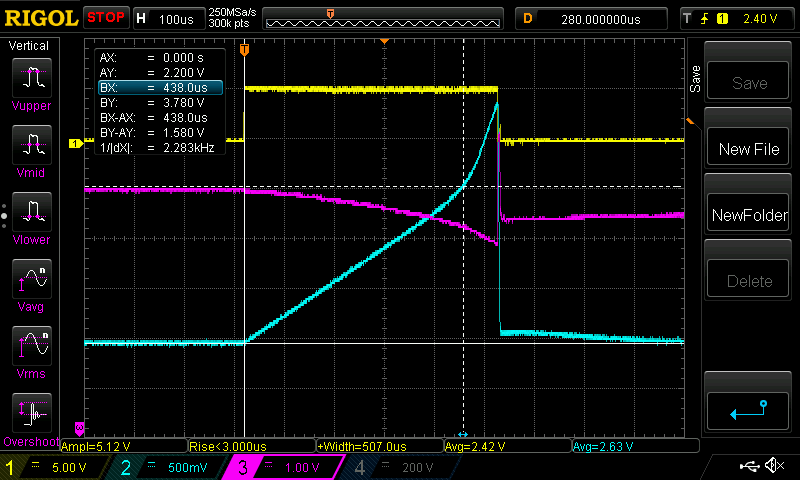

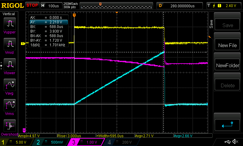

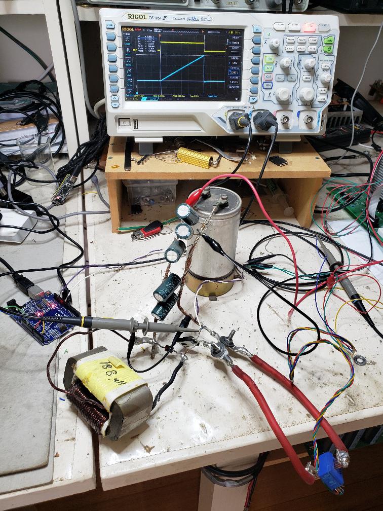

this is how I test inductors.
A FET, driven by a pulse from the Arduino,
width controlled by a pot.
A fast diode for flyback. Any old caps in this case 5 x 4,700uF
Testing the 188uF (as shown by the LCR meter) I get
13.7V average across the choke
pulse width 588uS
max current seen from the current sensor 40.6 A
L = V/I x time = (13.7 /40.6) * 588e-6 = 198 uH
Yellow is gate drive voltage
Pink is voltage across the choke
Light Blue is current
What a nice straight line!
The sensor is a LEM sensor, seen bottom right in the photo.
This setup is not pretty but it works for me.

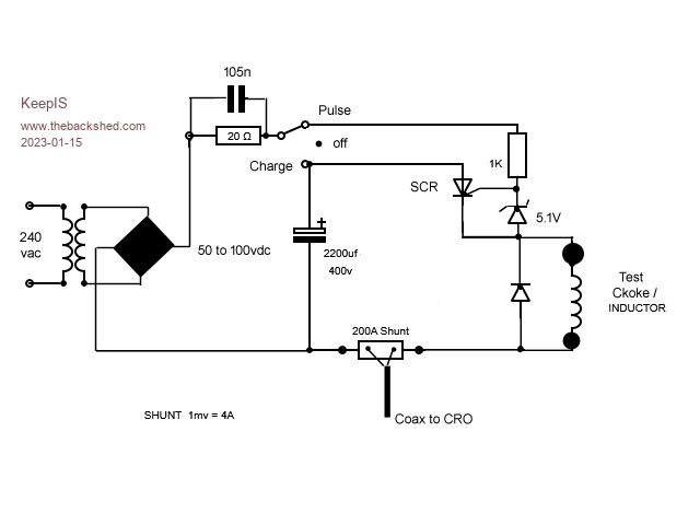

KeepIS
Joined: 13/10/2014
Posts: 2287
Posted: 03:48am 15 Jan 2023

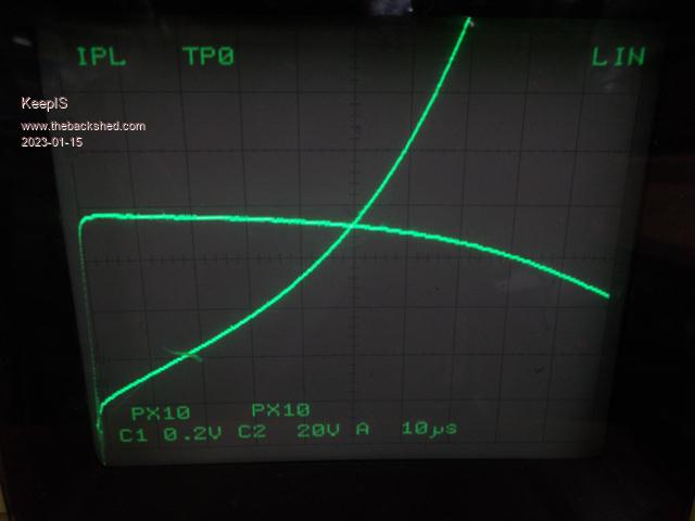

Looks great, I have a bench that can look like that sometimes. Should see about coding something one day, so many thing to do and so little time

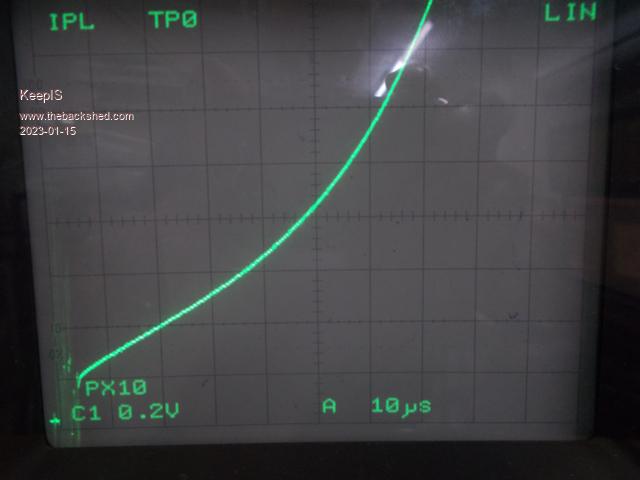

I was just about to post the final circuit, but now? Yes what the heck.
And the result: 45uH 240A choke.
Current is 80A per division, voltage and current curve.
Just Current @ 80A per division.

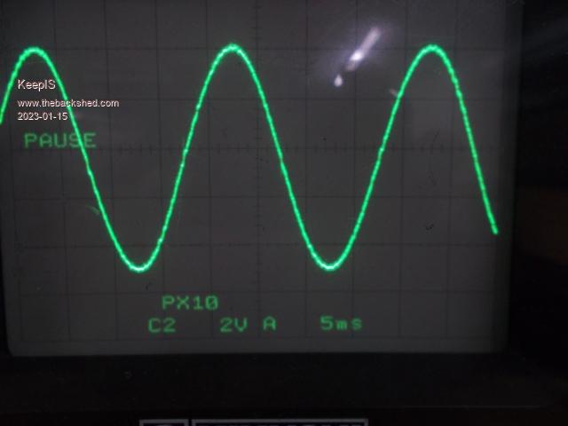

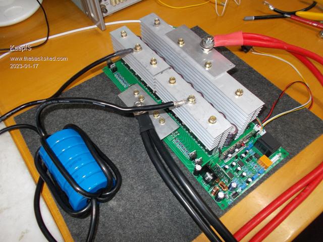

Looking at noise on the Inverter AC out.
I monitor the AC out via what appears to be a small current transformer? pulled from the old SMA inverters I scrapped, 600V to 7.5V 66mA VN30.15/00858 25mm square potted block, quite weighty for its size. Anyway, I use this to give me ground isolation between the CRO probe ground clip and other test gear, or when looking at more then one input on the CRO, and to help with earth loops around the inverter.
I left the gold foil shield on the AeroSharp test toriod, I wanted to see if it made any change to the common kinks in the wave form? No it didn't. Was it useful in stopping noise coupled between the primary and secondary? Yes it certainly was.
However a simple 240V filter on the secondary side of the transformer does exactly the same thing as the transformer shield. This could change at high power?
The small amount of noise reduced quite a lot, and there was no longer this weird noise induction appearing on the AC out when I touched the choke lead. I thought that was being induced into the CRO leads, but since the shield stopped that too, it's likely more just radiated noise getting into the primary windings and my test layout.
I have found a few interesting results in this current test setup:
1: Crossover point glitches get worse as the resonating CAP value get larger.
2: Placing a CAP at the output side of the primary Choke does remove some noise, but it does the same thing as increasing the secondary CAP value, it causes the crossover glitch AND it also increased idle current, so there may be some resonance interaction at play?
3: A lower value of resonating CAP did not increase idle current, but that may be because the lower value of CAP [1.2uF] was needed to resonate the transformer at 76 Hz.
4: The Choke from blue powdered iron mix cores at only 40uH, let a tiny amount of 24 kHz switching noise through to the secondary. However:
A: It does NOT increase idle current [11 watts], therefore it is not causing eddy current loss in the toriod, well at least not at low power loads and idle.
B: It removes most of the remaining glitches on the sine wave.
C: The sine wave no longer change shape under light loads.
D: The transformer, choke and load are now silent at idle to 300 watts (may test limit) and zero startup noise.
E: Using a choke with "more" inductance causes a slight startup growl and the Toriod starts to get a low frequency growl even at idle.
This is with the transformer shield, 40uf choke and 1.2uF CAP.
I've just modded the EG002 board and I will get it connected to the batteries tomorrow.

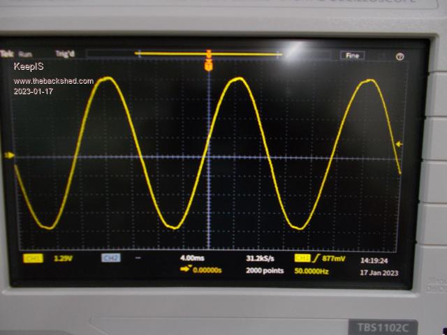

During most of the 20 ms period of the AC output waveform, the PWM should be seen as a train of pulses, smoothed over by the LC low pass filter.
The pulses change little in width as does the output voltage when viewing a narrow
part of the output in time. But crossover is different.
At crossover the PWM pulse train now should be viewed as a single very short duration
pulse in a period of zero output.
This pulse delivers full DC supply voltage. It's not a trivial thing to do to
a resonant system at zero voltage.
The toroid and other parts will be hit with this sharp pulse carrying a very wide
range of frequencies and with good power too.
It must ring at some frequency after the pulse hits.
This is an inherent characteristic of PWM modulating an AC sine output.
Somehow near zero voltages need to be produced from very narrow PWM pulses.
And at zero voltage there will be increasing gaps between the smallest available pulse widths where no pulse is required.

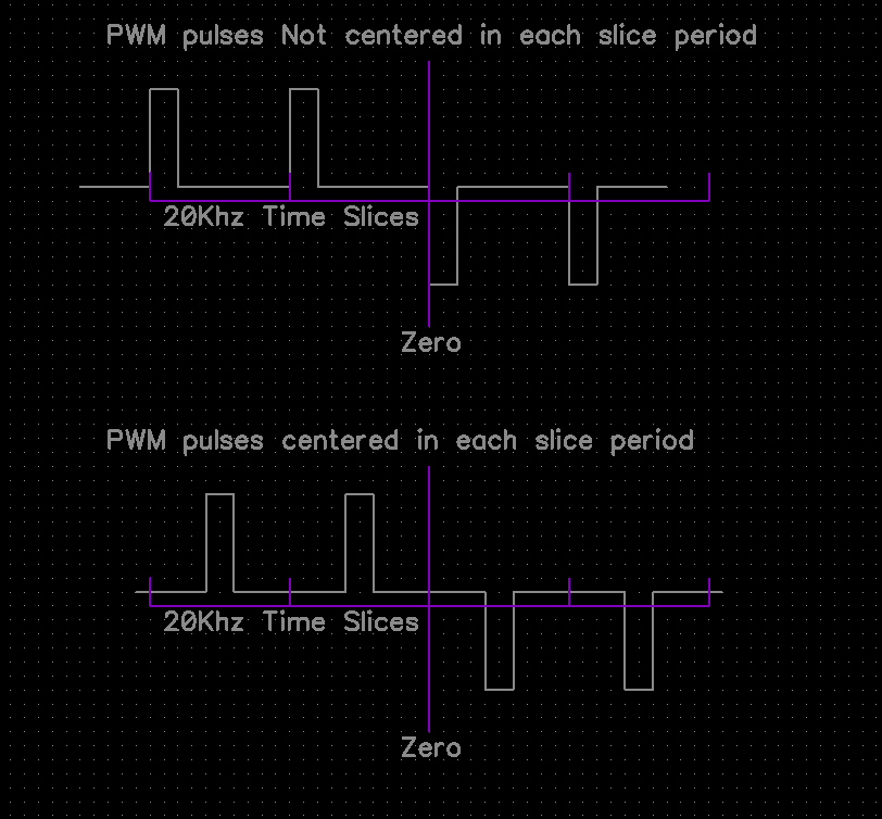

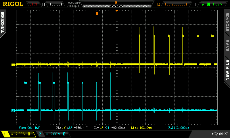

I was reading, cannot remember where, that if the PWM pulses are centered in each 20Khz time slice period, the modulation distortion is much reduced. See sketch below.
I think its much easier to produce the PWM at the start of each period, eg after timer interrupt, as in the top sketch.
If the CPU timers allow an offset and the bottom modulation achieved - 2nd sketch, then distortion products would be reduced and perhaps leading to more efficient operation.

Thanks for all this great in depth insight, love this forum.
Just had to try the inverter before lunch after just getting it connected to the Batteries.
I used a variac to drive a hot air gun on high, I know, only a restive load, but one step at a time.
I monitored the waveforms into the primary, the AC output and measured DC input current and AC volts.
I was looking for any sign of saturation as I had to unwind the existing 250V secondary and use the 230v [was primary] as my test secondary. sticker said 2000VA.
However the AC out never moved from 221vac, everything appeared to be virtually silent, it was hard to tell though as the dam hot air gun was loud.
There was a slight warmth from the Toriod after a minute or so, everything else was cold, including the choke and the high side heatsink.
No good showing the AC waveform at 1600 watts as it's exactly the same from no load to 1.6kw. That was the last waveform I showed a few posts back, it just looked like it was on freeze frame.

  Solar Mike said
  poida said   This is an inherent characteristic of PWM modulating an AC sine output.
Mike
I have had yet another go at the PWM generation code for the nano/pico-verter
I think I have got perfect symmetry.
In the past there was a couple of small width pulses in not the right places
and this probably gave rise to some part of the zero crossing wobbles.
here it is, using 10kHz PWM to make it more clear that each pulse is exactly
correctly timed and going out the correct pin at the right time.
I will test this code tonight to see if it's any good.
wiseguy
Joined: 21/06/2018
Posts: 1335
Posted: 03:58am 17 Jan 2023
Poida, that is the waveform I have been lusting for well done !!
I do expect it to work just fine - please share what was required to actually fix it - even if the answer goes over my head I am still very interested to know.

I have a few AC/DC clamp meters, one has a peak function with a with a slow decay, tried a big power saw, 140A surge, no problems. Threw a 2kw jug at it @ 41A while it boiled, 1.4kW vacuum cleaner. All just plugged into the AC out, no Variac.
No smoke yet.
Going to add a quick charge start, in case I turn the Battery switch on before precharging, I'll also a Load disconnect whilst powering up, I know these are already on wiseguys boards, but I need something independent of the inverter while testing.
Because I use an ATA with the current inverter, load disconnect/connect, battery low and over voltage etc are all handled independently of the inverter anyway.
Test setup on a small part of the main battery bank rewired to 48V @ 9kW.
FYI: The existing HF inverter [24V -> 400VDC -> 230 AC], it's powering everything at the moment including the house and work shed, here is the mains waveform from one of the AC outlets.
