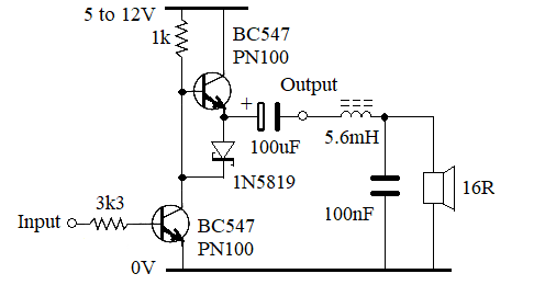

Posts: 3430
Posted: 01:11am 30 Nov 2022
"Volhout's filter makes is of no consequence to me. I expect that what you hear when using the switching transistor is the audio harmonics in the signal filtered out by the frequency response of the device and your ears."
That is also my experience.
This morning I have tested this Class-D push-pull amp. It gives more volume than a single transistor.
The output filter makes no audible difference, though the scope shows it greatly reduces the 44kHz at the speaker.
Transistor types, resistor and capacitor values are not critical.
It just increases the amplitude of the 44kHz modulated square wave.

Turbo46
Joined: 24/12/2017
Posts: 1694
Posted: 02:03am 30 Nov 2022
Thanks Phil that's a handy little circuit.
For Tom's device which is apparently a piezo speaker with +ve and -ve terminals the AC output may not be a good thing. Maybe the electrolytic could be removed for that case?
That's also why I think an H-bridge would not be a good thing because it would be feeding the device with effectively an AC signal.
It IS good to reduce the 44kHz as much as possible if you are going to feed the audio into a hifi system with tweeters and a high frequency response. But for a simple circuit with an el cheapo speaker I wouldn't worry.

Posts: 6254
Posted: 08:53am 30 Nov 2022
One of the Russian review comments on this item was that it was a dynamic buzzer 16 ohm coil impedance (loudspeaker) component, not a piezo.
Let's stick to that, so Tom is not needlesly confused. The single transistor and resistor buffer will be the simplest to implement.

Posts: 6254
Posted: 02:16pm 30 Nov 2022
@cosmic frog, @mixtel90,
Can you please check if PAM8403 works ?
The PAM8403 changes a (small) analog signal into PWM (class D) and feeds it to the speaker.
In picomite case there is no analog signal, there is a PWM signal (44kHz). If I feed that unfiltered to a PAM8403 you PWM modulate a PWM signal.
That may very well not work at all.
If you need to convert the picomite PWM signal to analog (the filter with inductor, or the 1 transistor active filter), then attenuate it, then feed it to the PAM8403,  you might as well connect the loudspeaker directly to the filter/buffer.
Maybe Phill's solution is the best and simplest. Use the PWM at GP0/GP1 and use it to drive the speaker directly (via a 100uF capacitor), and it is tested !!!
