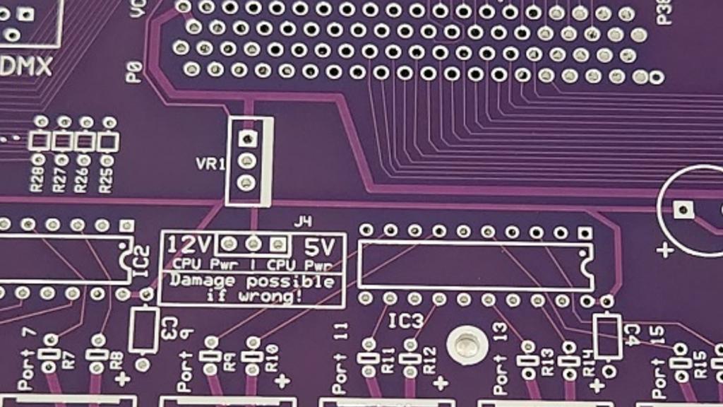

The beauty of Sprint is that if you need to do something like this... you just draw it.
So 20 minutes... call it done.

Meanwhile, elsewhere, "Production board just arrived":
Whatever it is, I ain't buying one
@pwillard
You have a white silkscreen but how'd you get the black border?
Clearly there're lots of little SL6 tricks that I'm unaware of.
Craig
Posts: 9329
Posted: 09:08pm 29 Sep 2022
The "border" is a cutting line on layer O. The top silkscreen is on layer S1.
