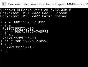

You will have to excuse me if I am misunderstanding the "controversy", but the fact that you are assigning an integer constant to an undeclared variable does not effect its initial type, e.g.
a and c! are floats, b% is an integer.
Edited 2022-08-04 04:28 by thwill

Posts: 4410
Posted: 07:15pm 03 Aug 2022
  Mixtel90 said  Tom:
In that case the manual is wrong in both places.
Not sure what your second place is, but the section titled "Constants" on p45 seems fine to me ... though personally I would have replaced "Constant" with "Literal" throughout. It's only talking about the type of the literal value it seems to have no impact on the type of the variable you assign the value to ... though of course assigning an integer literal to a float variable or a float literal to an integer variable will perform an appropriate conversion/truncation or report an error.
