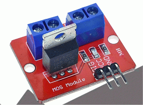

In order to test various TO-220 N-CH logic level mosfets with the picomite, I cut the nearly useless IRF540 (up to 9V for full on--why don't they use IRL520 or IRL540 or other logic level mosfet?) off of one of these mosfet modules and soldered on a 3-pin female header:

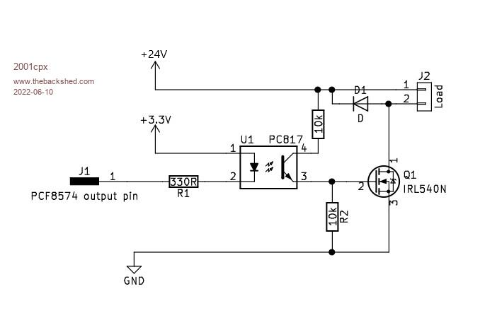

I always use optocouplers with mosfets, I've never had a problem. like this taken from google

  2001cpx said  I always use optocouplers with mosfets, I've never had a problem. like this taken from google
That just feels better after experiencing the USB disturbance.
Would I simply add a voltage dividing resistor for 24V?
Craig
Posts: 9329
Posted: 01:37pm 10 Jun 2022

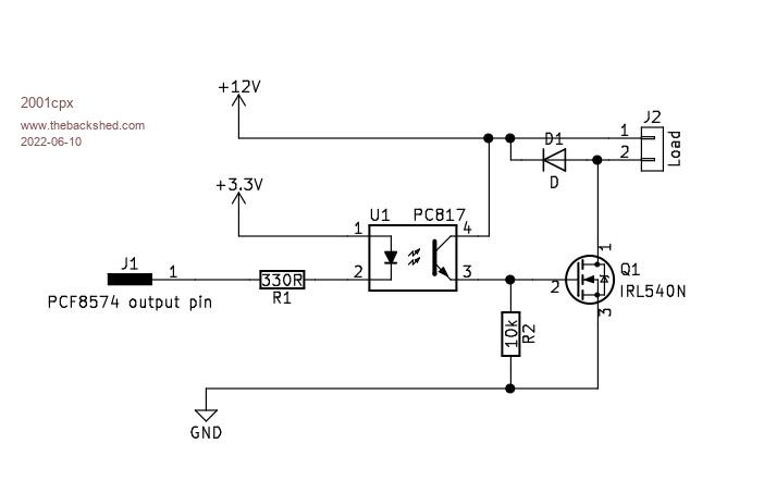

That should be ok. The IRL540N, for example, has a maximum gate-source voltage of 16V so you have to stay within that. You can probably drive the LED in the opto at two or three mA.
Posted: 01:46pm 10 Jun 2022
and you can miss out D1 if the load is resistive
