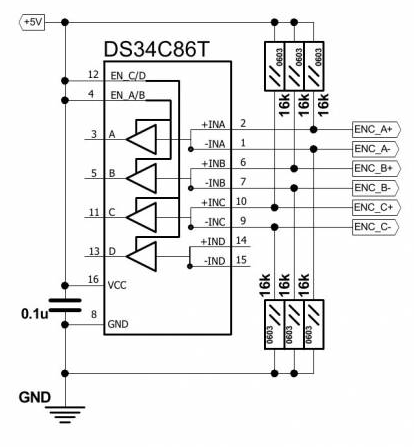

So, from a hardware angle, you'd want a board with a RS422 receiver for the feedback and a +/-10V to control the motor? Would it need to send RS422?

  Mixtel90 said  So, from a hardware angle, you'd want a board with a RS422 receiver for the feedback and a +/-10V to control the motor? Would it need to send RS422?
No. There is no comm's protocol. It's just like counting pulses on any other pin. Remember our discussion about checksum vs CRC? Well this is what I was referring to when I stated that CNC machines rely 100% on pulse integrity. Lose a few pulses here and there and your machine could self destruct
Craig

So 5V, GND, 3x 5V open collector inputs (pullups on the board) and the +/-10V?
Tinine
Joined: 30/03/2016
Posts: 1646
Posted: 05:26pm 06 Jun 2022
  Mixtel90 said  So 5V, GND, 3x 5V open collector inputs (pullups on the board) and the +/-10V?
Drat....I was waiting for this
I kinda went quiet on this because I felt bad, after all the contributions...I went with my original crude-ish LM358 filter....I know that it works
BUT now we have an excuse to refine the design, right?
Craig
Tinine
Joined: 30/03/2016
Posts: 1646
Posted: 05:35pm 06 Jun 2022
I'm still using the 3486 line receiver due to availabilty. CD4050 for level shifting.
Craig

I'm not sure how much of a goer this could be, given the limitations on pcb area. Adding chips takes up space - and I don't want to use SMD unless it's the only possible way - and even then I'd rather not do it at all. So far it needs:
A dc/dc converter to get +/-15V, preferably from the 24V supply.
A LM358 with associated components
A DS3486T with associated components
A CD4050
That's crowded for this design.

Hey, that's my crude filter with different resistor values
I actually went with a gain that results in +/- 9.9V to utilise the full DAC resolution.
Craig
