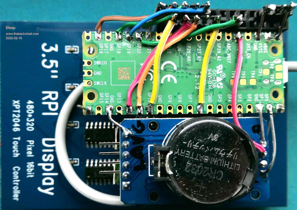

Hi Peter,
Sorry, in that case I must have wired it up wrong :-( I'll try again with your settings, if I can get it working, it would be great, using a whole Pi, even an old one, just to be a clock, did seem like a waste. Many thanks for all your hard work.
Regards Kevin
I'll post pics with case & larger screen once I succeed :-)

Hi Peter,
Of course it's working perfectly :-)
It was the link you gave me to your 2017 post for the correct pin wiring that fixed it, I was using some incorrect pin wiring information :-( Thank you for pointing me in the right direction, might it be worth putting the correct pin wiring in the user manual, (and the fact that your 9481 driver also works with 9486 displays) I'd have never found that post without your help.
Regards, Kevin.

I have also found that on my display, there was a resistor labeled "LED Function" which when I traced it through looked like by moving it to a second location I could activate the variable back light, which comes out on pin 15 of the LCD connector, and it works. :-)

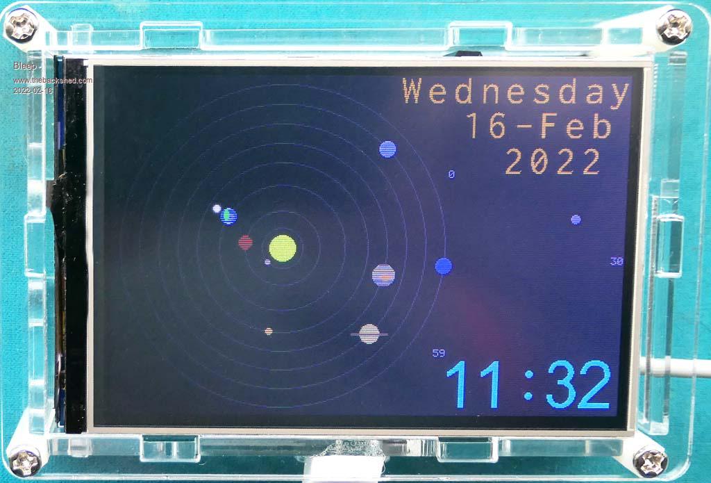

Finished 3.5" Raspberry Pi touch display, attached to a Pico, & RTC, in a perspex case that came with the display, Display on Ebay.
Many thanks to Peter for PicoMite and pointing me in the correct direction for connecting the diplay and the fact that even though it was a ILI9486, the PicoMite  ILI9481 driver worked fine, which it does. :-)  Because I got the back screen brightness working I have also done automatic brightness, depending on time of year and time of day, it can be overriden with the touch screen brightness control.
Thanks to all involved,
Regards, Kevin.

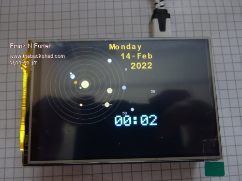

@Bleep:
Thank you very much for your phantastic project:
Currently still without RTC...
@homa
...and thanks for pointing out the beautiful display! (https://www.thebackshed.com/forum/ViewTopic.php?FID=16&TID=14512)
Frank
