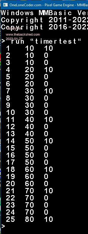

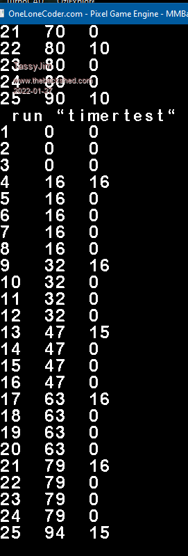

Posted: 08:01pm 26 Jan 2022
You are making good progress.
I am still seeing resolution problems with the timer.
Without any other programs running, the resolution is 10mS
Start any other program that has timing involved such as MMEdit V5 or VLC and the timing resolution changes to 15-16mS
I expect that it involves the timeBeginPeriod function (timeapi.h)from the Windows API
An extract:
  Quote  timeBeginPeriod function (timeapi.h)
Prior to Windows 10, version 2004, this function affects a global Windows setting. For all processes Windows uses the lowest value (that is, highest resolution) requested by any process. Starting with Windows 10, version 2004, this function no longer affects global timer resolution. For processes which call this function, Windows uses the lowest value (that is, highest resolution) requested by any process. For processes which have not called this function, Windows does not guarantee a higher resolution than the default system resolution.
Starting with Windows 11, if a window-owning process becomes fully occluded, minimized, or otherwise invisible or inaudible to the end user, Windows does not guarantee a higher resolution than the default system resolution. See SetProcessInformation for more information on this behavior.
I am running W10 and I think you are on W11.
The test program used:
 DIM INTEGER starttime, laptime, midtime
 starttime = TIMER
 midtime = starttime
 FOR k = 1 TO 25
   FOR n = 1 TO 10000
     x = LOG(12346)
   NEXT n
   laptime = TIMER - midtime
   midtime = TIMER
   PRINT k, TIMER - starttime, laptime
 NEXT k
Edited 2022-01-27 06:03 by TassyJim

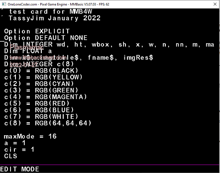

Posted: 03:21am 27 Jan 2022
A test program to show off the modes.
The CIRCLE function creates artifacts on the outside of the circle.
Use the C key to toggle the circle on/off
Also, P -saving a BMP, creates a unreadable file. I will investigate that further.

Plasmamac
Joined: 31/01/2019
Posts: 620
Posted: 06:11am 27 Jan 2022
Hi,
after startup and edit
no option line on the Bottom after changing mode
no code line pointer at Startup/edit
Edited 2022-01-27 16:20 by Plasmamac

Posts: 12185
Posted: 08:21am 27 Jan 2022
  Quote  It's complaining of Option angle degrees and Option keyboard.
Not implemented yet
  Quote  after startup and edit
Know the issue - will fix
  Quote  The CIRCLE function creates artifacts on the outside of the circle.
Know the issue - will fix, this will also fix the arc problem as it uses the same code
Need to find a better timer - any ideas?

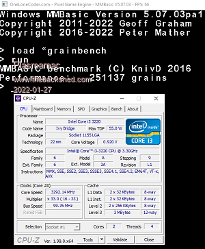

Plasmamac
Joined: 31/01/2019
Posts: 620
Posted: 09:13am 27 Jan 2022
HPET?
Plasma

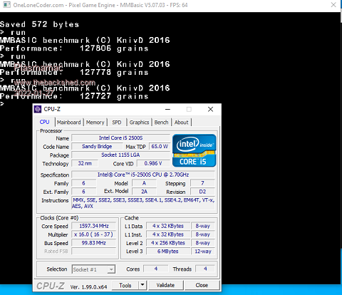

  Volhout said
  Plasmamac said  Hi,
Editor Mode - 16 % cpu
Run    Mode - 30 % Cpu
Grainbench 130201
I5 2500S  with 2,7 Ghz
its a litte bit faster as version 1  12700 Grains
looks fine here
I ran the grainbench on this i5 system: 175000 grains.
So the computation speed is top. While running grainbench it is 55% CPU load.
No idea why the text printing is slower. Maybe the throttle is removed from the graphics output routine, or my W10 machine is not HW compatible (driver mismatch on HW acceleration?). But I can watch youtube video's on this machine, so it is graphics capable.
WoW! On my 3.5GHz i9 system running Windows 11, I only get 119210 grains.
toml_12953

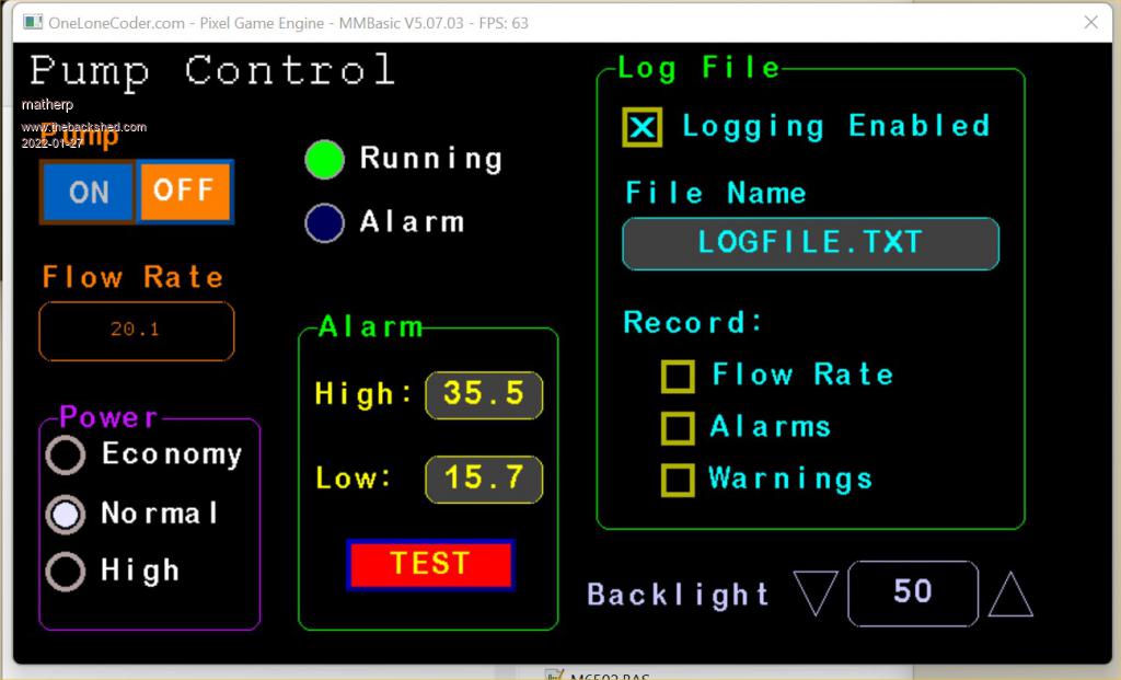

  matherp said  NOW with full GUI and Mouse support
MMBasic.zip
How do I change to the US keyboard? CONFIG KEYBOARD US doesn't work.
Plasmamac
Joined: 31/01/2019
Posts: 620
Posted: 09:36am 27 Jan 2022
my i3 desktop with a 710 card
Plasma
Test code for the GUI, please give it a try
gui-test.zip
I get
[23] GUI Interrupt Touchdown, Touchup
