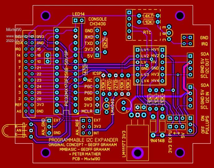

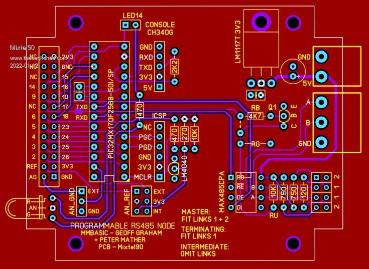

I've put the DE inverter back now as it costs virtually nothing. I like that system, it's elegant and neatly supported in MMBasic. :) I've added suitable pads/links so it's also optional.
The PCB should fit either case now, although end panels still need sorting out.
I've also moved chip pins 17 & 18 to the 21 & 22 positions on the connector. This means that there are still usable IO pins in those positions, even if the pin numbers are wrong. It also means that the missing pins are SCL, SDA, IRQ and 7, only 7 of which would normally have been used as a conventional IO pin. The pin 7 connector position now has a solder blob link to connect it to the actual pin 7. This is to allow the board to run as a free-standing 28-pin controller board without using the DE control, so no RS-485. It might be useful for something. It opens up the possibilities of using COM1 for TX/RX/GND comms.
I've supported using an optional LM4040 voltage reference for Analogue Power (pin 28). This can be the High reference voltage for analogue measurements on the MX170, but I'm not sure if the Micromite firmware supports this. It doesn't appear to in the 5.05.03 manual. It doesn't matter much as the chip is running from a regulated 3V3 supply anyway.

Posted: 08:02pm 11 Jan 2022
Big day. :)
Piccies and Gerbers.
Micromite I2C expander.zip
Micromite 485 node.zip
Posted: 08:52pm 11 Jan 2022
Thanks for this. Five blue PCBs ordered from JLCPCB for $6.40US, slow boat shipping to Florida. How amazing is that?
I don't yet have a specific use, but nice to see Geoff's idea implemented. With a picomite, functionality seems to approach the F4, but with the possibility of VGA output to a big screen.
Turbo46
Joined: 24/12/2017
Posts: 1694
Posted: 11:31pm 11 Jan 2022
Thanks Mick, They look good
Is there any chance that you can post a rear view and circuit please. I just may have to get some.

  Mixtel90 said  Big day. :)
Does the RS485 driver have RX/TX LEDs so can see activity? Not seeing any LEDs...
Also, is there any cost advantage to using discrete RS485 components as opposed to layout for a "ready to go" RS485 module?
Would like to see schematic if available.

  Quote  Does the RS485 driver have RX/TX LEDs so can see activity?
+1
  Quote  is there any cost advantage to using discrete RS485 components
I'm interested as to what you mean by 'discrete RS485 components'?

Updated circuit diagrams to follow. I'm one of the naughty ones because I do the PCB first then do the schematic from that...  ;)
There are no specific TX/RX LEDs. There is a single bi-colour red/green LED. Normally red is "power on" and Green is via a link LED14 to pin 14 so it is under user control. You could remove the ground end of the resistor for the red led and connect it to a pin to put that under user control too if you so wished.
There is no RS485 module. It does use a RS484 transceiver chip, but so would a module. The I2C version uses a level shifter module, is that causing confusion?
I've no idea about how DE works either. However, I assume that, as it's inverted, it might be under hardware control as Geoff could have corrected it in firmware otherwise.

I've referred to these modules as an IO Extender and a RS485 Node.
The I2C Extender is intended to be, literally, IO extension to any MMBasic platform using  I2C. That's why the modules loop through and are short range. It can also run as a stand-alone Micromite by changing the firmware.
The RS485 Node can be a RS485 master or slave. You could link, say, three together and use switches on the master inputs to control outputs on the slaves. The terminating resistors let you set the system up appropriately. The range is *far* greater using these, but at the moment no MMBasic platforms are specifically designed to work with RS485. (Yes, I'm thinking about it...  :) )

@Mick,
I'm mainly interested in the RS485 unit. I just would like to see the schematic and both front and rear views to verify the design (no offence meant). That was part of my life in my working days. I think it suits my Slave program, or the program can be mad to suit it.
I suspect you're right about the DE pin.

The circuit of the RS485 version is pretty simple really. COM1 on the Micromite is connected directly to the MAX485 chip. Pin 7 (DE) is connected to both /RE and DE on the MAX485 via an inverting transistor as pin 7 is normally high, going low during transmit. (Thinks... I should perhaps have included a highish value resistor to turn the transistor on so that the system is in RX mode if the Micromite IO isn't initialised.)
