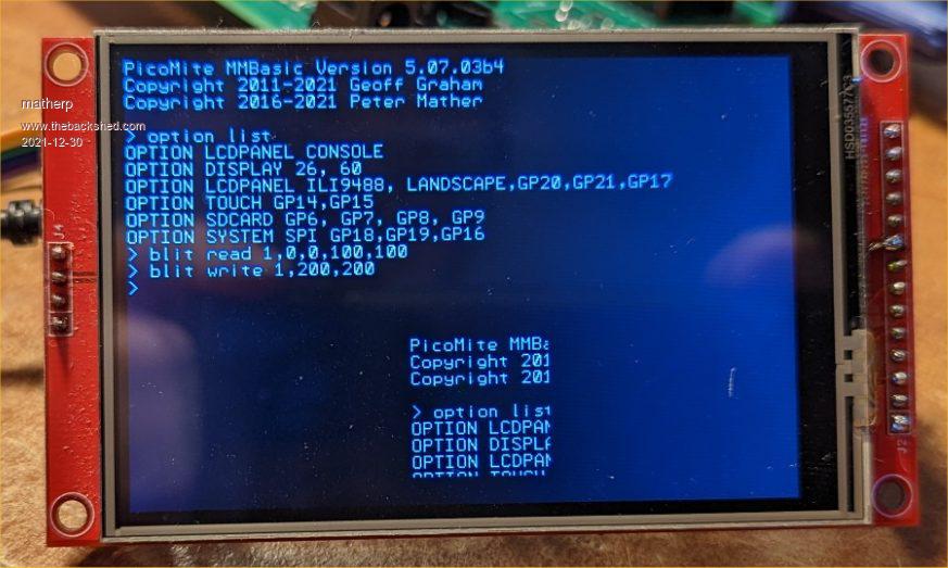

Posted: 04:29pm 29 Dec 2021
BLIT READ works perfectly on the ILI9488 with the latest firmware IFF MISO is connected
Edited 2021-12-30 02:34 by matherp

  matherp said  BLIT READ works perfectly on the ILI9488 with the latest firmware IFF MISO is connected
Yes, and thanks, but if I understand correctly, that's because the SD card and any other SPI devices are on different pins.
I think Turbo46 is talking about whether an inline 1K resistor on the ILI9488 MISO pin would allow it to function on the same MISO, MOSI, & CLK pins as the SD card without corruption.
That's what I'm not sure can be fully tested with either the new or the older firmware.

  Quote  That's what I'm not sure can be fully tested with either the new or the older firmware.
Of course it can. Connect it and see it it works with the SDcard on the System SPI
