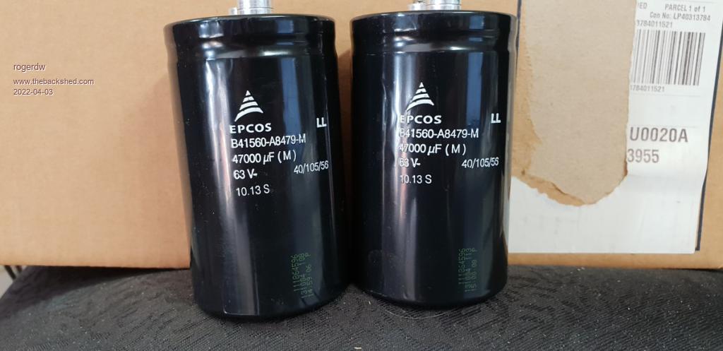

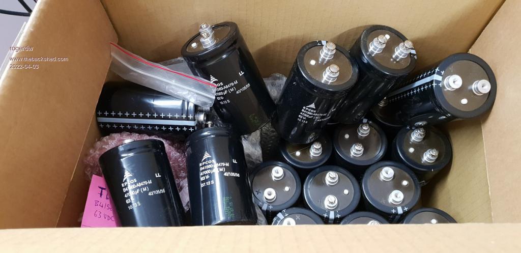

  Quote  Yes capacitors are expensive and the warpverter needs lots of capacitance, especially for longevity! I'd suggest a film capacitor across the supply right at the IGBT screw terminal pair. Similar to the film cap across the original aerosharp IGBT module.
I do recall Tony suggesting the 150,000uF value that Klaus just mentioned  ...  and have been looking at some 100V ones from element14.
I do have a box full of 47,000uF 63V Epcos caps  ...  but I assume I really need a higher voltage. Thoughts?
I might have to spend some time researching film capacitors too.
Cheers,  Roger

Hi Roger,
Nice to have a box full of what look new capacitors. 63V is cutting it a bit fine my charging set up goes to 56V bulk charging.
However, you could connect two of these capacitors in series (with a high value bleed resistor across each to keep them at equal potential) and then connect those series pairs in parallel. It looks like you have about 12 Caps so 6 pairs would give you sufficient capacitance. I suggest you make a separate PCB (or mount them on alu busbars) so you can easily disconnect them for inverter trouble shooting.

Those  47,000uF 63V Epcos caps should be ok, their spec has a surge voltage of 1.15 x 63v; the max voltage you can place across them is your battery bank, so if that doesn't exceed 63v they should work fine. Their max voltage is also temperature dependent, if they run cool then you will be good to go.
If they were some no-name Aliexpress with dodgy fake labels then the situation would be different...
Mike

  Murphy's friend said  Hi Roger,
Yes, I found them for sale on Facebook Marketplace a year ago and couldn't pass them up. There's 24 in the box  ...  $200 for the lot!
  Quote  However, you could connect two of these capacitors in series (with a high value bleed resistor across each to keep them at equal potential) and then connect those series pairs in parallel. It looks like you have about 12 Caps so 6 pairs would give you sufficient capacitance. I suggest you make a separate PCB (or mount them on alu busbars) so you can easily disconnect them for inverter trouble shooting.
I did wonder about doing that  ...  but they're big and that ends up taking a lot of room.

  Solar Mike said  Those  47,000uF 63V Epcos caps should be ok, their spec has a surge voltage of 1.15 x 63v; the max voltage you can place across them is your battery bank, so if that doesn't exceed 63v they should work fine. Their max voltage is also temperature dependent, if they run cool then you will be good to go.
That's encouraging thanks Mike  ...  though if there's any doubt, I'd rather invest a few more dollars and build in some more head room. The brand certainly caught my attention when I saw them for sale, so was really happy to score them on the off chance I'd find a use for them somewhere.
I do recall nickskethisniks had some issues with some electros failing because they were too close to the limits and perhaps not so good a quality.
Cheers,  Roger

  rogerdw said  I do have a box full of 47,000uF 63V Epcos caps  ...
Hi Roger.
Great find.
By any chance you would consider selling 2 or 3 of them would you?
Brian
