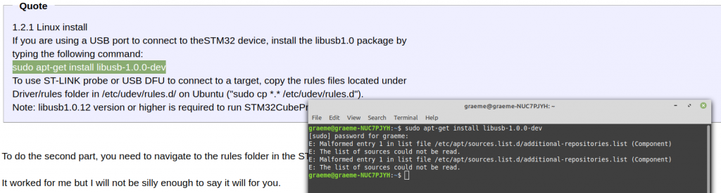

As a last resort, I did a RTFM
  Quote  1.2.1 Linux install
If you are using a USB port to connect to theSTM32 device, install the libusb1.0 package by
typing the following command:
sudo apt-get install libusb-1.0.0-dev
To use ST-LINK probe or USB DFU to connect to a target, copy the rules files located under
Driver/rules folder in /etc/udev/rules.d/ on Ubuntu ("sudo cp *.* /etc/udev/rules.d").
Note: libusb1.0.12 version or higher is required to run STM32CubeProgrammer.
To do the second part, you need to navigate to the rules folder in the STM installation first.
It worked for me but I will not be silly enough to say it will for you.

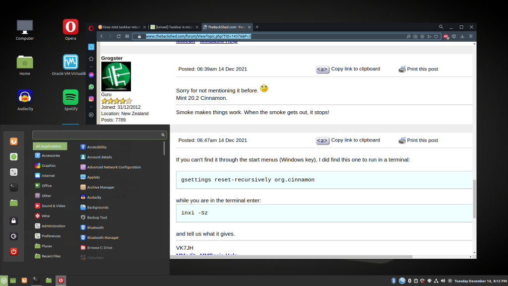

Posted: 06:47am 14 Dec 2021
If you can't find it through the start menus (Windows key), I did find this one to run in a terminal:
gsettings reset-recursively org.cinnamon
while you are in the terminal enter:
inxi -Sz
and tell us what it gives.

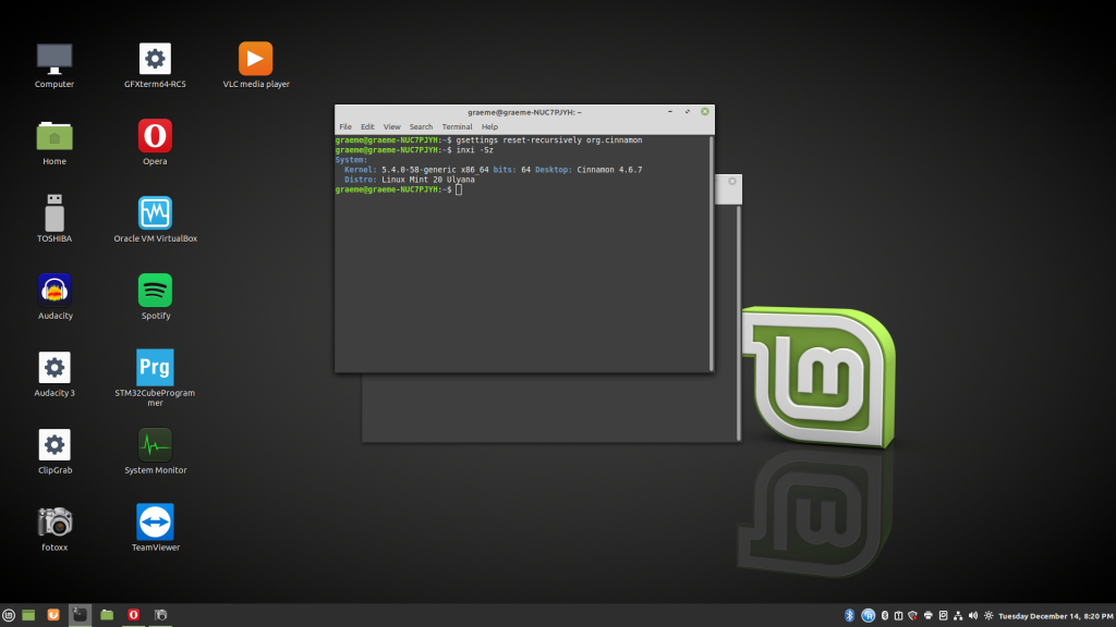

OK, results of the inxi -Sz:

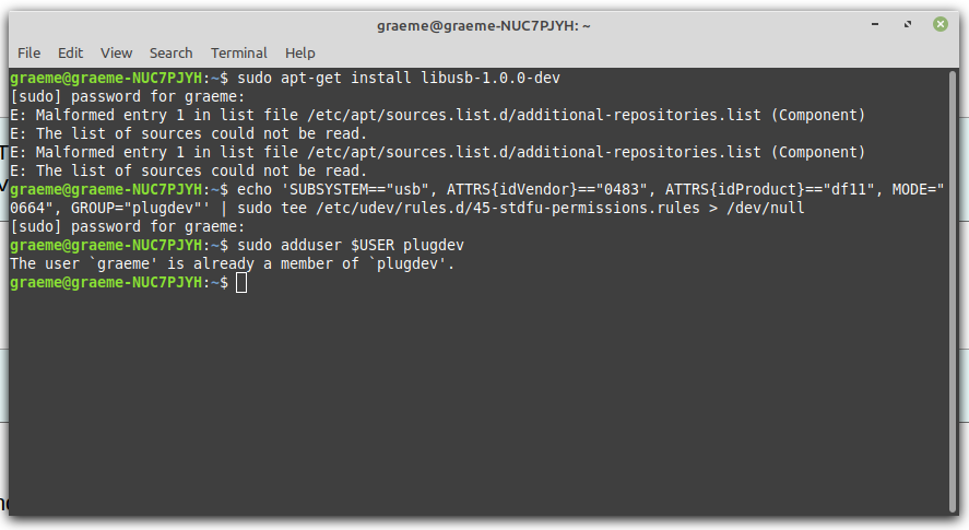

Posted: 05:29am 15 Dec 2021
hi grogster,
   have you done BOTH of:
echo 'SUBSYSTEM=="usb", ATTRS{idVendor}=="0483", ATTRS{idProduct}=="df11", MODE="0664", GROUP="plugdev"' | sudo tee /etc/udev/rules.d/45-stdfu-permissions.rules > /dev/null
(as a single line), AND:
sudo adduser $USER plugdev
just cut (from this message) and paste each of the lines into a command terminal. both are CASE SENSITIVE, and both will prompt for your password.
the purpose of the first line is to create a file called /etc/udev/rules.d/45-stdfu-permissions.rules containing the one line of text: SUBSYSTEM=="usb", ATTRS{idVendor}=="0483", ATTRS{idProduct}=="df11", MODE="0664", GROUP="plugdev"
this allows access to the VDI/PID 0483:df11.
rob   :-)

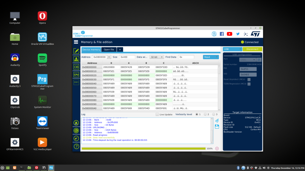

Posted: 11:18pm 15 Dec 2021
WORKING!!!!
Rob's commands made things work.
...and then - YAY!
