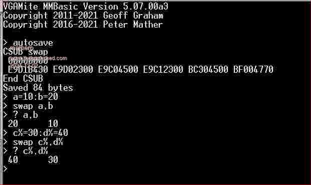

Posted: 05:37pm 01 Dec 2021
411VGAV5.07.00a3.zip
CSUB swap
00000000
E9D1B430 E9D02300 E9C04500 E9C12300 BC304500 BF004770
End CSUB
Also you can now use the command UPDATE FIRMWARE to put the processor into bootloader mode. I then updated the firmware over the serial console - worked very nicely. This will allow the "boxed" VGAMite to be updated
