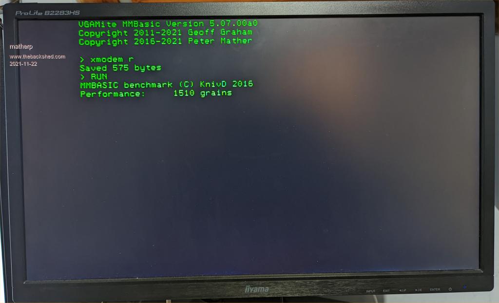

Progress
Posted: 11:43pm 21 Nov 2021
Bravo. Compared to Picomite:

Posts: 4410
Posted: 09:35am 22 Nov 2021
We should definitely promote mispronouncing the name and calling it the "VeGAmite".
Peter, I suspect I have misunderstood but in an earlier post you said "this port will not use USB", does that mean it will have no serial console (so no AUTOSAVE or XMODEM ?) and no SD card ... how are we supposed to transfer software to this except by banging it out at the keyboard ?
  "Mixtel90" said  Just musing: the pcb should perhaps have a link to allow the user to select green, amber or white phosphor display by selecting suitable resistors. I wonder if the VGA routine could produce scan lines? Hmmm... Perhaps that's going a bit too far.
Neither sounds like going to far to me, sounds cool if it is "easy".
Edited 2021-11-22 19:37 by thwill
Posted: 10:18am 22 Nov 2021
  Quote  Peter, I suspect I have misunderstood but in an earlier post you said "this port will not use USB", does that mean it will have no serial console (so no AUTOSAVE or XMODEM ?) and no SD card ... how are we supposed to transfer software to this except by banging it out at the keyboard ?
Did you look at the picture?
It will have a standard serial console on a uart. The USB is not usable because the chip can't generate the 48MHz clock needed for USB at the same time as the 25.175MHz clock needed for VGA. Only the H series chips have multiple clocks that allow this (like on the CMM2)
