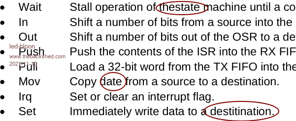

led-bloon
Joined: 21/12/2014
Posts: 210
Posted: 09:47pm 09 Nov 2021
Couple more in same paragraph (area) of text
led
