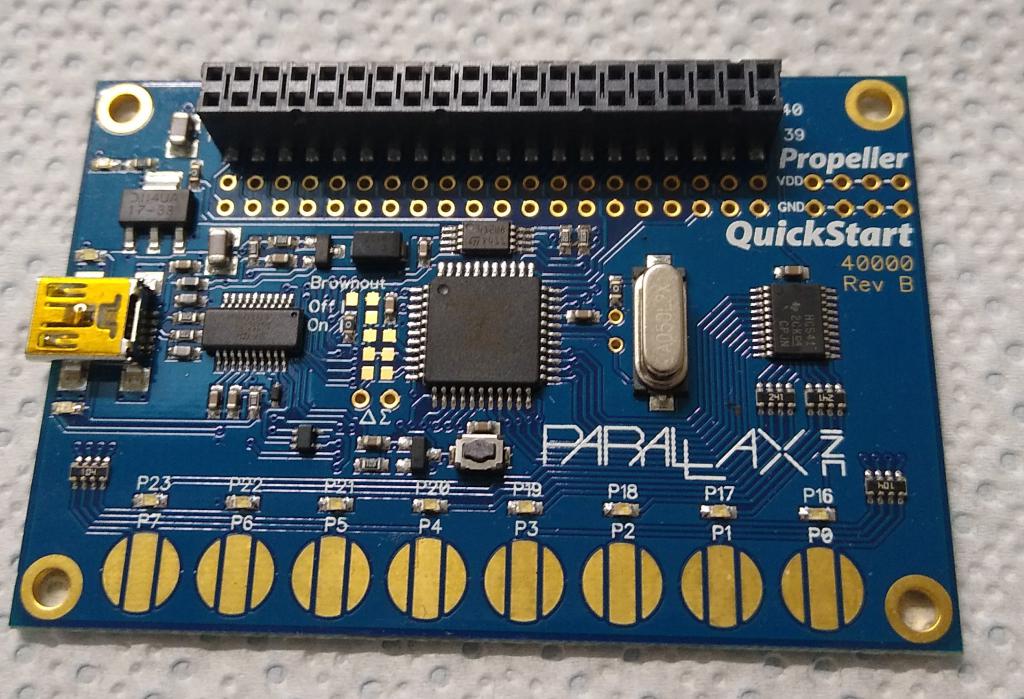

This one. It even has touch pads. There is absolutely no difference when it comes to programming until you decide that something is slowing your main loop. Just launch that particular function in a "Cog" and share variables.
Absolute child's play
