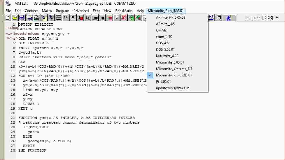

  palcal said  You have to download this file and put it in the MMEdit folder in 'Program Files'
File

Greenhorn question..
I'm trying to load a simple program into a picomite running b4. It has nothing connected (no SD Card or LCD etc) after loading the program I get;
"ERROR: SDcard not configured"
Failed to start
Saving program
Can I run a pico without an SD card and if so what do I need to do so that I don't get that error. (I haven't successfully loaded any programs into a Pico yet. I have only ever been using micromites.)
Posted: 06:44am 22 Jul 2021
  Quote  Can I run a pico without an SD card
Yes
  Quote  I'm trying to load a simple program into a picomite running b4
More information needed. How are you trying to load the program? If your are using MMEdit you have got the protocol wrong (don't use CMM2 or CMM)
Edited 2021-07-22 18:31 by matherp
Glen0
Joined: 12/10/2014
Posts: 102
Posted: 08:34am 22 Jul 2021
Connected with MMEdit and I'm just trying to do a simple A/D conversion on pin 31 and print it to MM Chat.
Glen0
Joined: 12/10/2014
Posts: 102
Posted: 08:37am 22 Jul 2021
Sorry, Just re-read your reply and realised I am using the CMM 2 Chat.
I will see what other options there are.
Posted: 08:40am 22 Jul 2021
On the dropdown in MMEDit choose Micromite+
Glen0
