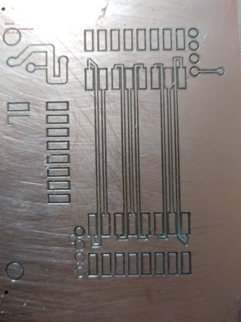

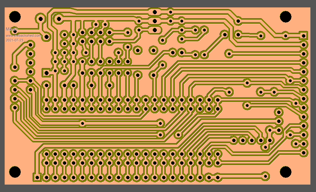

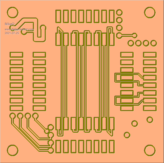

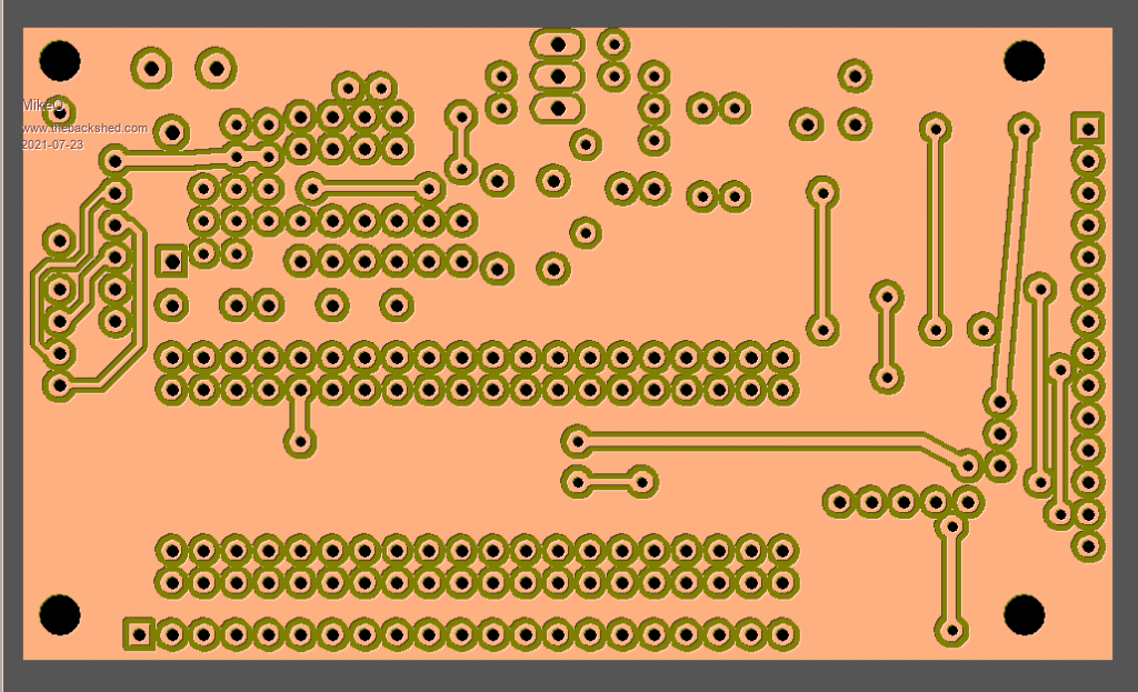

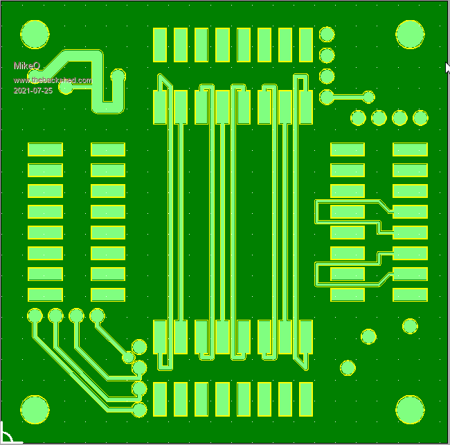

Going to try isolation milling version of this board today.
I have used CopperCam to process the gerbers into nc files ready for milling on the cnc.
I have attached images of the copper representations (good for spotting problem areas)
I will post the result when done. Thanks to Mixtel90 and Vegipete for their work. Mike

Although never originally intended to be milled, it looks like a pretty good design for it. :)

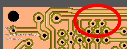

Looks neat in virtually milled copper. Should be easy enough to deal with non-plated through holes.

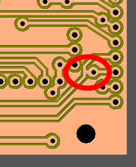

I notice a 'milling error' near the bottom right of the (mirrored) bottom layer:

Hey your right, thanks I will look at that.

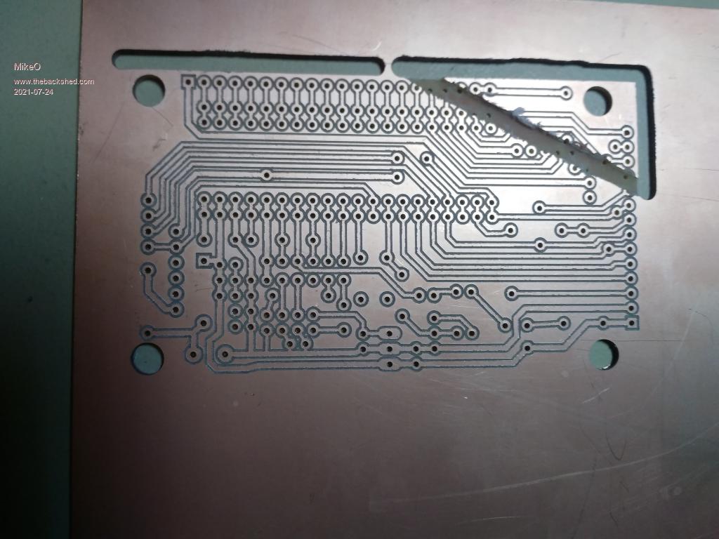

I am just at the moment making a new Jig and hopefully a workable "procedure" to deal with the usual problem I have of milling the other side which is always a problem. However I did actually a very successful run yesterday as far as the milling was concerned, ignoring the screw up!. Actually that error you noticed is right under that wayward board cutout move! I have attached a photo. More runs hopefully today.

AAAAARRRRGGGHHH!!!!
One of those moments when impolite words pass your lips and you run the risk of not being allowed into Heaven.  :(
The milling looks nice though.

@mikeO,
Check your milling, the IO0 and IO1 on the ESP8266 are shorted to the nearby trace.

  Volhout said  IO0 and IO1 on the ESP8266 are shorted to the nearby trace.
Well spotted, I didn't see 'em. Those would be a short to ground.

Yes I spotted that myself this morning, then I saw your post. Actually I was able to manipulate the relevant track width and the adjacent pads a little in CopperCam to deal with the transgression!

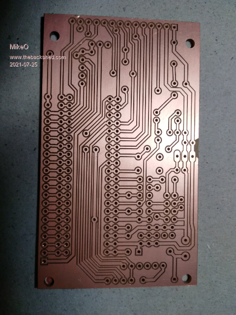

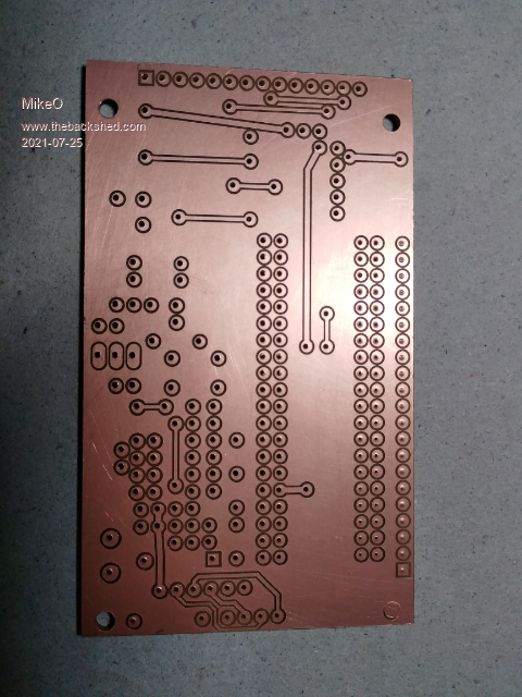

Here is the finished PCB, it has turned out really well so I am very happy with the effort put in and confident I have put some consistency into my process.
Thanks again to Mick and Vegipete for the design and Gerbers. Just have to populate and test it tomorrow. Mike
PS the small damaged portion on the first board (RHS) is just where the hold-down tab was and I was not careful enough when removing the board from the jig.

For drills I usually use 0.6mm for Vias and most surface mount components. For connectors, dips etc I use 0.9mm. Mounting points 3mm. I try to limit the drill sizes if its just the odd one you can always just open them up a bit manually.
For engraving I use a 3.175mm V engraving bit, 35 degrees. I cut 0.9mm deep and run at ~ 24000 rpm. I have found that a fine spray of WD40 on the top of the board when you start off helps to keep the cuts clean. The other really beneficial addition if your system allows it is surface level compensation , I don't think I could support the depth of cut I use without it.

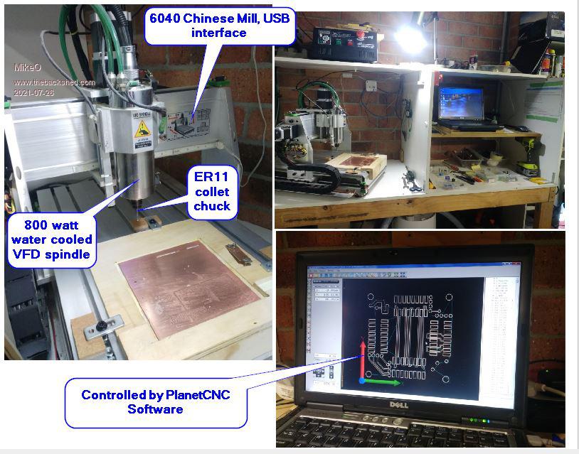

      Sorry I did not intend to hijack this thread but a couple of you have mentioned they would be keen to hear of my experiences I can share, so here goes.
      My Milling system which I have had several years was not particularly cheap but I paid more to ensure I got a unit with a heavier construction like 20mm support shafts and helical drive rods. The original unit had a parallel interface which has since been updated to USB. Apart from PCB milling I have produced items in wood and plastic (mostly acrylic and HDPE), I have done very little metal milling work with this mill.
      I have had mixed success previously milling PCBs , I could usually get reasonable milling results as long as I stuck to the things I knew to work and took no short cuts. the biggest problem area I had was having a simple and reliable method to deal with double sided board alignment. With this last board I did I was determined to try and solve this dilemma. I will get to the seemingly simple solution in a moment but first I will just list the hardware and software tools I use.
      1. Chinese 6040 mill, PlanetCNC (Lic) USB controller and software.
      2. General cad work I use CamBam (Lic). Use this for board cutout when doing PCBs.
      3. PCB design I use DipTrace (free), I am use to this product, works for me.
      4. PCB Gcode I use CopperCam (Lic), I can also export gerbers directly from Diptrace into PlanetCNC but the CopperCam gives a lot more flexibility including  origin alignment options. FlatCam would be the other contender (free) I have tried some time ago, always seemed complicated but the most recent looks more streamlined.

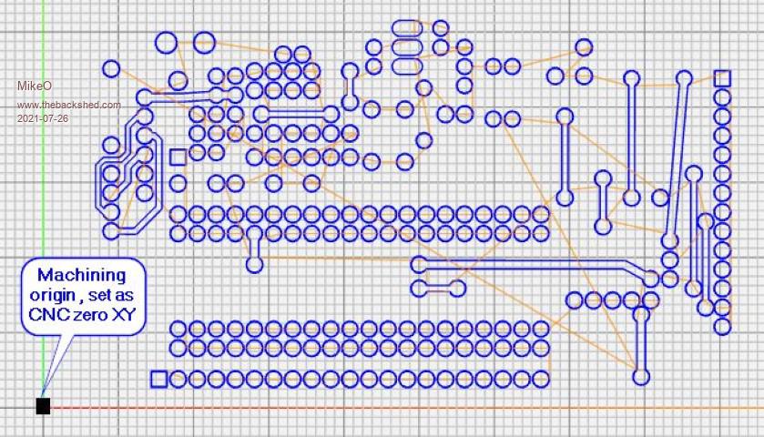

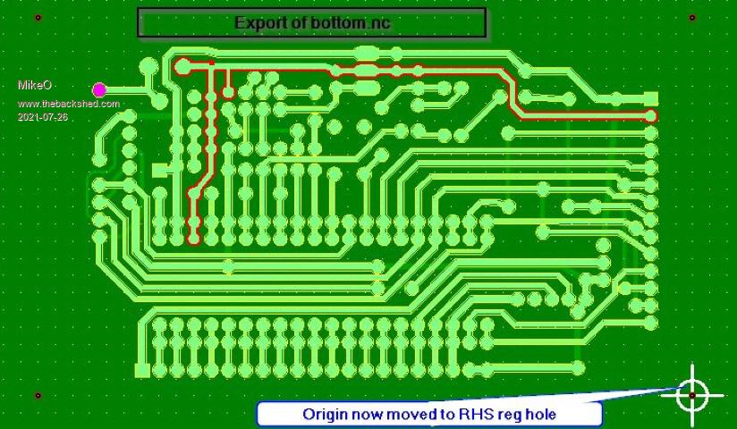

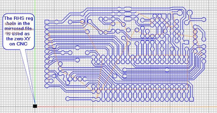

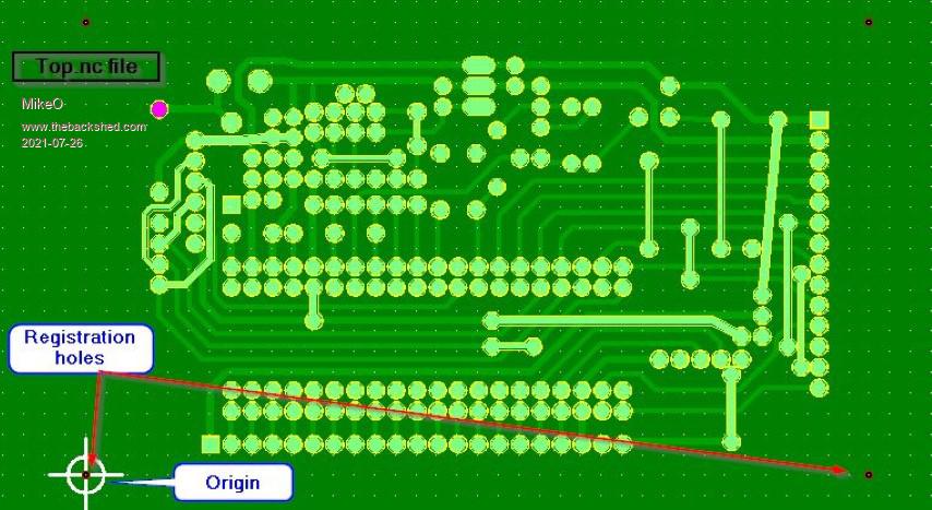

      This time I wanted to try and address the double sided alignment issue. I came across a jig where you milled a xy straight edge on a base board that was reliably located by the addition wood strip against the tables front edge. This meant in future the jig could be reliably remounted with a milled xy edge for the pcb blank to locate on.
      Secondly instead of using the usual registration method of pins through the pcb into the base board to allow the board to be turned over and located again I used 0.6mm drilled holes at the bottom of the pcb. These can be created in CopperCam in my case other wise they would have to be created by the pcb design software as they need to be registered as machining origins in the gerbers.
These photos show the process.
      Create the Top and Bottom nc files using the left and right reg hole as origins respectively.
      On the CNC with the Top.nc you use the zero XY as set. Then when you flip the board over you need to align the zero XY to the LH reg hole (actually the RHS reg hole in the bottom.nc file)
