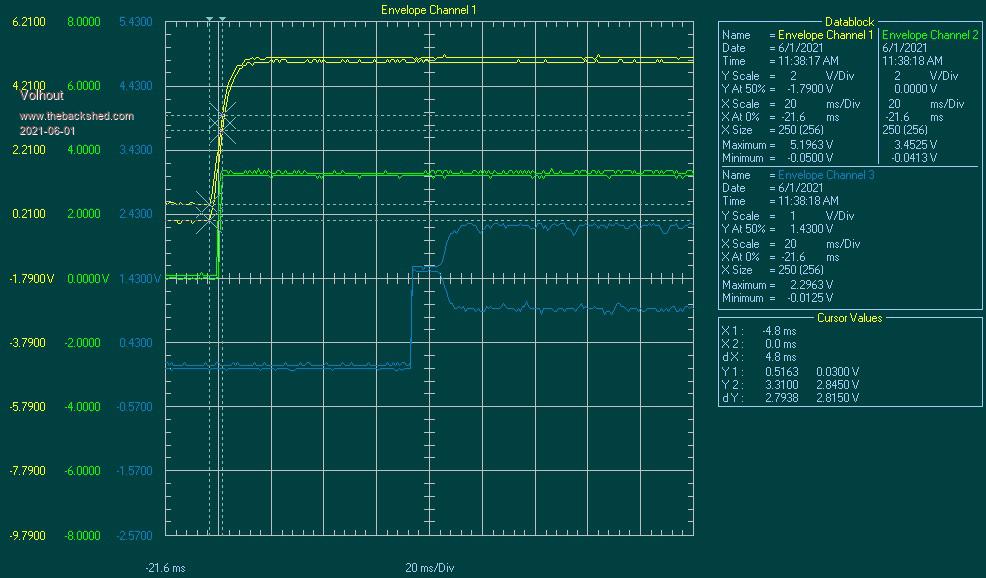

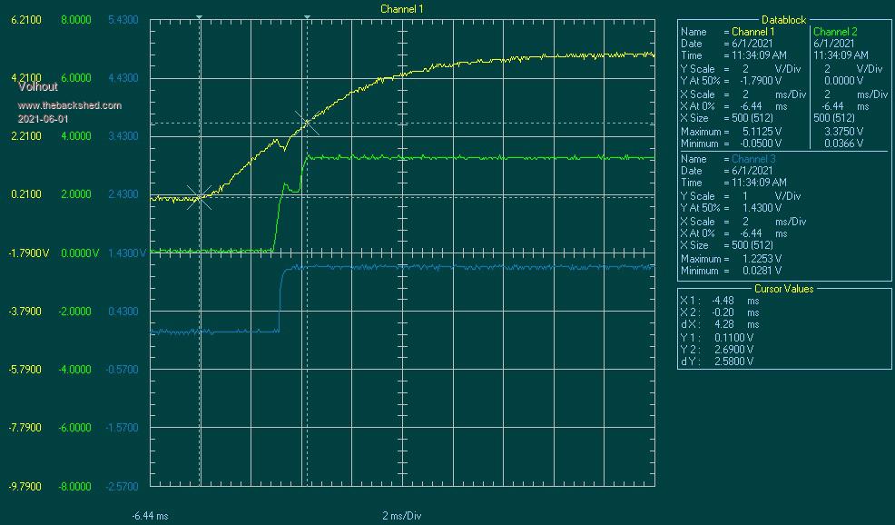

@mixtel90
Power up (yellow=5V, green = 3.3V blue = 1.1V)
Voltages are stable in miliseconds.
The dip in the 5V is caused by the current limitter of the 5V supply (set to 200mA). A capable charger will not product such a voltage dip.
Tested the crystal oscillator startup on both boards 9thye good, and the faulty).
Please note the scope is in envelope mode, otherwise you would see aliasing in the crystal.
Both boards enable the crystal oscillator after 75ms. Then within 12ms the crystal oscillator produces a stable waveform.
The bad unit
The good unit
If it is caused by the crystal oscillator, it is very critical since the boards are not behaving very different.
Posts: 9329
Posted: 10:59am 01 Jun 2021
Nope... I doubt if there's any difference that wouldn't be ordinary component tolerances - and pretty close at that.

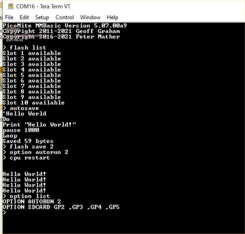

Posts: 9329
Posted: 02:21pm 01 Jun 2021
Just tried
'Hello World
Print "Hello World!"
pause 1000
Loop
in flash slot 2
Then OPTION AUTORUN 2
Power cycle or temporarily ground RUN pin
Starts up
Prints header
Prints a space and the prompt.
There is no prog in editor.
OPTION AUTORUN has reset
Same problem if the comment is removed
FLASH LIST is lovely. :)
Edit:
Incidentally, the RUN pin is very sensitive. The on-chip pullup seems to be high (probably around 50k) so just touching the pin with a short length of insulated wire would cause a reset. This might be something to watch out for, particularly if you haven't got your Pico on a breadboard.
Edited 2021-06-02 00:42 by Mixtel90

Posted: 03:30pm 01 Jun 2021
  Quote  Starts up
Prints header
That will teach me to move some code after testing something
