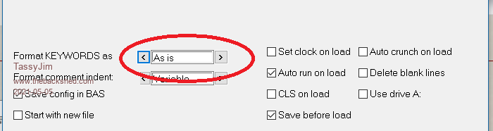

One thing you can do is set "Format Keyword Case" to "As is" in Preferences.

Just checked the "Format KEYWORDS as" setting - it is "As is" !
( When saving a file the cursor does much flickering between the mouse pointer and the hour-glass symbol - just like a manual crunch does - your MERGE and CRUNCH in action.)

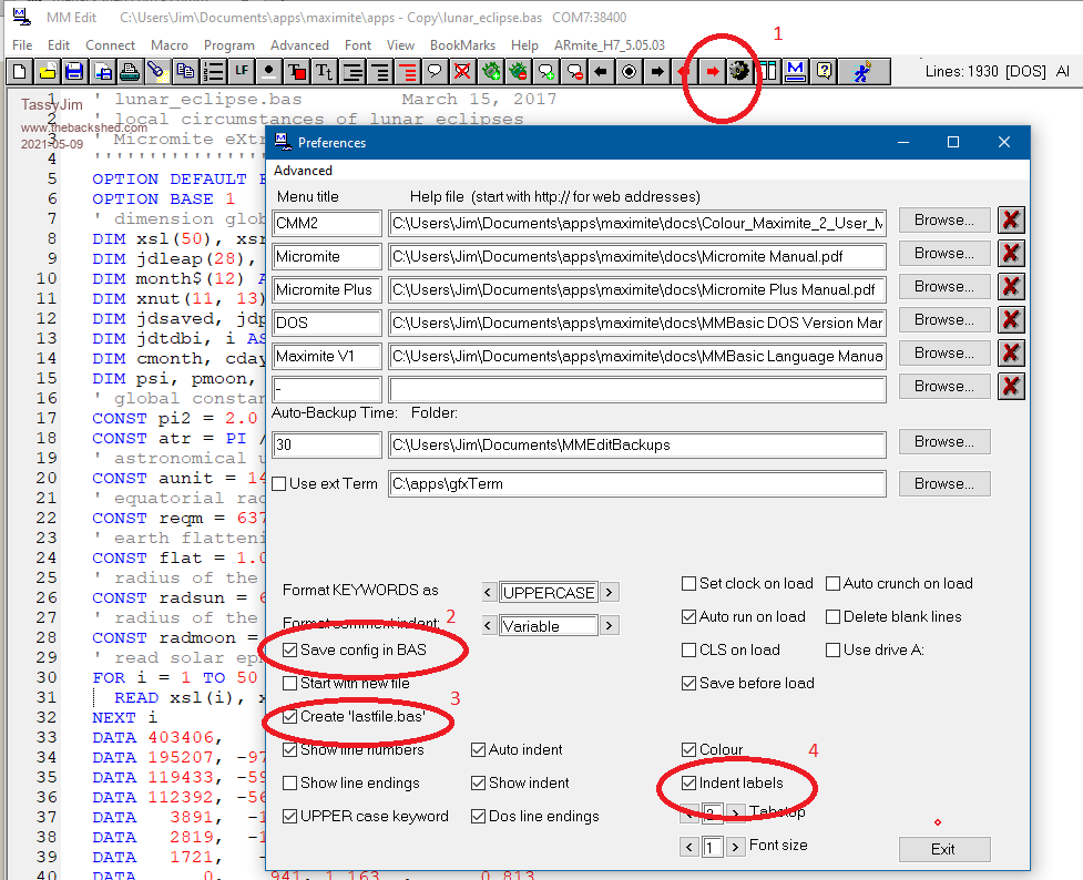

Posted: 07:18am 06 May 2021
Paul,
I have updated the version on MMEdit on my website.
It would be interesting to see if there is much improvement in the saving and loading speeds.
There is  a new option in Preferences - create 'lastfile.bas'.
If you don't make use of that feature, leave it unselected.

Paul,
Thanks for the timing data.
It is obvious that the delay on loading is between markers 4 and 5
Referring to the above image.
Item 1. The right arrow toolbar button is the one to go to a selected subroutine. If you don't have any sub highlighted, it will instead open a window with the full list of subroutines/functions. It is a function I use a lot but does need to scan the full file each time so will be slow for large files.
The rest are preferences which need resetting after the version change.
Item 2. Unselect this and it might make a big difference to loading times. Either way, I will know a bit more about where the holdup is after you remove that option.
Item 3. This is the one that was causing the slow saving. Keep that unselected.
Item 4. This is the one that controls the initial indent. Select it to have the formatting back the way you liked it.
