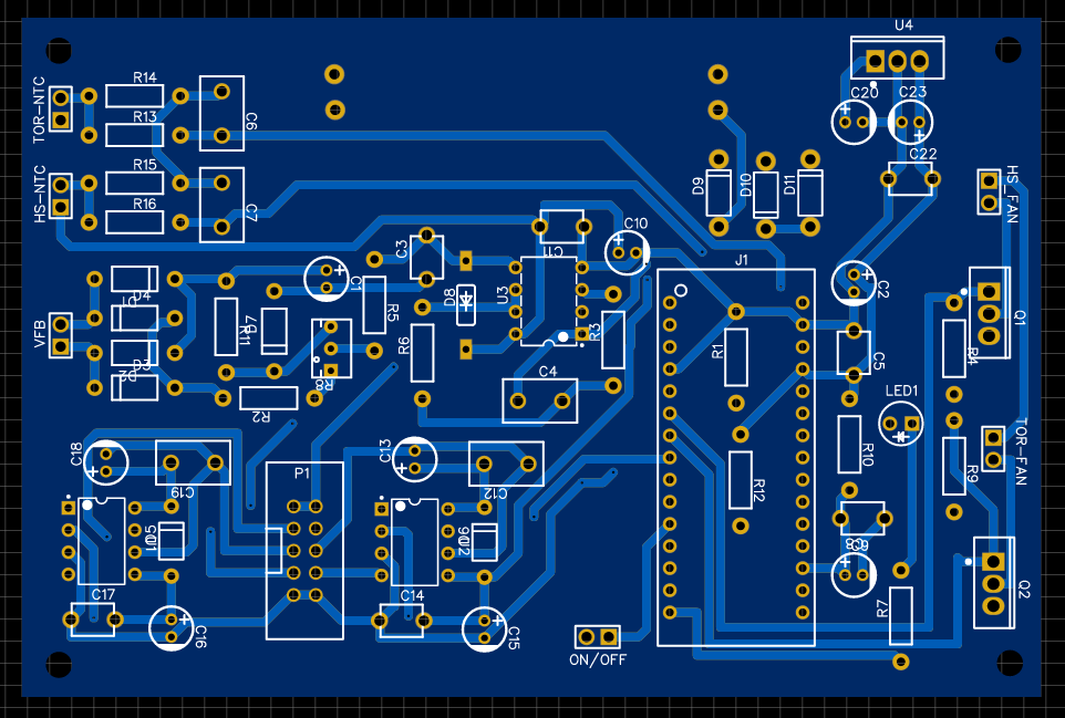

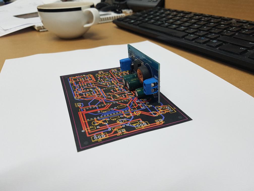

picoverter so far:
I intend to stand the dc-dc converter on it's edge and hold it in place
with 4 solid copper wires. Strong as need be.
The board is only 75mm x 115mm approx.
here is the schematic
The dc-dc converter takes the 48V battery (46 - 56V) and makes 15V at about 1 Amp.
1 amp is needed when both fans are running.
I use 3 diodes in series to drop the 15V to about 12V sort of ish and that
is good enough for the fans. Saves using a 7812 regulator and more caps.
This is based heavily on TinyT's work on the nanoverter.

Posted: 05:10am 20 Apr 2021
Hi Peter, good work!
Just 2 remarks.
Try to draw all horizontal lines with 1 color and do the vertical in the other color (top or bottom) that way you will always be able to cross your traces. I only started recently with that, important when things get bigger and messier...
It's always good to avoid 90degree corners, I thought it was difficult to do sharp corners for the manufacturer.

  nickskethisniks said  Hi Peter, good work!
Just 2 remarks.
And another tip for PCB layout for the home designer.
Try to make the component pads as big as possible, I find those in the PCB program libraries useless for home soldering - unnecessarily small.
Make the pads for connectors rectangular (with rounded corners perhaps), you get maximum surface are which will be appreciated if that part ever has to be unsoldered.
Ditto for IC sockets.
I usually make component pads (resistors, etc,) square for the same maximum surface reason.
Double check all component pin diameters so they fit easily through the pad hole but also are not too loose so the component falls out when you turn the board over to solder the legs.
The manufacturer will make track corners anyway you like, I see nothing wrong with 90 degrees. But the track separation in the above PCB is unnecessarily close, IMO, at some parallel tracks.

Posted: 11:53am 20 Apr 2021
It's different for me. EasyEDA and JCLPCB produce boards I find easy
to solder and rework so I'm fine with the library parts.
This PCB was the result of spare time at work today. I chose to do it with 1mm
track widths to make it hard to layout, as an exercise.
No tracks went between 0.1" pins of the Nano or ICs.
Probably only need 0.5mm track widths or less.
It's not a big deal to rework the PCB. Something to do at work...
Thanks for your advice tho.

Peter, I can see the progress you are making with the PCB design, its certainly faster than my software progress......
A couple of small critiques that jumped out at me, C2 & C10 have the two + & - tracks too close, they should have more clearance. Maybe they would benefit from a 90 degree clockwise rotation, but this is without the benefit of seeing underneath - maybe there was a constraint. The negative track on C15 & 19 also bends too close to the + terminal, just extend from the capacitor before the 45 degree bend.
Lastly a few tracks seem very close to other tracks and I am not convinced they need to be that close. Reasonable clearances for manufacture should be maintained etching pcbs is not a perfect art and you can assist to get a better result without microscopic shorts.
Cheers Mike

Thanks everyone for your thoughts on the PCB.
I will take notice of all you have written.
It is clear I need to rework it with some care for
good clearances of tracks.
Working current levels are only about 100mA so I do not need
1mm wide tracks as well. A bit of care might bring the ground, 5V and VBAT (50V)
tracks down to a smaller length but retain 1mm width. All the signal and decoupling
lines could be 0.25mm or something.
When laying out the above board, I found it easy to first route
small parts of the board in a location well separated from the PCB
then move the completed section into place on
the PCB.
This makes the large job a collection of easier to tackle smaller tasks.
