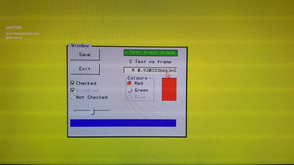

Sure thing Captain. Here is a screen grab showing the correct checked boxes and incorrect unchecked state, where you can see the small white square is not centered in the frame. Adding +2 to the x,y values inside Case 3 of GuiObjDraw fixes this on my CMM2. Maybe I futzed around and broke this at some point. I no longer have a 'virgin' copy of the code I originally downloaded and with the updates on the Wiki page changing between some lines combined by using colons and then not...it's more difficult to compare from one version to the next to see what's changed....not to mention my own 'CMM2' customizations! I'm pretty sure it was this way when I first got this to run on my machine....but...memory is a funny thing...
Steve
Posted: 02:27pm 06 Apr 2021
yes the code that was "released" standardized the function names etc and I colon-ised some of the lines with common task i.e. drawing boxes etc. to save a little bit of space - it's not a problem for big boys toys but most of my work is on the minuscule '170 with just 60K of precious program space.

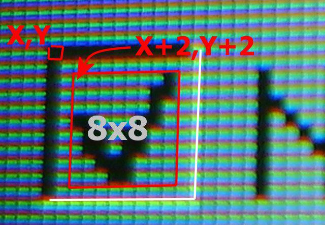

I have just notice something else with the CMM2 GUI Bitmap work-a-like, the tick in the disabled checkbox should be grey (same as the writing). The colour is switched appropriately in GUIObjDraw.
On the subject of the grey box, yes I can see clearly it is shifted up and left. I think the CMM2 switch in GUI bitmap needs investigating - if the bitmap is right for the tick, but wrong for the grey box,  co-ordinates are co-ordinates.
The GUI Bitmap (native to non CMM2 MMBasic) does the positioning correctly:
so the mis-location must be in the emulation but why only for the blanking effect?
the native version (below that) does indeed use the +2 offset as you mentioned and as is shown in the close-up
EDIT: I am going to move the two Local defs inside the IF to streamline and save some RAM - only going to matter of the micromite and functionally the same... so...

Running the current version V0.64 on a CMM2 I get
CMM2 doesn't have BACKLIGHT so I moved that line into the SELECT CASE block.
Case Else
   Backlight 80' 100 is off
End Select
The checkbox offsets are obvious so I removed the +2 from the GUI BITMAP lines and re-inserted them in the main loop where you call gui_bitmap. That way both methods have the same offset.
Next issue is the not-grey in the disabled tickbox.
This was fixed in the gui_bitmap sub
(if you don't specify a colour, the already set colour is sued, which is what we want)
For dx=0 To 7 : if Val(Mid$(cbin$,dy*8+dx+1,1)) then pixel x+dx,y+7-dy

One issue I have. The tickbox can get the tick added with a click but it cannot get removed.
Posted: 09:43am 07 Apr 2021
Nice work Jim.
With regards the tick removal, if I understand you right, the tick doesn't get erased(?).
if o=0 you could simply draw a filled box in CGy to erase the tick, so...

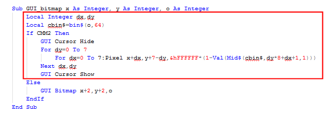

small point, it should be GUI BITMAP x+2,y+2,o - see the closeup pic further up this thread

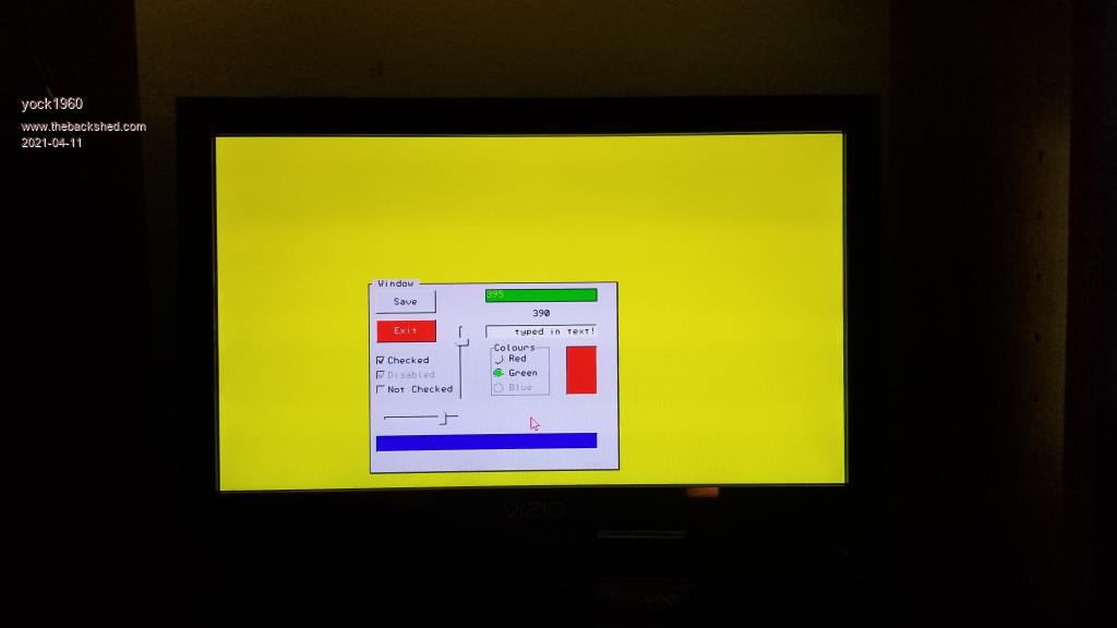

Still futzing around with this. I've added vertical sliders and I suppose I will eventually add the ability to specify which way the pointer points. This is probably too 'expensive' for non CMM2 hardware, but it's nice to have the option and doing this helps to better understand how everything works. And before the question is asked....I'm not planning on 'forking' CaptainBoing's Wiki page for a CMM2 version....more than I want to do!
Steve
gui_demo_6.zip
Posted: 06:37am 11 Apr 2021
see? that's nice - vertical slider - never occurred to me.
one point, I think H & V should really follow the same mechanism as progress bars for alignment otherwise we have inconsistency in specifying orientation, but it is entirely down to how you want to grow your own code. I will lift your vertical slider section of code and tweak it and include it in the next version.
Good work
see the Border type and alignment section
as an aside, I think if you right-click the mouse it will grab the screen for you rather than having to take a photo - jus' sayin'
Edited 2021-04-11 19:15 by CaptainBoing

DOH! Yes, much better than a photo! Getting rid of the H/V would be better, but as sliders don't have a border...I didn't have another idea there. It is a bit fiddly getting the desired result into linked objects, as they way the code works in ProcessTouch, up ends up low and vice-versa. There's probably a way around this...but I was unable to figure it out!
I'm currently working on the demo code that allows input into a textbox...trying to develop a general 'method' as it were. Trying to constrain text to the box dimensions is proving to be obstinate...perhaps I was just sleepy...dim witted is more likely!
