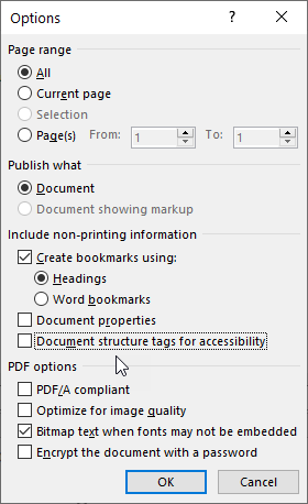

Just a note to record the Options used to export to PDF from word2016 so that bookmarks are created
Edited 2021-05-22 16:28 by disco4now

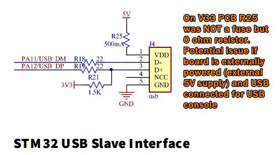

Possible warning for powering board via external 5V and using USB console:
On V33 PCB R25 was NOT a fuse (as shown on schematic) but 0 ohm resistor.
This is a potential issue if board is externally powered (external 5V supply) and USB connected for USB console!
PCB should have had Schottky diode to isolate USB 5V power from PCB 5V supply rail? (This is a similar issue for STM "Blue Pill" boards that was fixed in "Black Pill" revisions)
Any suggestions for dealing with this?
1. Remove R25 - but means that board cannot be powered by USB
2. Remove R25 and solder a Schottky diode in its place (anyone have a part # that will fit here?)
3. Use USB isolator?
4. Forget about USB console and use Serial Console on 4-pin USART1 header. This would avoid having to modify the board but will require USB to serial converter.
Edited 2021-05-30 06:57 by flasherror
Nuts... After I posted I found that the issue is mostly discussed on Page 22 of Draft 3. However I would include Option 4 (use serial console instead of USB console if powering the board using external 5V power) in this section as I think it might be the easiest option.

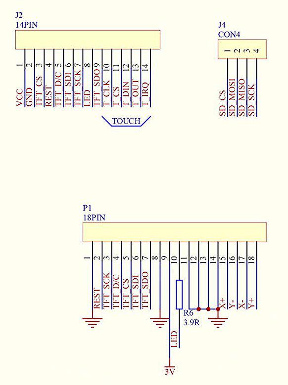

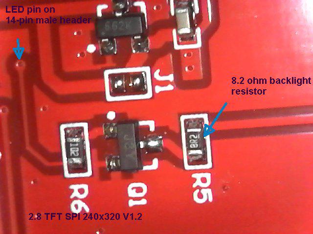

  flasherror said
For ILI9341 2.8 (same one shown on P47), do you really need a LED backlight resistor if not using PWM to control the backlight? That is, can you directly connect LED pin to 5V. The schematics look like the LED has a 3.9 ohm resistor so no external resistor might be necessary? (despite what P48 of Draft 3 says)
I did some investigating for my 2.8" SPI display (labelled 2.8 TFT SPI 240x320 V1.2). This is the one (red board display) that is pictured on the Armmite F4 manual.
The above is a photo of v1.1 but it looks the same as V1.2
I think there may be a difference in backlight driver between previous V1.0 PCB revisions and newer ones.
The only schematic I can find shows that the LED (anode) pin connects to the relevant display pin through a 3.9 ohm resistor. I do not actually have a V1.0 or V1.1 display PCB to check so I presume this is for pre-V1.1 displays. See image below:
But, for V1.2 of this display board, the LED pin drives a transistor which in turn drives the backlight through a 8.2 ohm resistor. This means that since the LED pin drives a transistor (with its own 1K base drive resistor) there does not need to be a current limiting resistor for the LED pin for V1.2 displays. Of course the presence of a resistor would not hurt anything but if I'm right V1.2 doesn't need the external resistor. Also, the backlight would probably be able to be driven directly from an I/O pin, no external driver transistor needed. See PCB image below (had to break out the digital microscope for this one):
The original Micromite manual and Armmite F4 manuals indicate that this resistor is required, but this might have been because the earlier display version required one.
The change in LED backlight circuitry means that V1.2 Backlight LED Anode voltage seems to from the VCC pin (haven't traced the circuit). Not sure if backlight will operate brightly if display is powered from 3.3V (and jumper J1 is shorted to bypass the onboard 3.3V regulator)
I cannot find a schematic for V1.2 of this board, anyone have one? I would like to confirm the backlight circuit in V1.2 displays.
Edited 2021-06-01 00:46 by flasherror
