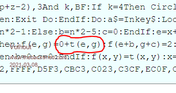

I had to fire up my original Colour Maximite to give it a test. Wow! That's pretty awesome! I wrote a Sokoban clone for the CMM2 a while back and it took me considerably more than 10 lines to do it, so I had to see what cool tricks you used. Your legal move evaluator algorithm is way more elegant than mine. I have discovered thought that I can cheat and stand on the last target instead of pushing the last block in to place.
Posted: 09:32pm 07 Mar 2021
  Volhout said  OK here is my entry for the BASIC 10 liners.
I simply loved this challenge. And since I use a CMM1 I cannot really compete with the  100x48 challenge on CMM2. A CMM1 basic is simply cannot match up to CMM2 basic.
My entry:             TLS = Ten Line Sokoban
The only change I had to make to the program to run it on a CMM2 was add
OPTION LEGACY ON
to the beginning and change variable f to g
You can not have a simple variable with the same name as an array.
I think you should be allowed the extra line for OPTION LEGACY ON

  vegipete said  I have discovered thought that I can cheat and stand on the last target instead of pushing the last block in to place.
Good find, I missed that one.
  TassyJim said  The only change I had to make to the program to run it on a CMM2 was add
OPTION LEGACY ON
I knew about the limitation for CMM2, and thought I fixed them all, but missed the double use of f as variable and as array.
Thank you for reviewing. I really appreciate you took the time to play with this baby, since it took quite some time to make. This is a very good reward !!
I'll see if I can fix vegipete's cheat within the 10 lines. There is still room....
I even saw I can remove 2 more characters.
Edited 2021-03-08 18:28 by Volhout

The following should give you a bunch more space:
A section of the code now is: (expanded)
   d = 1
   ' Draw the playfield
   For i = 1 To s
     For j = 1 To s
       k = f(i,j)  ' playfield values 0=empty, 1=target, 2=block, 3=wall
       If k = 1 Then
         d = 0
       EndIf
       o = 120+z*(i-6)
       p = 100+z*(j-6)
       Line(o,p)-(o+z-2,p+z-2),3 And k,BF
       If k = 4 Then
         Circle(o+z/2-1,p+z/2-1),3,6,,F
       EndIf
   Next j,i
   If d = 1 Then   ' done if no target cells visible
     Exit Do
   EndIf
I think this can be changed to:
   d = 0  <######## change this line>
   For i = 1 To s
     For j = 1 To s
       'If k = 1 Then  <######## change these    >
       '  d = 0        <######## three lines     >
       'EndIf          <######## to the following>
       d = d+(k=1)
       o = 120+z*(i-6)
       p = 100+z*(j-6)
       If k = 4 Then
       EndIf
   Next j,i
   If d=0 Then   ' done if no target cells visible <######## change
     Exit Do
   EndIf
However, this is deep in the heart of the end-of-level detection, so some extra logic will be required. The following checks if player is standing on an empty cell and seems to work:
If d=0 and (t(x,y)=0) Then   ' done if no target cells visible <######## change
Posts: 6254
Posted: 08:40pm 08 Mar 2021
Wauw Vegipete,
Never knew that worked, the a=(b=1) boolean function. I used it immediately in several locations.
I also fixed the human on target bug
And another bug where a target on level 1 would copy over to level 2 if it was precise under a box.
I copied TassyJims fix that prevents double use of the f variable.
So here is the new code (for CMM2 users OPTION LEGACY ON first)
s=13:Dim f(s,s),t(s,s):Do:Mode 4:z=9:Read x,y:For i=1To s:Read a$:l=Val("&h"+a$)
For j=1To s:w=2^((j-1)*2):m=3*w:f(i,j)=(l And m)/w:t(i,j)=(f(i,j)=1)
Next j,i:Print @(99,10)"TLS":f(x,y)=4:Do:d=0:If a$="r"Then:Restore:Exit Do:EndIf
For i=1To s:For j=1To s:k=f(i,j):d=d+(k=1):o=120+z*(i-6):p=99+z*(j-6)
Line(o,p)-(o+z-2,p+z-2),3And k,BF:If k=4Then Circle(o+z/2-1,p+z/2-1),3,6,,F:EndIf
Next j,i:If d+q=0Then:Exit Do:EndIf:Do:a$=Inkey$:Loop While a$="":n=3And Asc(a$)
If n<2Then:b=0:c=n*2-1:Else:b=n*2-5:c=0:EndIf:e=x+b:g=y+c:If f(e,g)=3Then:b=0:c=0
ElseIf f(e,g)=2Then:If f(e+b,g+c)<2Then:f(e,g)=t(e,g):f(e+b,g+c)=2:Else:b=0:c=0
EndIf:EndIf:f(x,y)=t(x,y):x=x+b:y=y+c:f(x,y)=4:q=t(x,y)
Loop:Loop:Data 2,2,FFFF,D5F3,CBC3,C023,C3CF,EC0F,C0FF,FFFF,0,0,0,0,0
