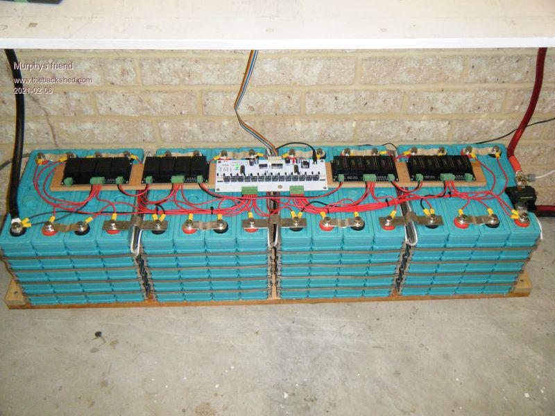

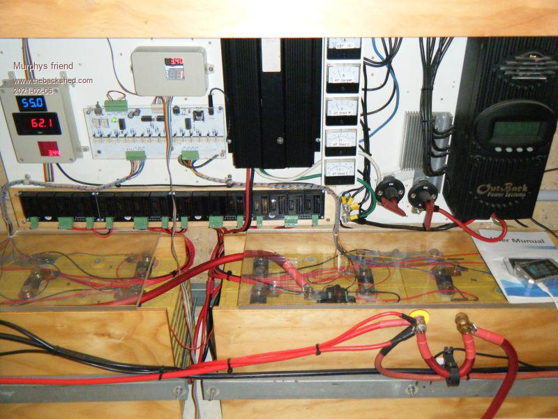

  rogerdw said
Just so I have a chance to understand more fully  ...  what length of time are we talking that it ran fine?
Something else I don't recall reading is exactly what sort of battery are you using.
And it's interesting to hear that you also had a 2KW GTI hooked up as well.
I see that the chainsaw incident happened while the inverter was running  ...  but Haxby asked a good question  ...  were all the other blow-ups since, at startup or while it was running?
OK, that incident was last year after the warpverter ran for about 2-3 months (can't  remember exactly).
Initial blowups due crystal & startup problems. Never had it running reliably after chainsaw incident. I tested it since then with a bench power supply that easily powers a 100W floodlight from a good inverter.
Re the battery: 16 x 200Ah Winston LYP cells (now about 50% capacity). See picture below
Re the oscilloscope buying, budget not ready for that just now as I recently upgraded my battery set up to include these 16 x 200Ah LiFePO battery cells:
