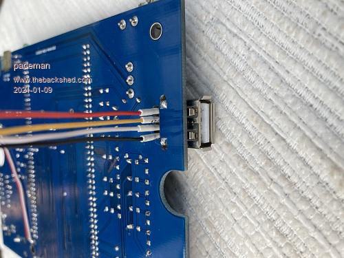

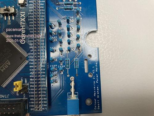

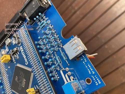

In the spirit of my now redundant effort with the PS2 connector made further back in this thread, I have now produced a nice neat USB connector! Check this out.
This is on the standard Silicon Chip CMM2 board. It nicely fits into a slot filed into the standard case.
Holes drilled for the PCB socket in a track-free side area (right hand side, close to the front). Make sure you mark the position on the board carefully before drilling.
Connections made to socket pins. Not much room there but it helps that switched 5v is close-by (main switch) and base plane is ground. I scraped a little resist off to make the ground connection and a solid soldered base for the socket cover pins. 5v and ground connections only end up about 2cms long - the leads for the D+/D- control signals go to the soldered connections of pins 31 and 33 of the 44 pin socket. I used solid insulated hook-up wire which lays pretty flat on the board.

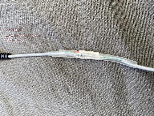

The last one is the mouse lead (optical mouse, 10yr old) modded in-line with 4K7 pullups. I put the pullups in-line so that the control pins (31 and 33) are standard CMM2 when the USB plug is removed. They can then be used for other I/O.
I confess I don't consider this last part terribly "neat" - even so it took up about 80% of the total modding time! It would have been easier if I'd had a bare-bones plug but I had to use the original after cutting the lead.
