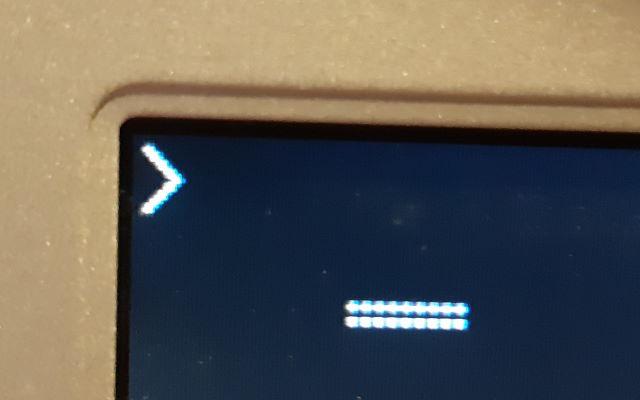

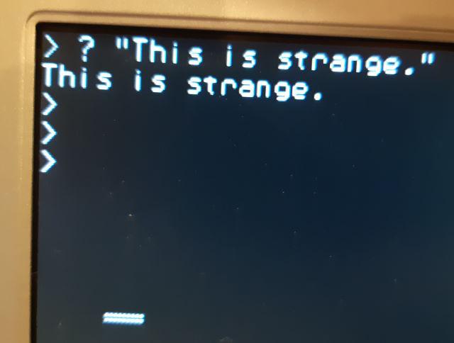

New weird thing.
If I exit the editor using F1, the underscore cursor is expanded and the system is in some strange video state. The video 'twitches' with the next command, the screen clears, then settles down.
Try 'F1' to exit editor, then immediately 'ls[Enter]' to list files.

  Quote  New weird thing.
OPTIONS?
Edited 2020-12-02 08:50 by matherp
vegipete
Joined: 29/01/2013
Posts: 1193
Posted: 01:28am 02 Dec 2020
OPTIONS?
The only option I've set is keyboard repeat.
> option list
CURRENT VGA mode 800x600 RGB332
CURRENT DISPLAY 50,100
OPTION USBKEYBOARD US
OPTION KEYBOARD REPEAT 400,30
Everything else is whatever happens from flashing firmware.
Same effect if I enter "option reset"
Anything mode command related fixes the problem. Some other commands do too. Generating a syntax error fixes it also.
The underscore cursor looks spread apart. The pixels are spaced one pixel apart. The character cell size appears double, although typed text is normal. Also, the CMM2 freezes once I'm 28 or 29 lines down the screen. The cursor disappears off the bottom at line 25 although the prompt character ">" is only half way down.
The individual cursor pixels are much more distinct than these photos show. The phote has blurred them together a bit.
