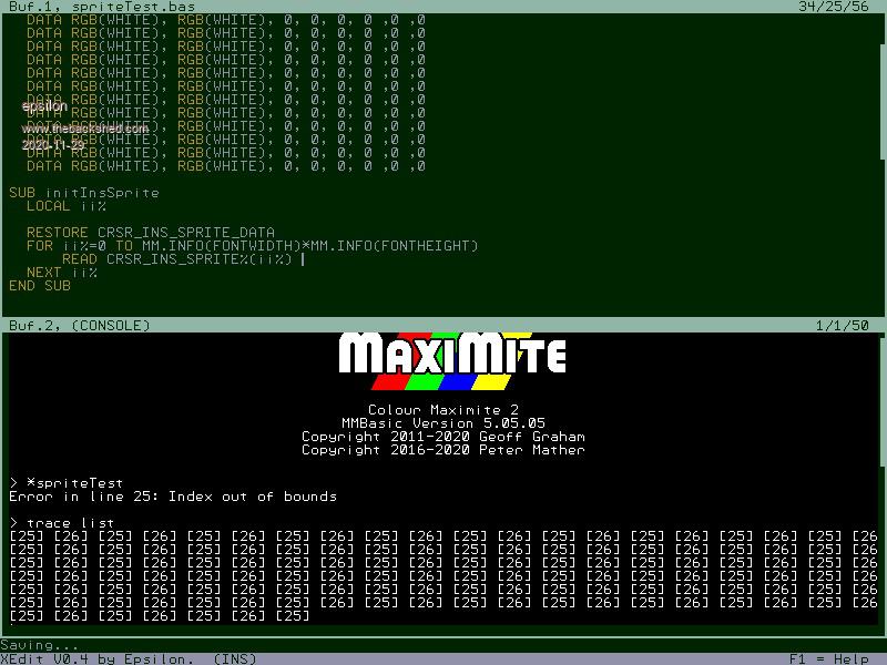

I uploaded XEdit 0.4. Here are the changes since 0.3:
- Added visual position-in-buffer indicator on right window border.
- Improved search speed.
- Fixed out of memory error when opening help screen in certain configurations, reported by thwill.
- Fixed weird 'animation' on last line when (un)indenting a selection that spans more than 1 screen. Also made indenting much faster.
- Dynamically sized keyword array (KEYWORD_LIST_DATA) using end sentinel as suggested by Jiri.
- Fixed bug: Search always started from the beginning of the line instead of from cursor.
- Added serial compatibility mode, enabled through flag SERIAL_INPUT_COMPAT_MODE. Note that enabling this mode affects certain keybindings. In particular, selection mode is toggled using the Esc key.
- Moved find-next keybinding to Ctrl-N. Added find-previous function bound to Alt-N.
- Added reverse-find keybinding, Alt-F.
- F6 shows console screen as it was when launching xedit in current buffer. This allows you to see your previous program output, trace list etc. from xedit. See screenshot below.
- F11 exits XEdit and runs program currently in buffer.

- Max. 14000 lines across all buffers (including clipboard and undo buffer).
- Max. 2 windows
- Max. 2 buffers
- Text entered on find prompt can't include double quotes or commas. Find selection can includes double quotes and commas however.
- Edit and Clipboard operations are not supported on buffer in show console mode.
- No undo for replace operations.
- Tested on FW version 5.0505 only.

Hi all,
XEdit V0.5 is now on GitHub (also attached):
https://github.com/epsilon537/xedit_cmm2
See changelog below for details. It includes improved horizontal scrolling. Jiri and vegipete's input (thanks guys!) gave me enough incentive to actually go after it. It turned out to be fairly straightforward. Initially I was trying to make the row oriented rendering faster and more flexible so it could handle single character rows, and that just didn't work (well, it did, but it was slow). All I had to do was create a column oriented rendering routine. Calling TEXT "LTV" once for the entire column of text, instead of for each row made all the difference. In hindsight everything is obvious.
There's always more to do, but I'm pretty happy with where XEdit is right now, so I'm going to move it to the back-burner for a while. I'm itching to start other projects. I'm still on the hook for bug fixes of course.
Cheers,
Ruben/Epsilon.
