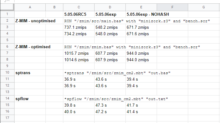

For what it's worth here are the results of my benchmarking the latest experimental firmware:
I guess that as long as we have OPTION NOHASH then I will only grumble quietly in the background.
Peter are you / can you optimise for the case when a Sub/Function has declared no Local variables and thus you don't need to cleanup the variable table ? - or would that also require the Sub/Function to also have no parameters ?
BUG! More worryingly running "spflow" with the experimental firmware WITHOUT using of NOHASH reproducably reports a spurious "Local variable already declared" error that despite a concerted effort I have been unable to reproduce in a simple example.

Posted: 10:29am 22 Oct 2020
  "PeteCotton" said  ...
All valid, but you'll still permit me to grumble given the 5-10% performance hit this imposes on my code because the "rules" have changed.
I'm not certain comparisons with programming in Assembler hold up since if "weird sh*t" happens in Assembler then it is in general the fault of the developer and under their control. Whereas with the MMBasic interpreter the "weird sh*t" can be really "weird" and out of our control.
From what I've learnt and the mental model I've built the "problem" lies with MMBasic not having a traditional stack based model. It looks to me like it may just be maintaining a record of the current subroutine depth and flagging any LOCAL variables with that depth, thus:
- variable lookup in a subroutine depth N is always slower because if it first finds a global variable it has to keep searching to see if there is a LOCAL variable of the same name flagged with N.
- leaving a subroutine requires all variables flagged with N to be removed from the table, previously that just required the interpreter to only check up to the number of variables that were declared, but in the experimental firmware it has to check all the slots in the hash-table.
It's possible this lack of stack is a relic of MMBasic's history on lower resource micro-controllers ... but then again the BBC Micro had a stack based model ... with its own peculiarities, e.g. creating a LOCAL variable also resulted in creation of a global variable of the same name.
Anyway this is all just intellectual speculation AND MAY BE WRONG, I don't actually expect any changes to be made.

Posted: 10:42am 22 Oct 2020
How do I run the benchmark in zmim?
Posts: 4410
Posted: 10:51am 22 Oct 2020
  matherp said  How do I run the benchmark in zmim?
For the optimised version:
RUN "/zmim/zmim.bas"
Select "minizork.z3"
Answer "N" at the prompt to write a script
At the >> prompt type *replay
Select "bench.scr"
For the unoptimised version, the same except:
RUN "/zmim/src/main.bas"
Note that the timing will not always be exactly the same, I think this is due to a random element in the interaction with the Troll that happens just before the Quit.
Thanks for spending your time on this,
