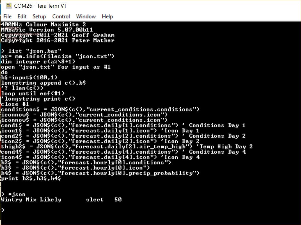

Posted: 09:48am 30 Jan 2021
Thanks for that - please could you also post some sample json function calls

Posted: 10:17am 30 Jan 2021
Sorry but could you also post a small simple json string and some relevant json$ function calls

Posted: 11:23am 30 Jan 2021
OK
I've got the json$ function working nicely on the CMM2 and can parse your large json string so you have no excuse now not to buy one
Seriously though, the limitations are that the CMM2 will never have an in-built networking capability so you always be reliant on an external ESP (NB the Deluxe version currently offered by Piotr has a header to mount an ESP-01 inside the box)
