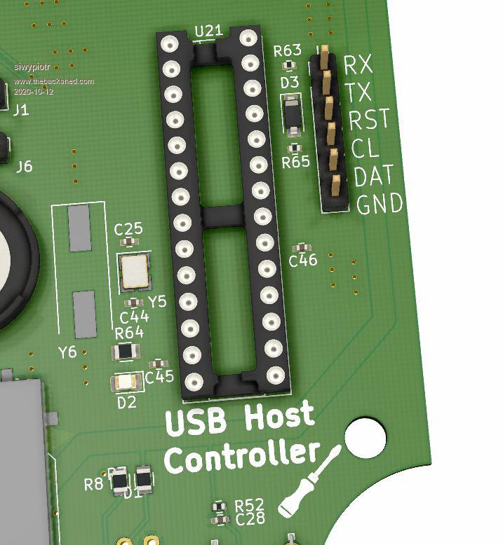

Looks like Im done
Posted: 02:36pm 12 Oct 2020
Suggest you connect to I2C2 (pins 27 and 28 on the 40-pin header) - I'll make this the default in the S/W

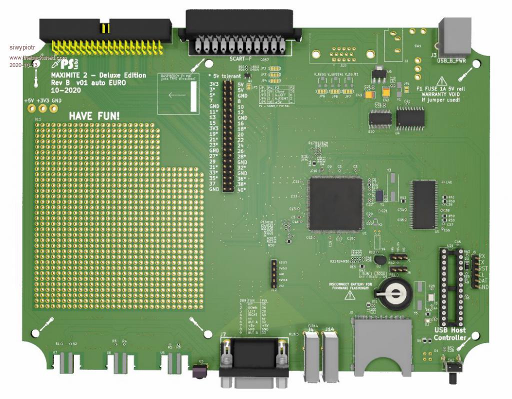

Revision B of my Maximite Delux is done:

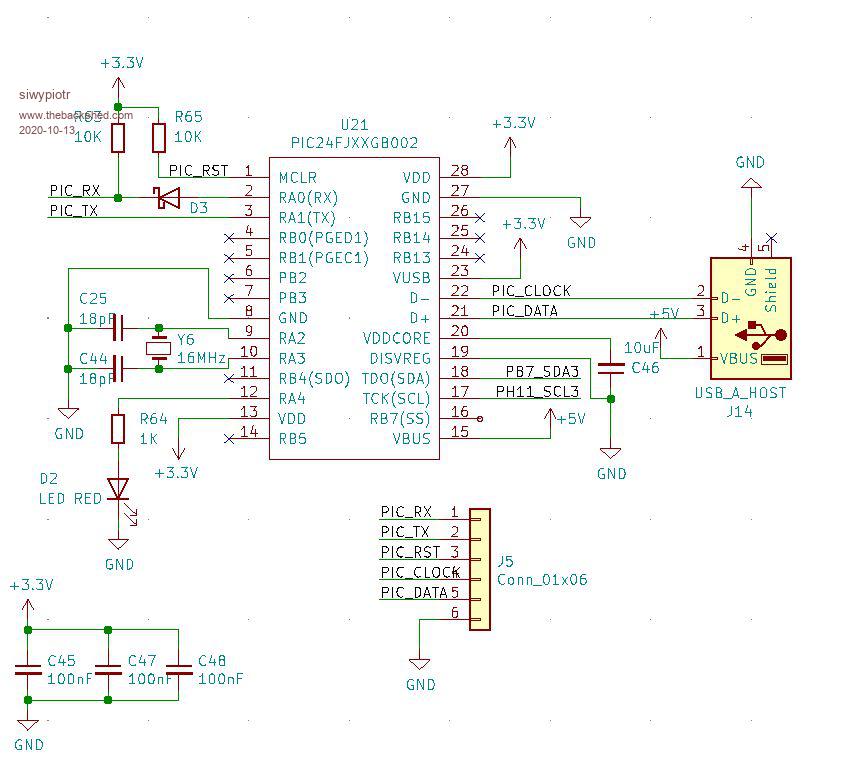

Here is schematic for the mouse controller from hobby electronic (just drop IC to the socket):
I will order PCBs + assembly tomorrow, please have a look if I did not missed anything.

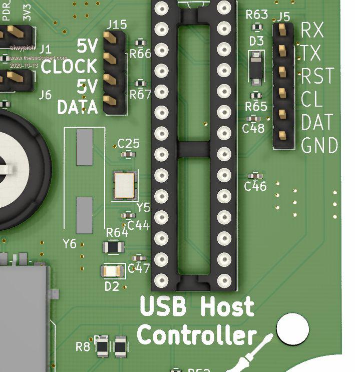

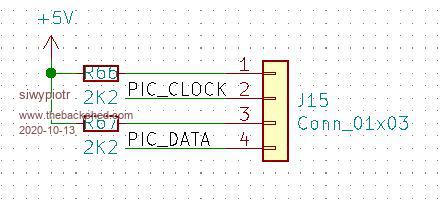

Could you add optional pull-up resistors on the PIC_CLOCK and PIC_DATA lines between U21 and J14? Pins 21 and 22 are 5V tolerant, so the pull-up can be to 5 volts.
This would allow a suitably programmed U21 to talk to PS/2 mice also. (Pulling these 2 lines high puts a dual mode mouse into PS/2 mode.)

  siwypiotr said  Revision B of my Maximite Delux is done:

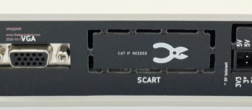

Looks good.  I've seen some variations with a SCART socket, some with VGA.  Is that an option?  Which are you intending to ship as standard?
I think I see an extra USB port on the front for the mouse.  Is the Joystick port a standard Atari D9 connection and pinout?

Posted: 07:11pm 12 Oct 2020
Yes there will be mouse support.
DB9 pinout is standard for Atari joystick or SEGA gamepad. Pinout vs GPIO is as follows:

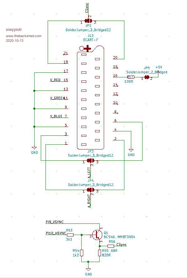

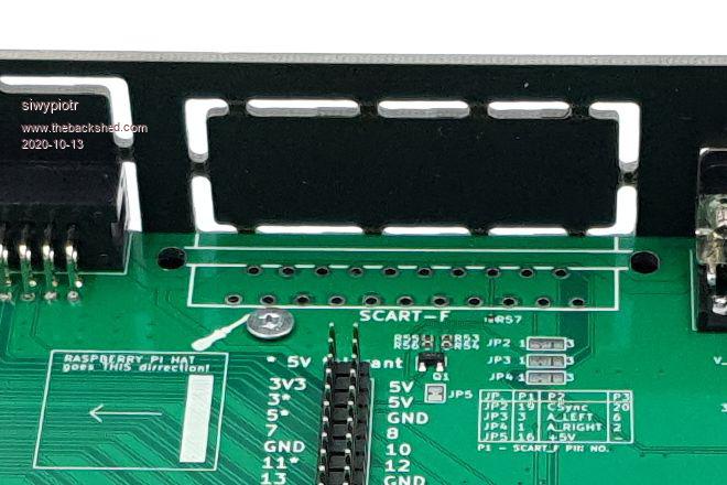

Currently there is VGA. SCART is something I work on, everything is populated and requires only adding SCART plug. back panel is prepared to be easily cut to have the place for SCART:
Unfortunately it does not work, there is image but no synchronization, maybe I failed somewhere on my schematic:
I need to work on it. The final goal is to have both VGA and SCART

  vegipete said  Could you add optional pull-up resistors on the PIC_CLOCK and PIC_DATA lines between U21 and J14? Pins 21 and 22 are 5V tolerant, so the pull-up can be to 5 volts.
Sure no problem I can add pullup + solder jumper. How much 1K or 10K ?
vegipete
Joined: 29/01/2013
Posts: 1193
Posted: 08:56pm 12 Oct 2020
2.2K seems to work well.
Holes for 4 header pins, similar to RUN/PROG, if possible, so that jumpers can be added or removed as required. (No need to populate the header pins though.)

  vegipete said  2.2K seems to work well.
Ok added:
